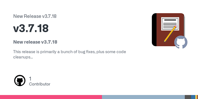

I just saw that Bart is preparing 3.7.18 for release on Github.
How can you tell?
What timing.
I need to start testing this one soon.
I saw fluidnc-releases listed in the repos. It showed v3.7.18.
That could have been luck, or just timing, or maybe things are slightly better.

I flashed and am running a 1:30 job right now, no issues so far. Going to update the DOC’s with this as the recommended after the cut finishes. Also update the file transfer section after I test that as well. I have been waiting for this one as well.
How did your test run go?
Can we get a build that supports the full V1E ESP32 flash as some kind of baseline starting with 3.7.18 ?
Test went without any issues.
This release already frees up a bit of extra memory.
Currently, there is no easy way to get a custom firmware in the web installer. To use the rest of the memory, you will need to compile and flash outside of the web installer.
