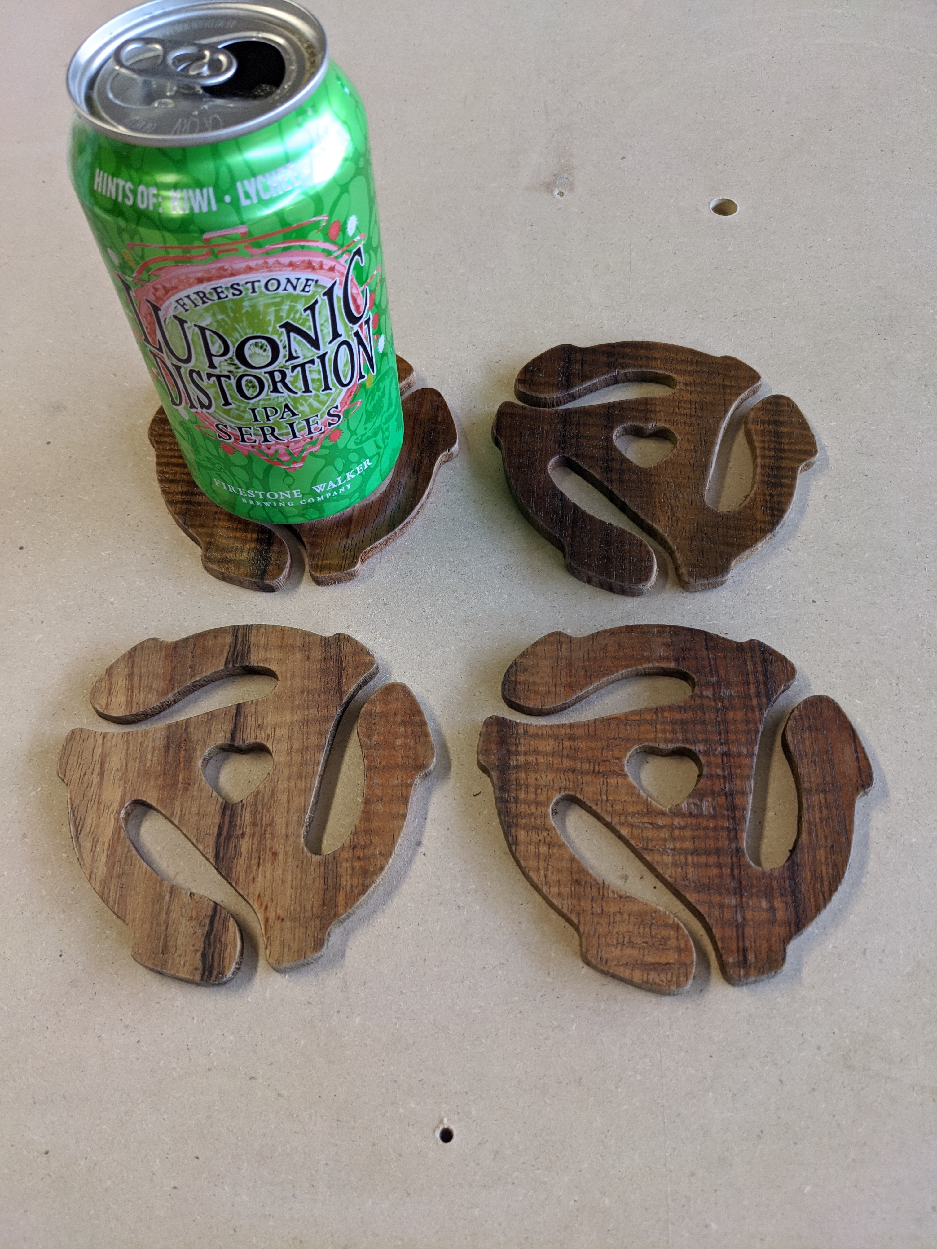

First try at coasters for a local record store
Here’s my first run of ~3/16" thick coasters made from koa. I’ve got a lot to learn and really need to employ finish passes to improve the cut quality. Pretty happy that the owner wants to sell these at his shop though.

Not sure if you did but it looks like you may have done your finishing passes at the same depth as your cutting passes? If so you can speed up the cutting a lot and clean up the edges a lot by doing a fast and deep finishing pass at full depth. As you’re only taking a tiny amount the machine’s quite happy going the full depth of your cutting edge on the bits.
I pretty much always do this on my cuts and it adds only a small bit of time as it’s just a single pass on all the edges and you can be fairly aggressive on your feedrates.
Good luck, the coasters look really nice.
I actually did not do any finish passes, this was only roughing passes. So I bet if I do a finish pass and use your advice theyll come out great.

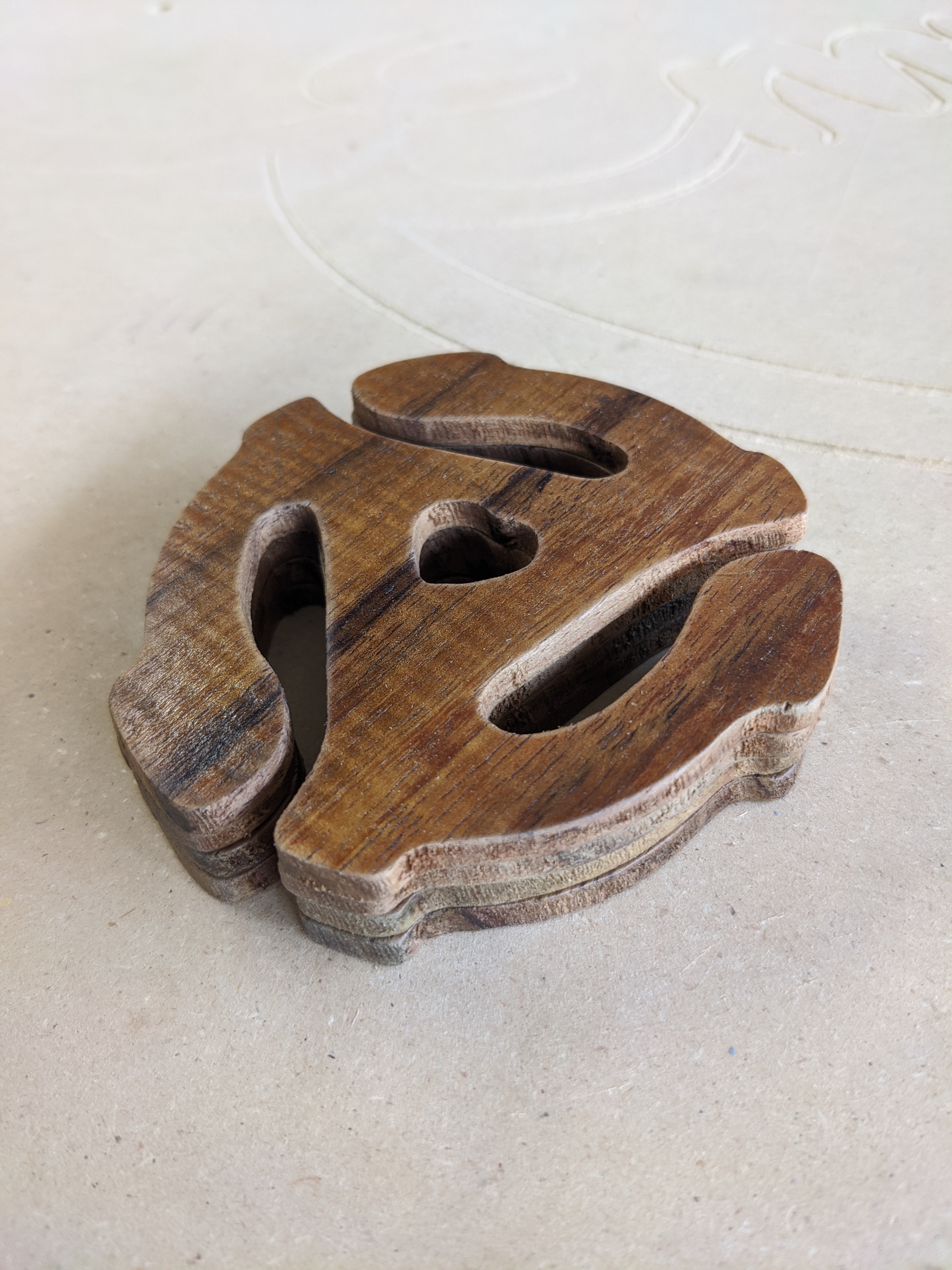

Started a new project, will take about 2hrs for this piece. Can already tell the massive difference in cut wall quality with using a finish pass, I just lightly sanded the face to clean up the top.
