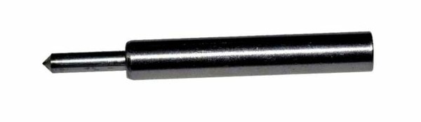

Made an edge lit sign with my wife’s photography logo. Used a diamond drag bit. Took 4 hrs to do the engraving but it was nice a quiet lol. Used a base from amazon for $5.

Dude that’s sick! Is it just a light engraving on the surface of some acrylic?
Yes Sir. its a 1/4" diamond drag bit i got off of ebay…
a little spindy for a single bit but man it was nice watching it run and being able to hear myself think. it takes a while because the line it engraves it so small. i had it set at .1mm for the bit thickness and a 10% stepover. i think i can safely pick up the speed a little but i errored on the side of caution and let it take its time. the base i used was cheap on amazon…

So when you say drag bit does that mean you don’t spin it at all? I assume so because you say it was quiet. The notion seems foreign to me though.
Correct. The router just holds it. It has a spring loaded diamond tip. it just “drags” along the surface of the acrylic and engraves it. technically you could do the same thing with a spinning bit much cheaper but with this its quiet and if there are any variations in your table surface the spring action in the tip makes up for it. i set up for a 1.5mm DOC and got a great finish.

Looks great! I’m curious what the difference in finish would be using a drag bit vs a spinny bit… I’m thinking the drag bit would come out nicer.
