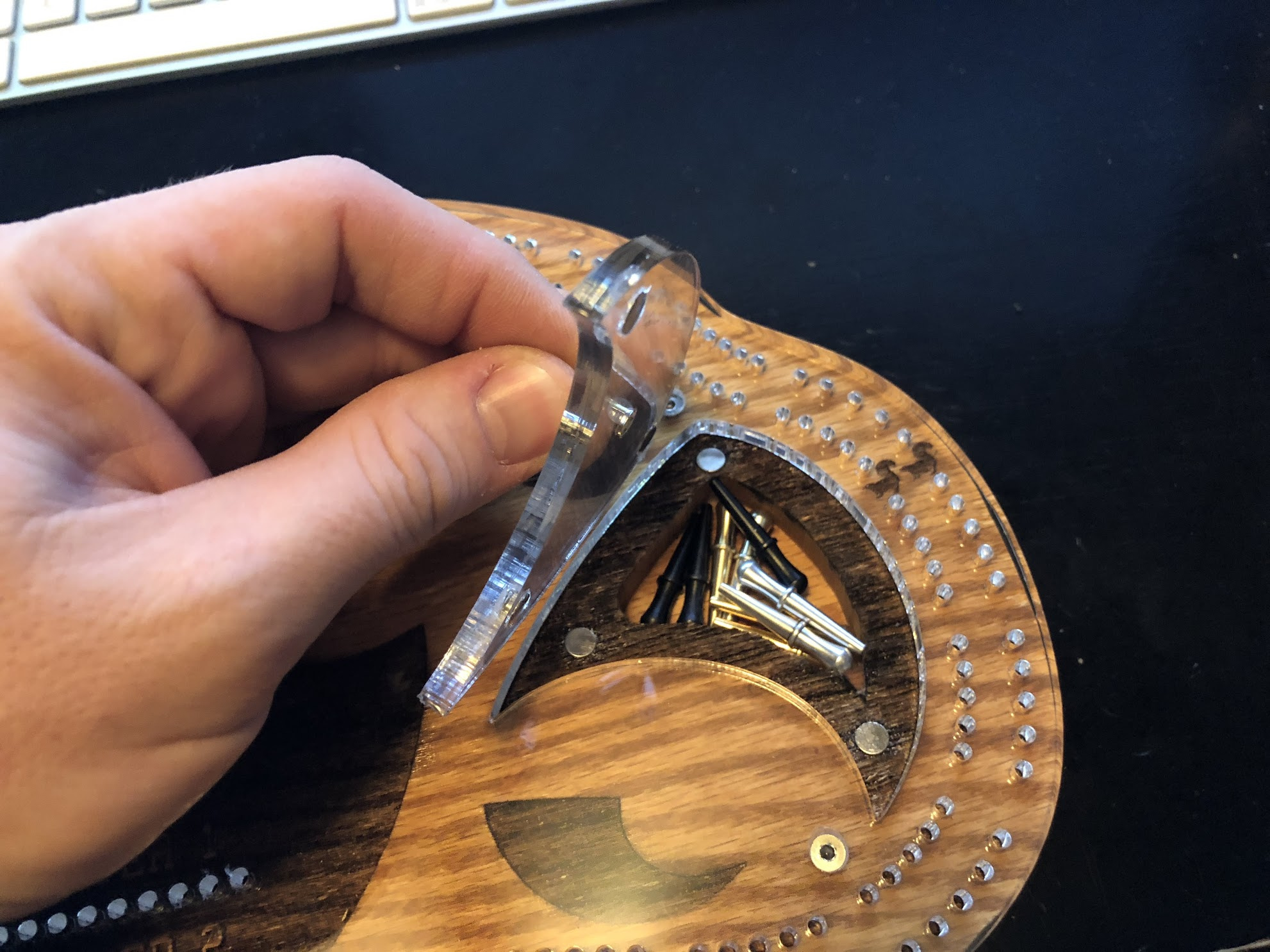

So the reason I built the low rider in the first place was for custom cribbage boards.
This one is for my rep (im the engineer). Hes a dumb husker fan haha.
First iteration at Vcarve and I figured out the vectors etc… Not that bad.
Also the first attempt at making the peg cover work. It worked right out of the gate.
Pegs wont slip out, easy to carve. Perfect.
Really really happy with how it turned out.

How does the peg holder work?

As far as the peg holder. I just engraved out a spot for a small strong magnet in the acrylic and epoxied it in.
Also cut out a hole in the wood for the same magnet.
There isnt enough clearance for thepegs to slide out the opening, so a player can just reach a finger in, pull the acrylic up and get the pegs.

I really do like the acrylic top to the board on the hawkeye one, but I just couldnt get the pegs to align right on the Nebraska one. Youd think you take a file, cut it on the cnc, same file, cut on laser would be spot on… it isnt haha
EDIT : also taking suggestions for how to add the skunks in there. Cant really engrave or laser them at this point… Be really hard to position them right… Not sure how to pull this one off.
Just a straight line would be enough. You could even do it by hand by clamping a straight edge along the material. I’d do it on the bottom of the plexi personally.
Maybe painting the inside of the holes a different color?
Straight line or painted holes may not be a bad idea… something simple.
although not sure painted holes would be very visible… I guess i could try to paint a thin line around the hole. maybe I could cut a circle red sticker to make a border
A small counter sink that you could paint?
yeah thats actually a really good idea for the countersink… i can do that during the cut itself in future times.

I think going forward, I am just going to add an engraved S to the skunk and SS to the double skunk line area. I can get that in to the existing toolpath with the other letter engraving.
Bigger problem now is finding a place to buy these metal slides… It seems like it would be easier to just use this tried and true method for peg holders.
But I cant find anywhere that just sells that metal piece.
Cutting the slot . It’s hard to get a mill thinner than 1/8th inch
they have those specifically for this compartment… If its not that feasible, I guess I need to devise another way. My way works great, but with epoxy is a little more time intensive than id like.
