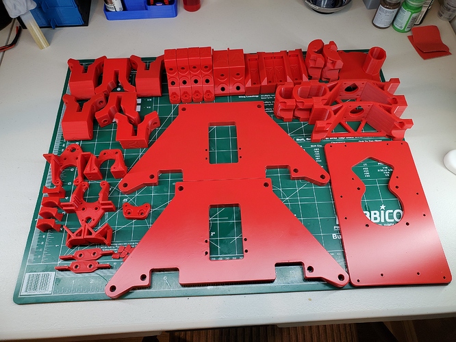

Hi all, this is my first post on here and I’m currently underway on my 4x8 lowrider2 build. I’m super excited and can’t wait to get cutting.
Here’s some pictures of what all I’ve gotten done so far. I still need to build a table for it and start wiring everything up. I’m definitely going to need some help with the wiring as I plan to add dual end stops to my build.

Hey i found this post while looking to make sure the lowrider can do a full 4’x8’ sheet and then noticed your parts, off topic but how did you get such a nice finish on the parts?
I’ve tried all 3 ports on the screen and none of them work. I also reversed the plug on the rambo board and that didn’t help either.
I printed really slow, 40mm per second. It doubled my print time to a total of 130 hours but it was well worth it. Perfect layers with zero stringing. I also tried a new PLA filament as well and I really like it.
