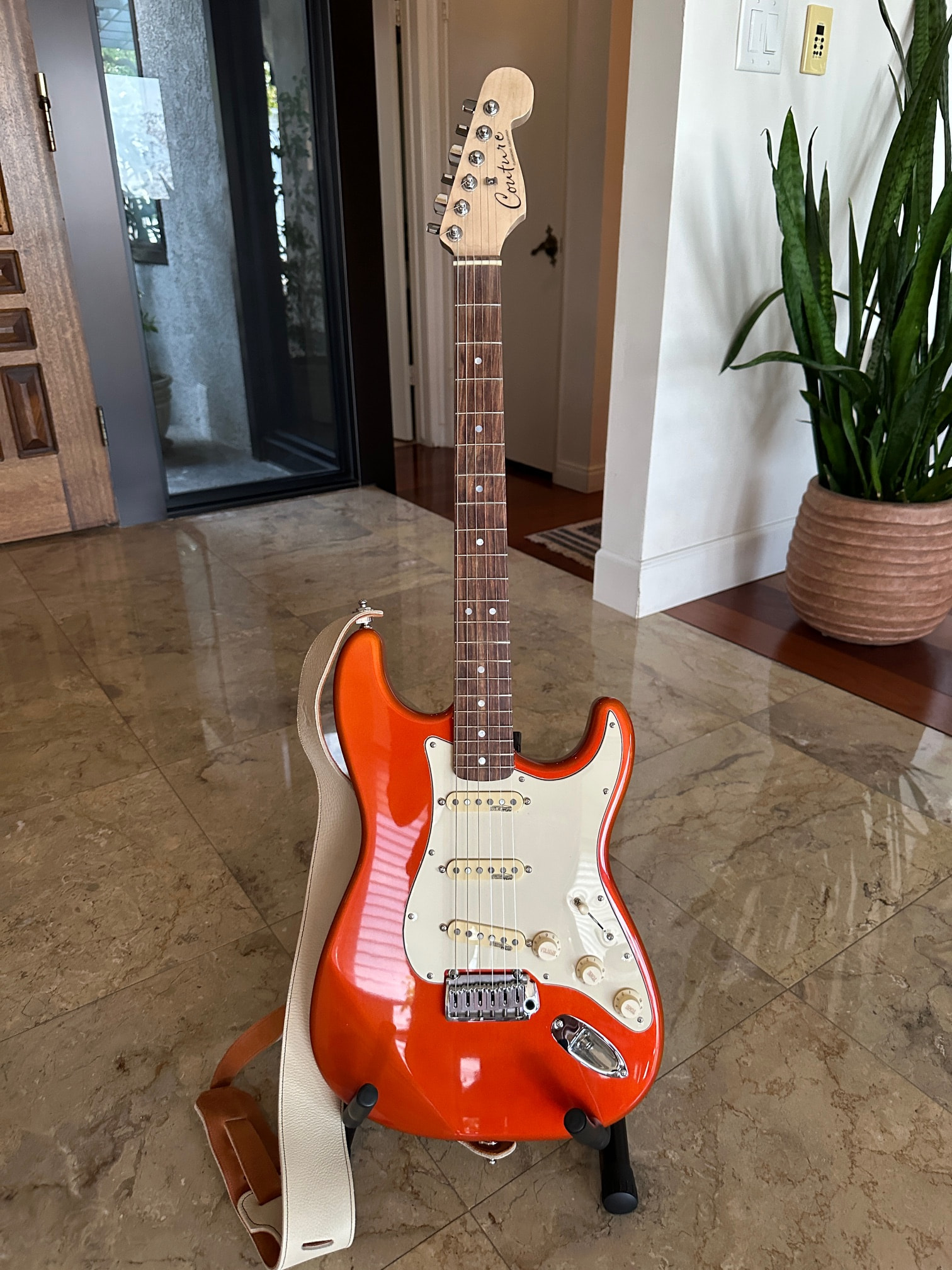

I recently completed another guitar build (I’ve made 2 others) but this is the first one I used my LR4 for the neck, body, cavities, pickguard, and fretboard and fret slots. The only jig I used was to deepen the fretboard fret slots. The neck was then hand profiled (I haven’t figured out 3D CNC yet) and the body tapers. The edge roundovers were with a router.
I happen to enjoy carving necks so I’m not in any particular hurry to figure out 3D CNC and the same goes for the tapers on the body.
The color is StewMac Candy Tangerine Orange - an old Fender color from the 60’s, I think.

Looks great! How did cutting the fret slots go? What sort of tool paths did you use?
Making several you obviously feel the LR4 is up to the task?
The original plans came from an Etsy vendor that sells PDFs of various guitars. Once I figured out how to convert PDFs to SVG of DFX and remove detail I didn’t need, and imported sections (i.e. top, bottom, neck, fretboard) into EstlCAM, all the detail I needed was there. I made a number of edits to the plans (using Inkscape, Librecad or EstlCAM) to fix, resize, modify or move (e.g. control and Jack cavities and neck pocket were not correct, or at least not ideal) and cutout mods for the GoToh bridge/trem I used. It took a few scaling iterations to get the fretboard to the exact length, width and spacing before it was ready for the LR4, but it came out perfectly. I tested the files with MDF blanks to confirm fret spacing (and many other aspects of the project) before cutting the actual body/neck and FB. Same for the pickguard.
I used a 15 degree - 1/8” V-bit (from a cheap Amazon set of V-bits) to cut the frets. I cut them to depth conservatively to serve more as guides for my fret saw and jig. Next time, I plan to be more aggressive with the LR4 cuts to eliminate the fret jig step. I also cut the fretboard to shape on the LR4 at the same time which meant I had to make a tapered spacer so the fret marks would be perpendicular to the fret cutting jig.
I spent a lot of time learning the various apps mentioned above and making iterations of the EstlCAM files just right, plus test cuts on the LR4 before I was happy with everything. It was worth the time investment because I now have working and validated CNC plans that I can use as the base for future projects.
100%. Once you have the .E12 plans and bits sorted out, it takes only a couple of hours at most to generate a body, neck, FB and pickguard.
I used steel pins and carefully set holes in the top and bottom of the body to be able to cut the outline and some cavities on one side, flip it over and cut the other side’s cavities in perfect alignment.
The neck was CNC’d as an outlined blank but I also cut the headstock recessed flat tuners portion on the CNC, but hand filed the fillet. The back was hand shaped and profiled with Dragon rasps.
So did you radius the fretboard after slotting?
Yes. And after gluing it to the neck with truss rod in place.
CNC the fret slots, top dot holes, nut slot, and FB profile, hand saw on the jig to deepen the fret slots, align and glue FB to the neck, sand radius, hand drill side dot holes.
I didn’t mention, but I also cut the heel-adjust truss rod slot on the LR4, but drilled the heel-access hole by hand.
Sorry, I missed your real question: I used an engraving tool path with the 15 degree 1/8” V-bit.
I use engraving tool paths and a 1/4” 60 degree V-bit to cut chamfers for the pickguard screw holes and to cut the PG outline.

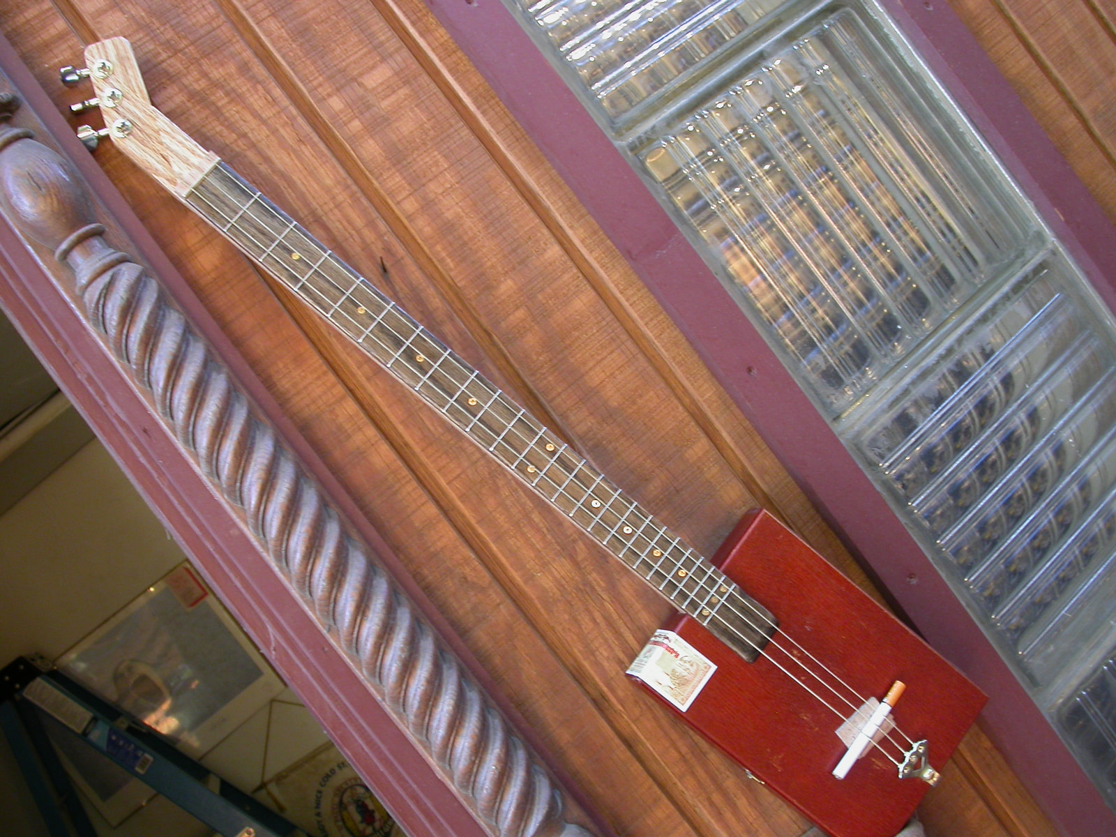

Love it! I’ve built a few cigar box guitars over the years and have been slowly collecting parts to build a full 6 string one of these days (no time and still haven’t decided on exactly what I want.)

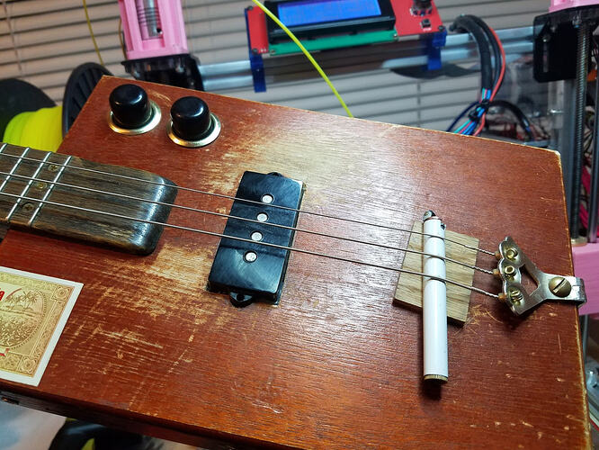

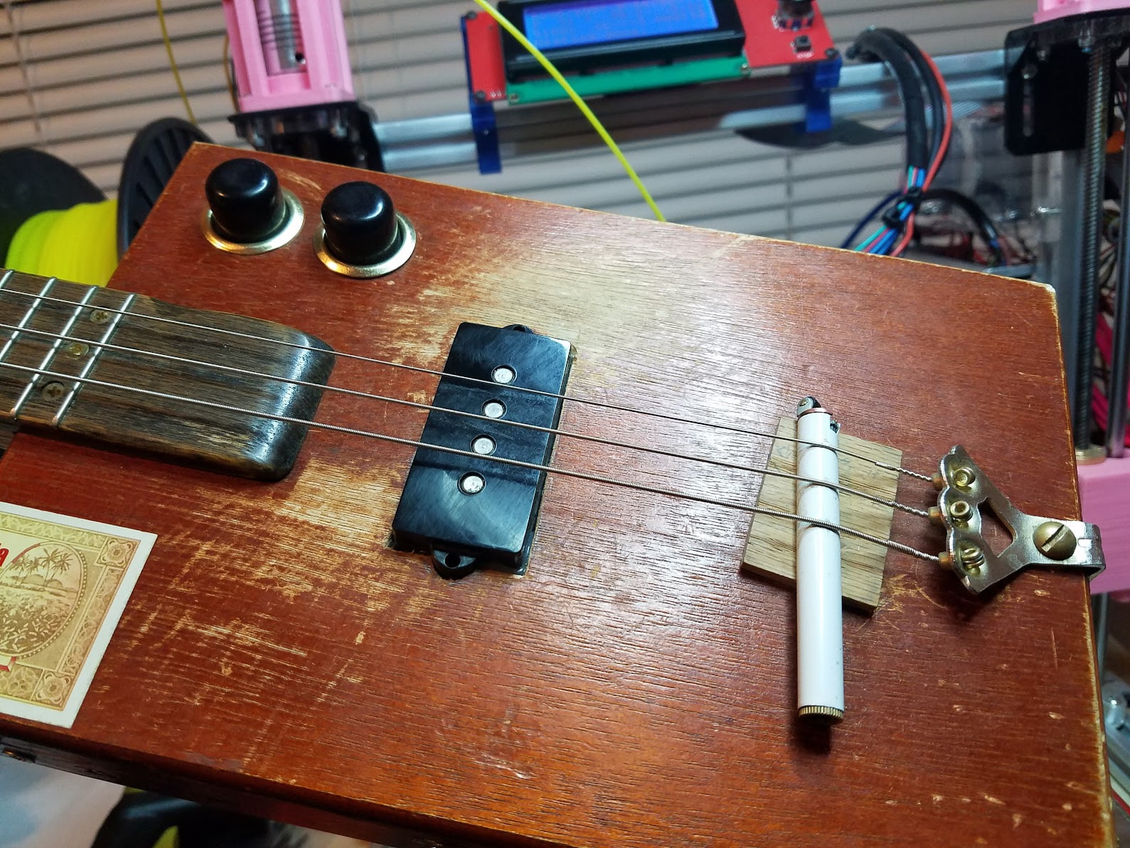

I built this one 16 years ago just before my daughter was born:
It’s enjoyed many a campfire and music festival and has gone through some changes over the years. The bridge is still the same cheap aliexpress lighter in the shape of a cigarette…but the top of it fell off and it stopped actually functioning years ago:
Even that was about 10 years ago…shortly after I added half a precision bass pickup to replace the original piezo. it’s looking a lot more worn now but I still love picking it up and messing around with it whenever I get the time.
