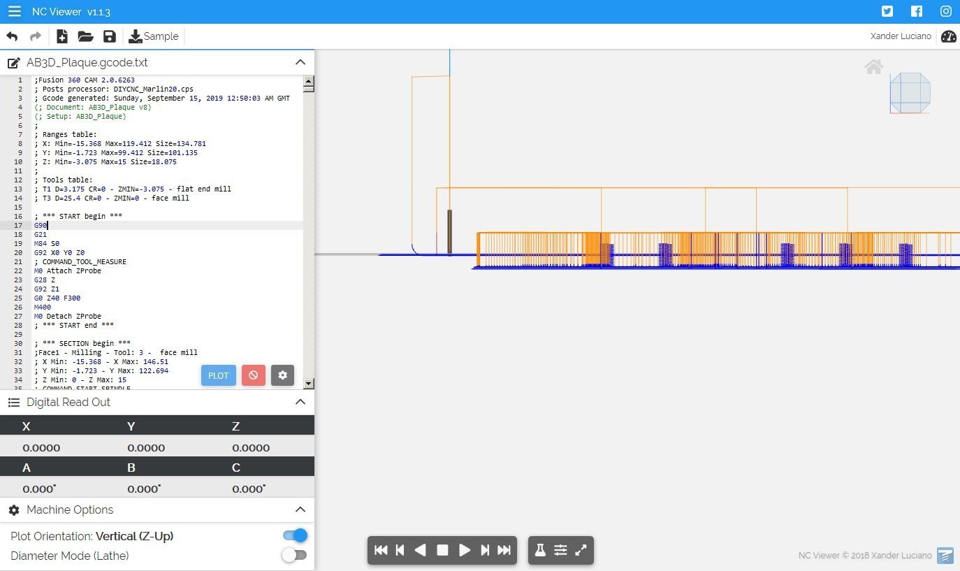

OK, I’m finally getting back to playing with Ryan’s baby! I just created my first set of gcode, using F360 and the latest version of Guffy’s post processor. The setup in F360 has 4 operations: Face, Outer Contour, Adaptive 2D Pocket, and 2D Contour to finish.
Being rather nervous about making chips for the first time with F360, I decided to load my gcode into ncviewer.com.
  1. The view looking up the Y-axis is attached and appears "tilted". Any ideas as to why?

post your gcode. NCviewer just reads what is in your gcode, so your CAM/model orientation might be off.

Here’s the Full G-code. I realize that the SPINDLE won’t stop (since I am indeed using a DW660) I just want the X, Y, & Z movements to stop, so I can stop the spindle, and do the tool change :-). I’m also hoping that the text on the M0 lines actually shows on the display of the machine.

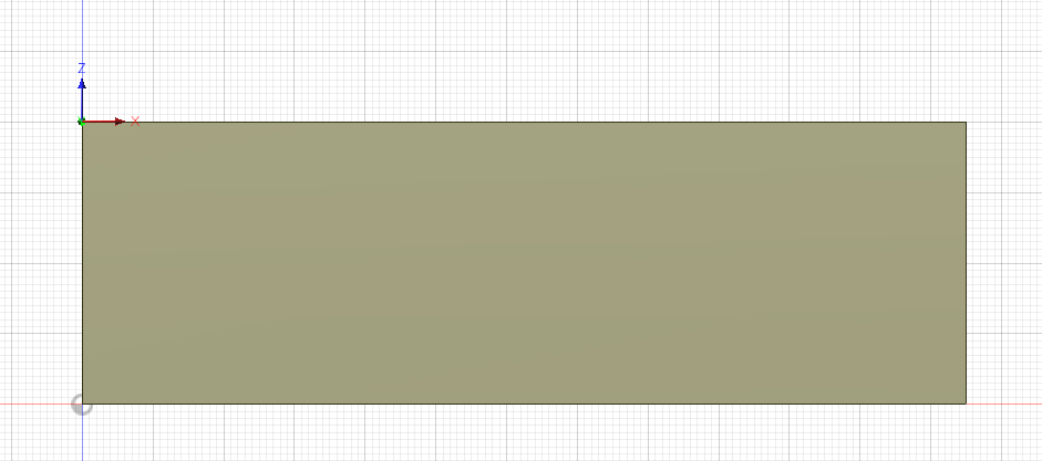

you will need to check your cam and cad model and make sure it’s actually flat on the modeling plane. It’s most likely that your model is tilted somehow, as there are a lot of z moves for most of the flat profile cuts
Looks perfectly flat to me! See attached.

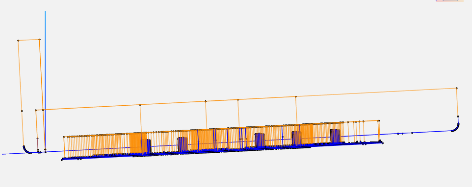

Your gcode is fine.
I loaded it in ncviewer and if you turn on the virtual DRO it is applying a rotation in the B axis. I think the ncviewer does not understand semicolon for comments, so it is interpreting ‘AB3D’ (somehow) as movement to B3, or 3 degree rotation in B.
If I use parentheses around those two lines, everything lies flat.
I did not find an option to understand semicolon as parentheses. Worst case you could manually strip them out for preview with ncviewer.
Major prop @Jamie! Thanks! That one was tricky! I removed the AB3D lines and poof–looks good.
Just for fun, I also ran this through ESTLCam and it too showed the rotation, since it too put the filename into a comment!!! :-).
I should have noticed that ncviewer showed the B3 in BLUE not BLACK!!!
