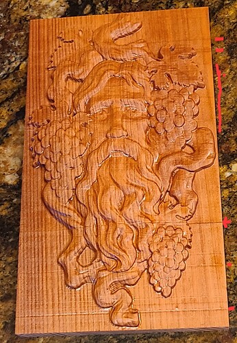

First carving with the new LR4
It can be argued of course that doing small pieces on the LR4 (42" x 72" capacity) doesn’t make too much sense.
However there is a ton that can be learned in preparation for doing a large piece.
For example, if the piece is going to take 12 hours, you are going to need to pause at some point, almost certainly. If you pause overnight, your motors are likely to dis-enable which will mean that the slightest touch of the gantry will shift your zero. Or if the z-axis is dis-enabled, the gantry may fall.
Or if you need to do a tool change, shifts can happen.
Anyway, all this stuff can be tested on a small piece without needing to use a large amount of material.
So, to that end, I tackled this guy:
(This piece is about 4.75" x 8". Wood is redwood. Maximum depth is 15 mm. Entire CAM done in EstlCAM)
As can easily be seen, there are some defects, nearly all of which are the result of a long pause (a few hours to overnight) and the resulting slight falling of the z-axis.
In addition, some detail was lost because of a slight “y shift” (~1mm?) due to an unlocked y-axis. And there are some tooling marks that also probably came from the y shift before the final finishing pass.
So, this little demo is offered as a learning exercise and to demonstrate that “it will cut” for any of you who may be “Forged in Fire” fans.

However, if your finishing passes are long, you’ll still need to handle extended pauses. In my piece, the finishing pass was several hours. Because of time availability, I had to pause overnight at least once, and for a few hours a couple of times. (I absolutely never run the machine unattended.)
Hopefully this gives you some insights into how this is done. I actually have another piece in progress as I write. It’s paused overnight at the tool change. We’ll see if the adjusted procedure does any better.

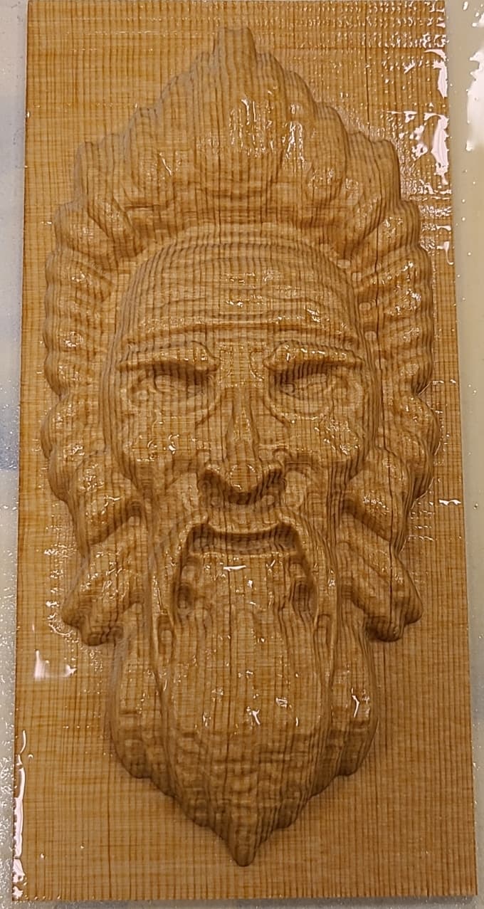

Further down in this thread, you can see a couple of brief videos of a similar piece under construction. It’s going to be about 4 hours, but it had a19 hour pause overnight.
I have to say, watching this LR4 can be hypnotic… this piece is a different design but similar size. It will be finished shortly after about 4 hours total with a 19 hour pause between roughing and finishing.
https://youtube.com/shorts/X-23qqjyqcE?si=7Zpkv4rn74e_0f75
Polyurethane is not dry yet. Wood is clear vertical grain fir.
