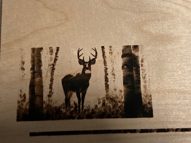

First attempts at image etching
The lowrider 4 slining a 3.5 watt laser module. More adjustment is needed, but that is a light burn thing; the light needs to be darker and the dark lighter. I have an svg version of this image. i imagine that i need to split the colors to different layers and then set power levels by layer.

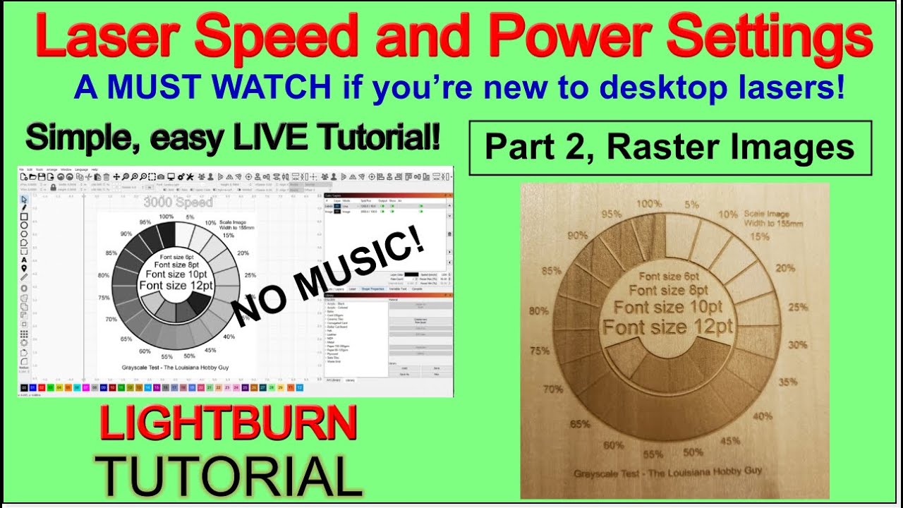

There’s a youtube video out there describing how to find the dynamic range of your laser module. Once you know it, you can set the min/max in lightburn. I can’t find the one I watched, but searched and found this one by The Louisiana Hobby Guy. It might help.
