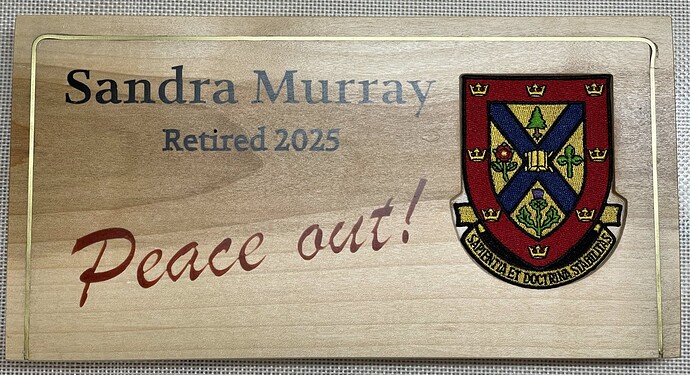

First attempt at brass inlay
My first attempt at a brass inlay was mostly successful, but I need a better strategy for bending the wire into tight radii (4mm radius in this project). I would love to hear any strategies other people have found that work!
Things I learned:
  • A 1/16" bit will leave a groove that friction-fits 16 gauge brass square wire. E.g. Amazon.ca
  • It’s easy to cajole the wire into the straight portion of the grooves.
  • Straight pounding in the corners to justmakeitfit… doesn’t work. In a metal vs wood fight, the metal will win. :slight_smile:
  • Sanding brass worked fine for me. However using a flattening bit on the CNC will launch brass fragments at high velocity.
Close-up of the ornery corner:
Build details:
  • Groove, lettering inlays and recess for the crest cut on an LR2.
  • 1/4" downcut for flat regions, 60-degree V bit for the two larger letter cuts, 20-degree V bit for the smaller “Retired 2025” text. 1/16" downcut for the brass inlay grooves.
  • Generic epoxy fill for the letters, after spray-coating clear varnish to prevent bleeding.
  • Finished with Osmo Polyx, 2 coats wiped on.
Just a thought: what if you 3d-printed a mold, based on the carved shaped. Then you could hammer and sand the brass into the mold, without risking tearing/ruining the wood?
what if you 3d-printed a mold, based on the carved shape?
Ooh, I like that idea: thanks!
It could be a 2-part mold too: have the inner radius part fixed down, lay the wire over it and then come in with a matching external radius part; have clamp support points so a clamp can be used tighten them up. Hmmm… :slight_smile:

When I do the spray, I focus on just getting good coverage in the carved regions. I don’t deliberately spray the uncarved flat parts of the board, but I used the spray-can varnish so there is definitely overspray for several inches around the lettering!
In terms of later finishing though, that overspray gets taken off along the way. I pour the epoxy proud of the surface, and when I remove that excess epoxy with a surfacing bit and sanding, it also removes the top layer of the flat wood, which gets rid of the sealant overspray.
(There is a risk there though: if I’m too aggressive with the material removal, it also takes away some of the lettering; there’s a bit of that problem in this project where some lines in the “out!” were almost completely removed.)
