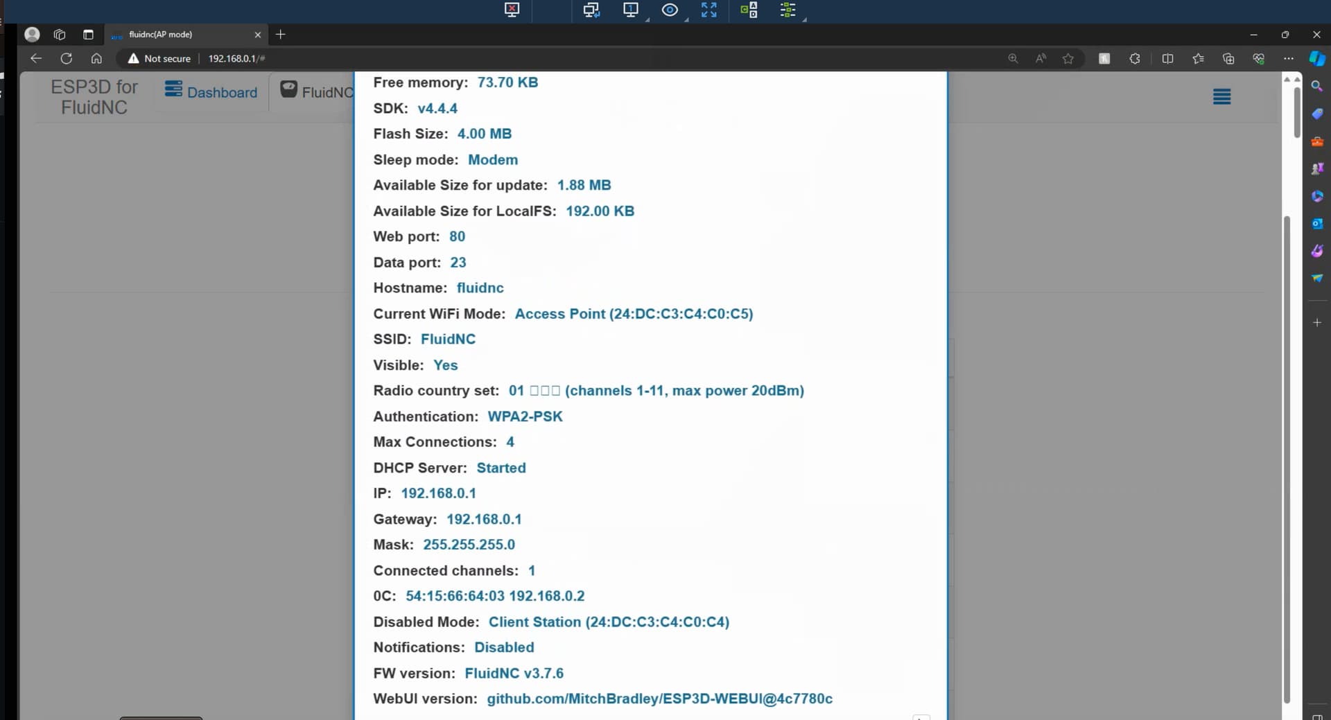

Then I decided to take the ESP32 out and plug directly into my Windows computer (UBS cable). Found I had to USB load drivers. Ran the web installer and it worked! Finally. Took the ESP32 and reinserted it in my Jackpot board. Bootup and found macro and config gone. Uploaded backup copies and reboot. Everything works. I clicked on the upper hand corner of the webpage to see the Fluid NC version: 3.7.6. Hmmm… Reloaded the webpage thinking it was out of date. Still 3.7.6 Fluidnc. looking around I found FW parameter confirming (see attach pic). The web installer stated files loaded. Maybe I need to erase the drive first? Going to try that tomorrow night.

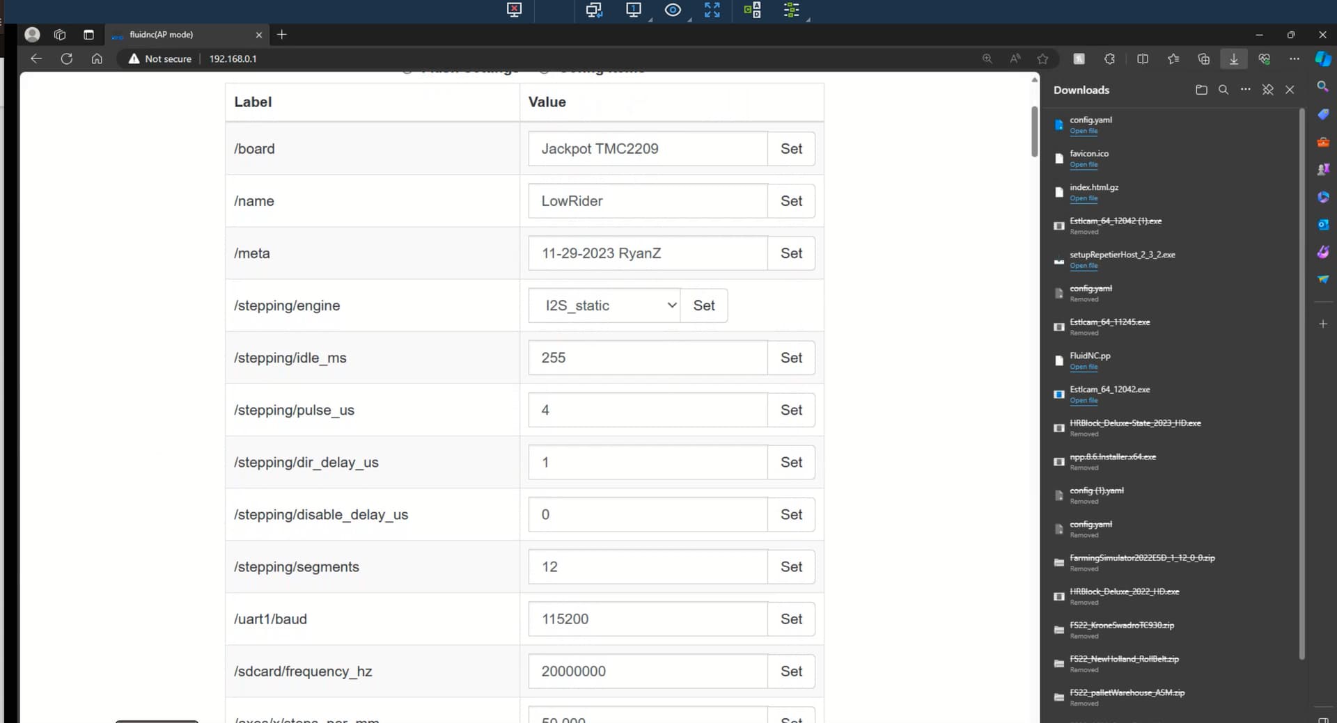

What does it say in the config page? That info page is kinda wonky we are in the process of updating it. Right now.
Looks like your original upload when the board was shipped to me (8/23). Note I try loading the most up to date version - 3.7.13 so maybe it has an issue. Thanks for the feedback.
