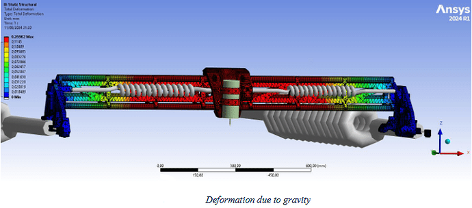

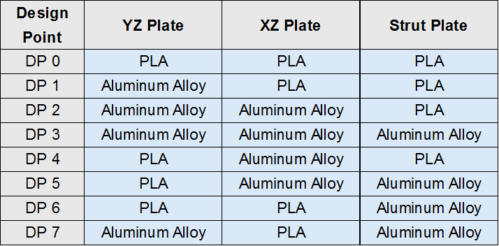

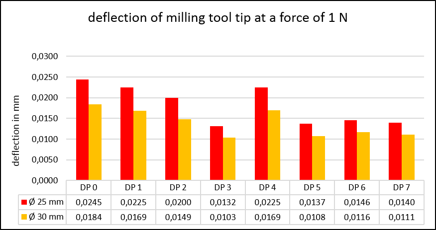

I would like to share some results of a finite element analysis of the LR3. The analysis was carried out with ANSYS and a 4"x8" build was modeled. The focus was to examine the stiffeness and how to improve it. For example to compare printed YZ plates and aluminium YZ plates. The geometry of both plates are the same, just the material was modified. The router is in X in the middle and in Y at the end, and in Z at the top (least rigid position). The deflection is measured at the tip of the milling tool. The raildiameters were modeled with 25 mm and 30 mm, the same direction like the LR4 seems to go :slightly_smiling_face:.

Edit: Since the strut stiffness appears to be the single greatest improvement you can make (greater impact than condiut diameter), I would recommend going to aluminium

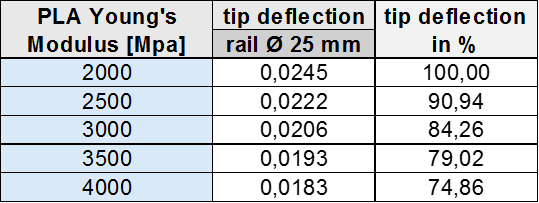

To examine the effect of different printing materials, the stiffnesses of all printed parts were varied between 2000 and 4000 MPa. The stiffness distribution is modeled isotropic. Note that in real parts there are different infill volumes and infill geometries, so that the stiffness of the part is less than the stiffness of the printing material and the part stiffness is orthotropic or at least transverse isotropic. But these effects were neglected in this analysis. But it is sufficient to examine the impact on the machine deflection/stiffness.

The greatest displacement due to self-weight occurs in Z-direction with 0,236 mm, and interestingly in Y-direction with 0,122 mm. The Y-direction results from torsion of the beam.

Yes, the deflection results from bending and torsion of the beam. Greater raildaimeter helps mainly with bending and the strut plates helps with bending and torsion.
That’s shown here:
Maybe the name PLA is misleading, the important is the young’s modulus. E.g. if you can improve your printed parts stiffness from 2000 to 3000 MPa (so by 50%), your machine will be around 15% stiffer. IMO if the printed material is a lot harder to print, it’s properly not worth it → see next comment.
yes, I couldn’t consider every variation. But the takeaway of this datat is, if you improve the stiffness of the struts from printed to aluminium, so around a 20 times increase in strut stiffeness, you get the shown results. If you use plywood or something similar, you increase your strut stiffeness by around 3 times, and you get a lot less improvement and leave a lot of machine stiffness “on the table”. Since the strut stiffness appears to be the single greatest improvement you can make, I would recommend going to aluminium.

I used 6mm for the strut plates, since I didn’t change the geometry, that would have been to much variation for the first analysis. The first shot were already 159 single simulations. But I won’t dig deeper into the LR3 since LR4 is just around the corner…
aluminium instead of mdf makes the struts 4.5 times heavier, but 26 times stiffer. But I agree, 3 mm aluminium struts seems much more appropriate
