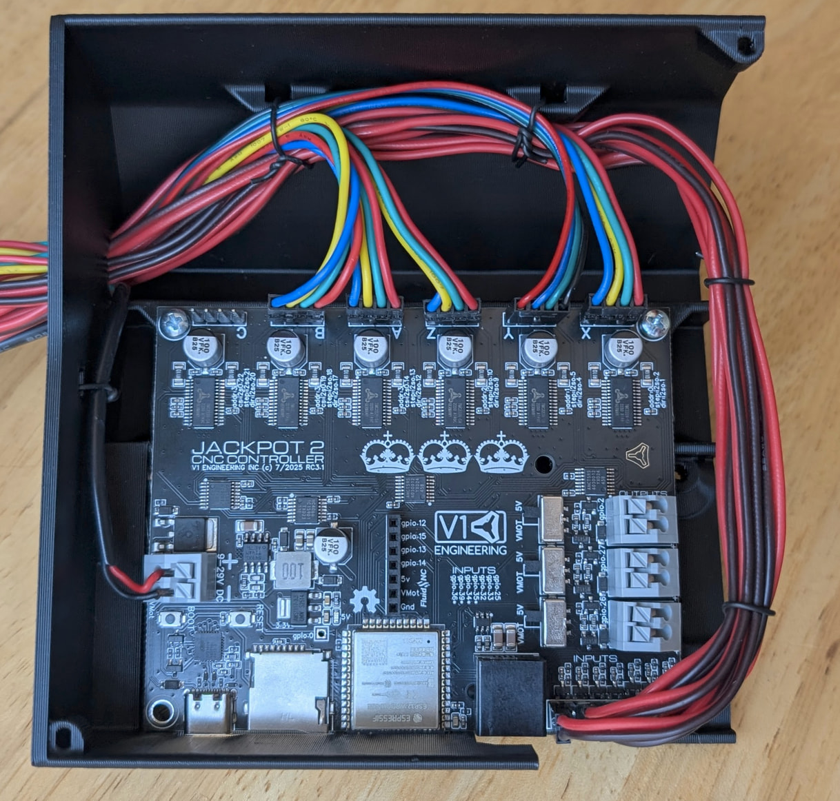

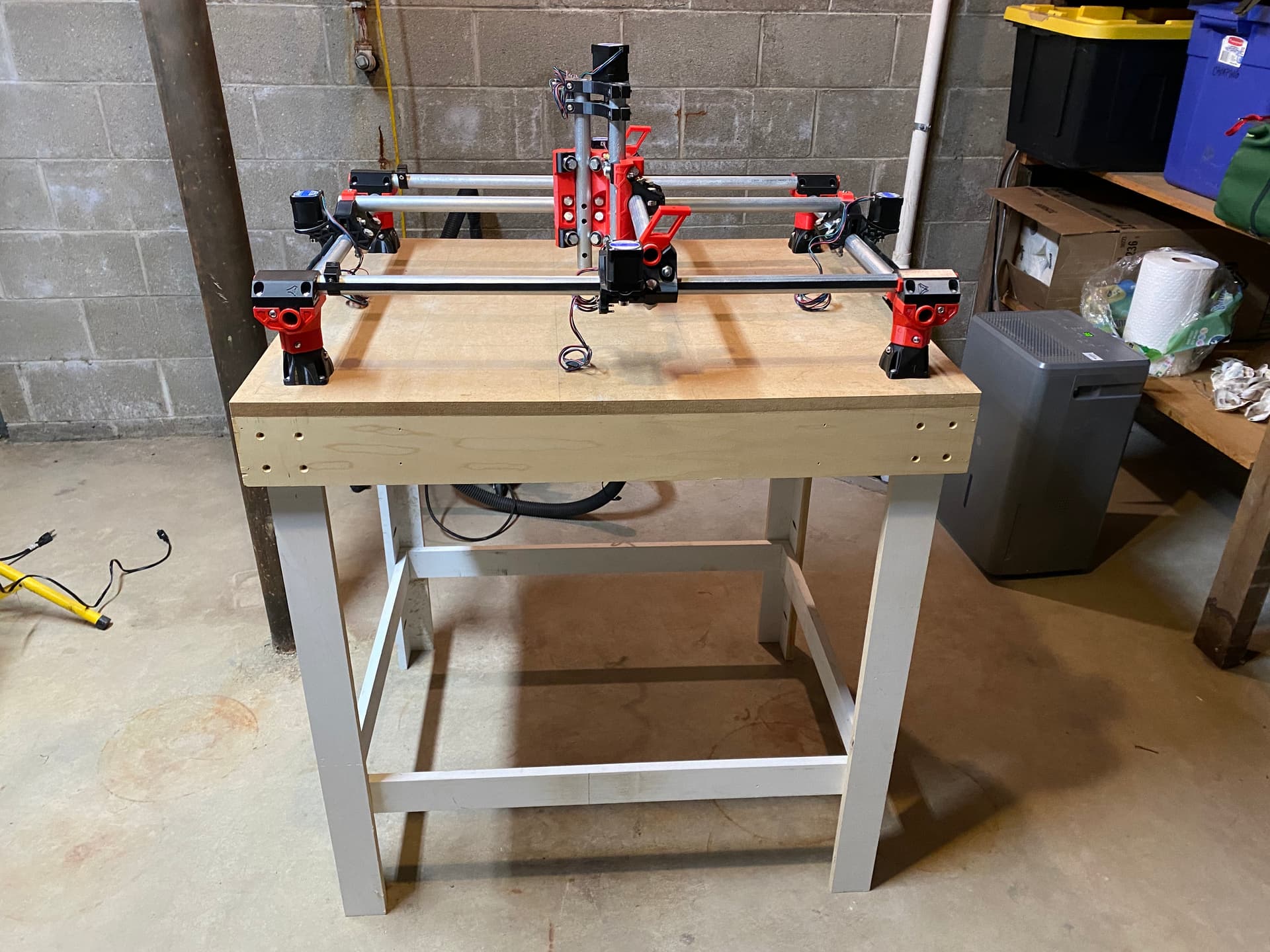

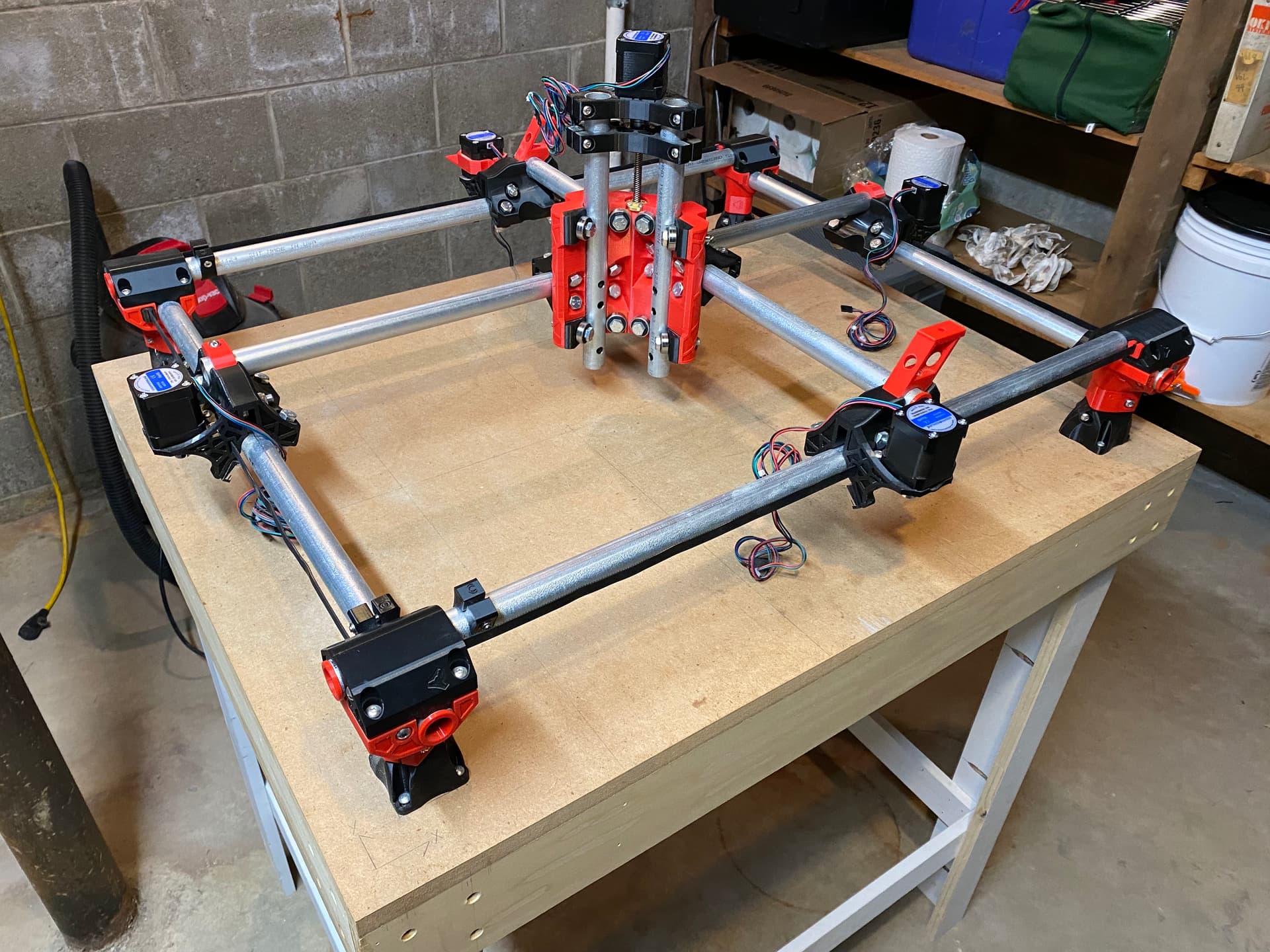

The finish line is in sight for completing my brand new MPCNC Primo. Foot spacing is about 83 X 65 cm. I have the DeWalt 660 router and clamps removed to rotate the lower portion of the router 90 degrees as Ryan states here.
I have a couple questions for the community.
  1. Is there a preferred location to mount the Jackpot3 controller and associated case?
  2. I have the V1 engineering wiring kit and will be using dual end stops. Can you share a document or tutorial for routing the wires and connecting them to the control board?
  3. Does anyone use an iPad to control the MPCNC? If so, do you like it? Any suggestions?

From observations of built machine photos the controller box is in one of the corner, usually on the back (opposite to home 0,0) because 2 of the motor wires are fished through the gantry rails to join the motor wires on the opposite side. My guess is it can be placed anywhere the wires reach. Just be mindful of the gantry motion.

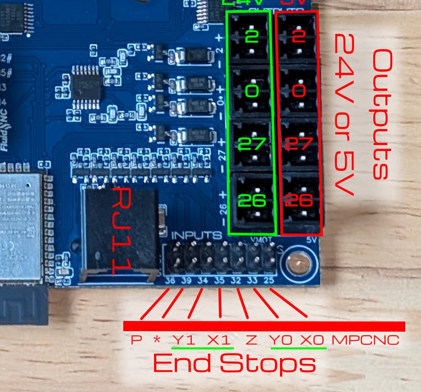

Having trouble finding endstops locally at decent prices I’ve dug on those a bit. Here you can find the pins for the endstops wiring. I don’t see a Z endstop from your photos so you should connect just X0 X1 Y0 Y1. I’m guessing according to how you connected your X and Y motors, so motor X0 will pair with endstop X0 and so on.

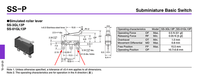

For the wires I had to ask AI. If not mistaken the jackpot3 requires NC so only 2 wires need to be connected (the endstop will shortcirtuit them internally and will open the circuit when triggered).
From the datasheet I gathered that pin 1 and 3 should be the ones to connect to the board. Anyway you can check for continuity using a multimeter.
I’m not sure if polarity matters but here’s a photo of the wiring done (red on top and black on bottom)
Hope this helps but don’t trust any of it until we get confirmation!
Welcome to the forum @leprehd !
Correct. There is no Z endstop on the Primo
Correct. It is very important that you get the correct endstop with the correct motor.
This is correct. We do it that way so if there is a wiring problem the machine will stop instead of trying to home and failing.
Correct. That is pretty much standard for endstops this style.
No polarity does not matter for the endstops.

Can the pins for the Z end stop be used for the Z probe?
There is another pin set up for the touch plate already. It is labeled P on the picture you posted originally
