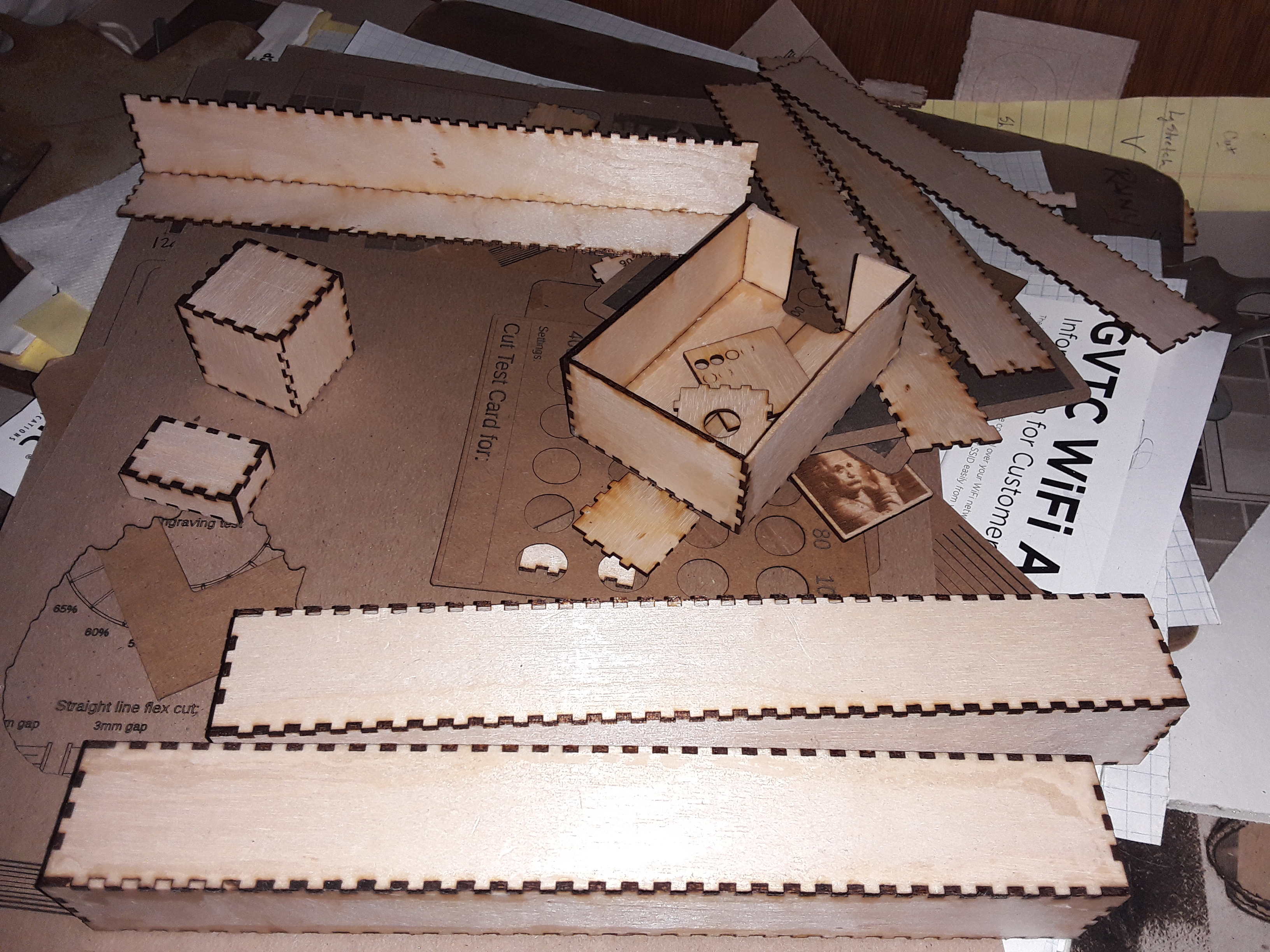

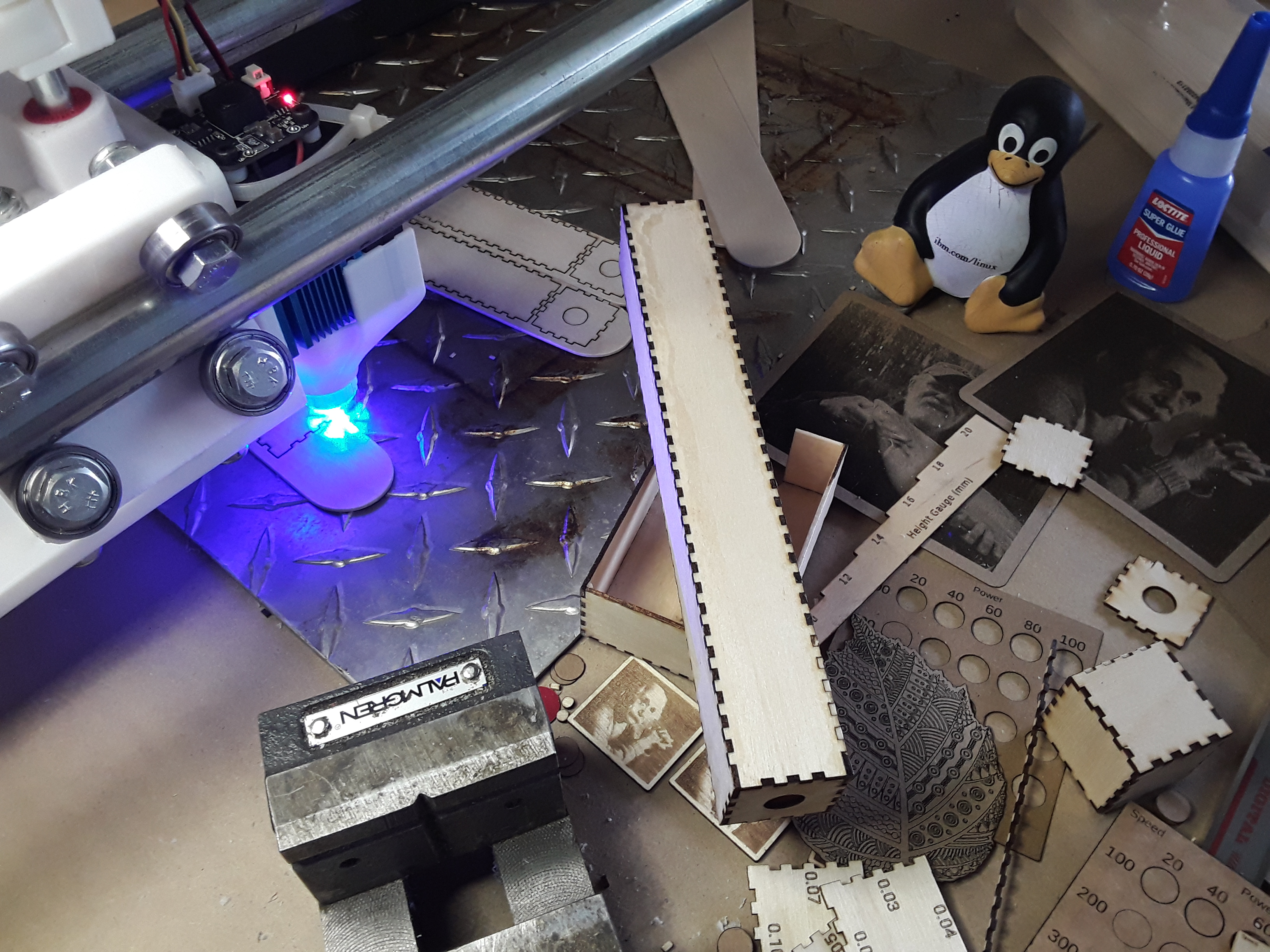

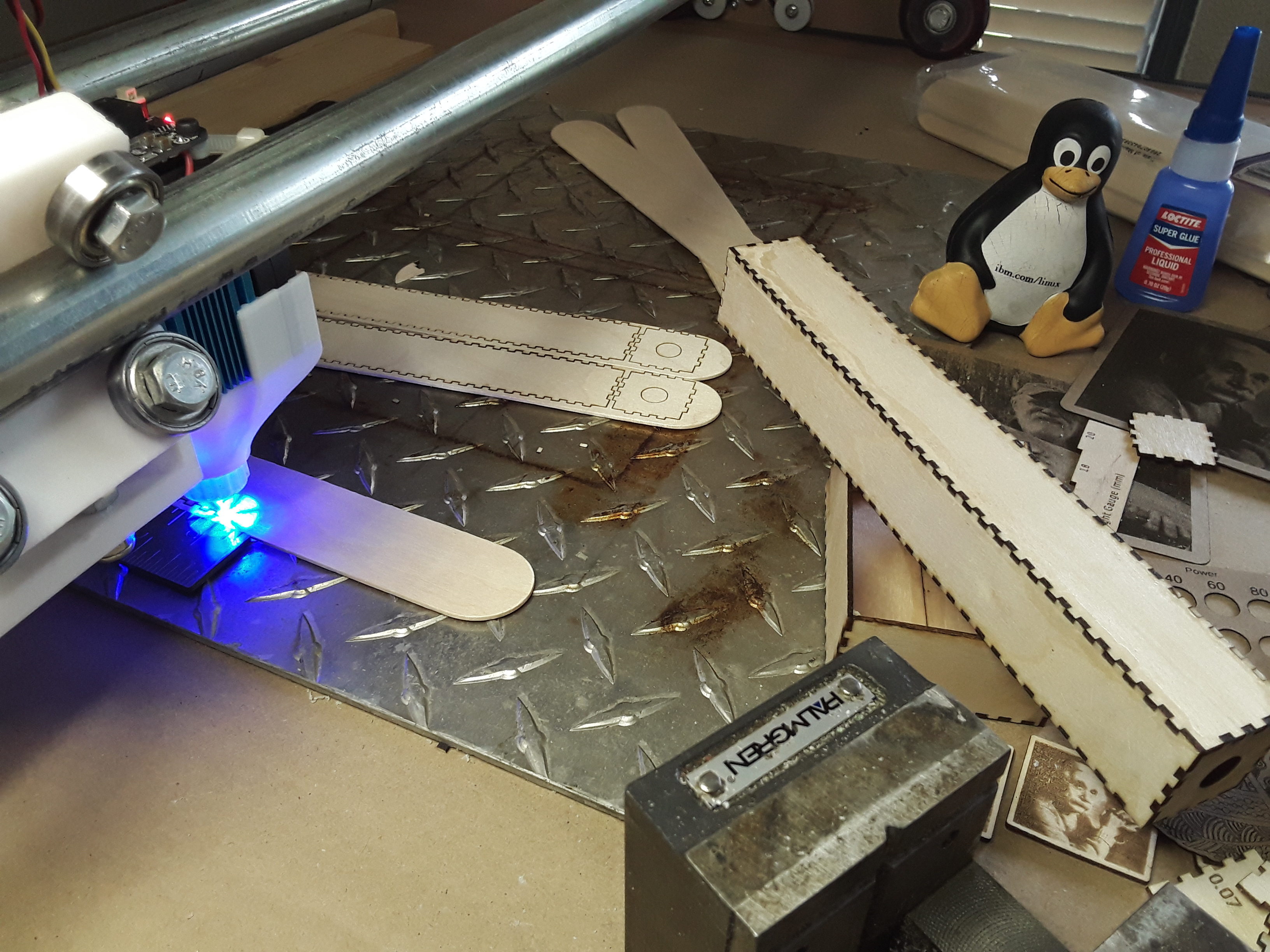

Possibly what you saw… I recently discovered Boxes.py to be a fun site with an amazing array of box designs to generate and build. Playing with simple giant craft sticks I made several fun “boxes” with my little 2.5 watt laser…
