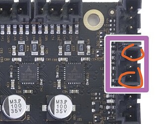

OK, I know its been a while, but I’m finally getting to setting up a filament sensor.
I have the two wire microswitch style but when I plug it in the sensor port on the prusa mini board it tells me it is not connected.
here is where I am plugging it in.
the prusa instructions are not clear and are intended for the runout sensor that prusa sells, that use a 3 wire connections.
Hoping someone can help.
thank you
I don’t have that board, so can’t tell which pins are which, but you want the switch to connect the Signal and Ground pins at the board. The 5 volt positive connection is used to run the circuitry for the optical sensor and LED, which you don’t have when using a simple switch.

Feedback on the prusa forums indicate it won’t work and I have yet to find an example of using this kind of switch on a prusa mini.
That’s the right place for detailed support of a Prusa product.
If the Prusa design expects a smart filament sensor (e.g. it either has an encoder to count motion steps, or has a microcontroller to report detailed telemetry) then it won’t work without making a firmware modification.
A good reason to buy the Prusa switch.
yeah, that’s where I’m heading. Just sucks that shipping is slightly less than the part itself.
