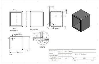

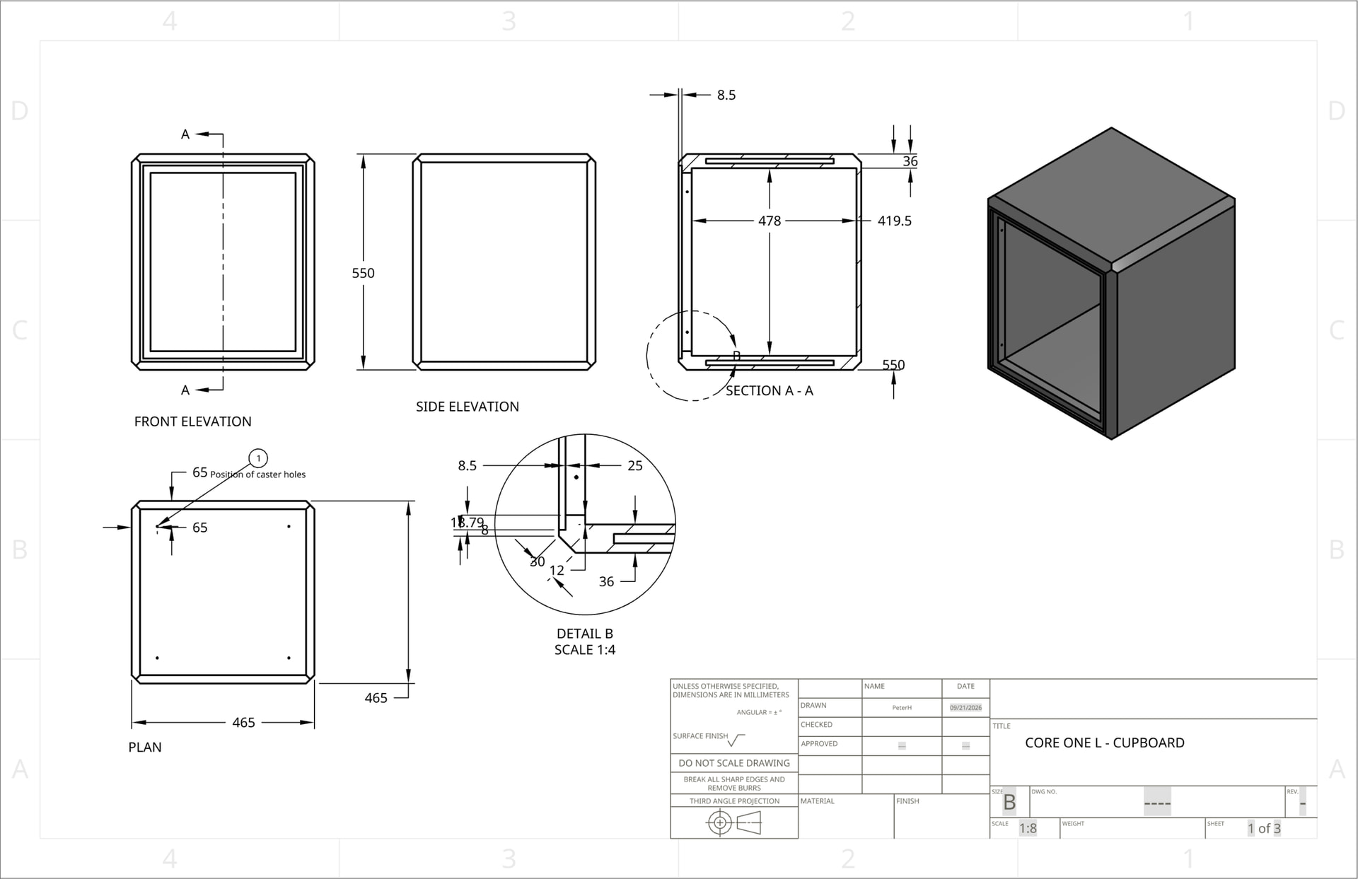

Here’s my current cupboard design, which is the same as the existing one but with dimensions! (normally I just work it out on MDF as I go but I am trying to practice drawing.

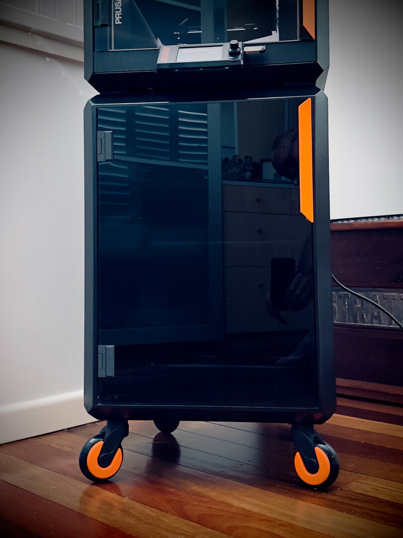

I have, for the moment, given up on properly sealed doors, as I have ordered the new magic SunLu cupboard. This box is specifically intended to match the CoreOne style, has a simple neoprene seal and frameless acrylic door.
But I had seriously (and will continue to do so) looked at the above system.

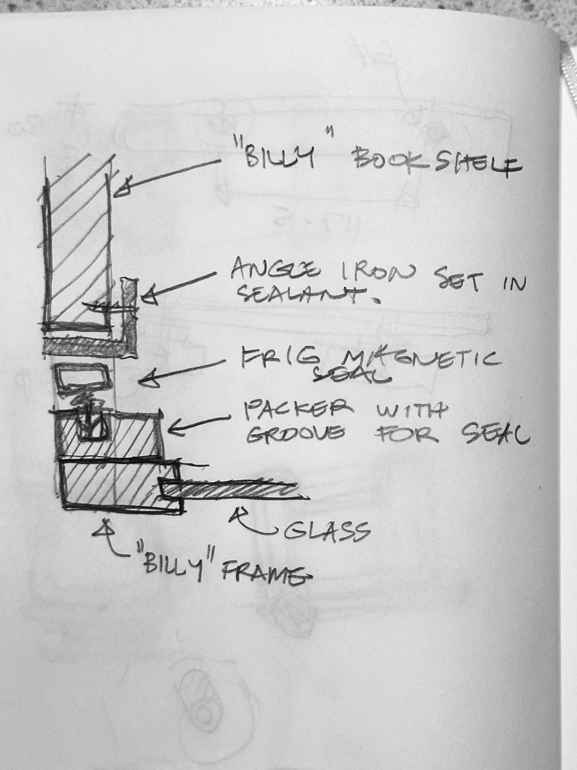

If you search for “magnetic door seals”, you will find a range of refrigerator style and also some “shower door” seals. I don’t think the shower door style will work as they need to be air tight and you need to find a way of sealing them all the way round.
The frig seals need a hefty metal angle to guarantee a seal against and some thought as to how you can hinge them to seal evenly. This isn’t a great problem, I have even given some thought to modifying an Ikea Billy bookshelf and glass doors like so, and am confident that it would work well:-
The elephant in the room of course is cost. Where I live by the time I buy the book case, the angle iron, the seals and the fan setup I could have two of the SunLu boxes (if the first one works well enough I will almost certainly buy another).
A far cheaper option is to use a discarded bar Fridge and modify it with the active ventilation shown, perhaps with a small heater element as well.
