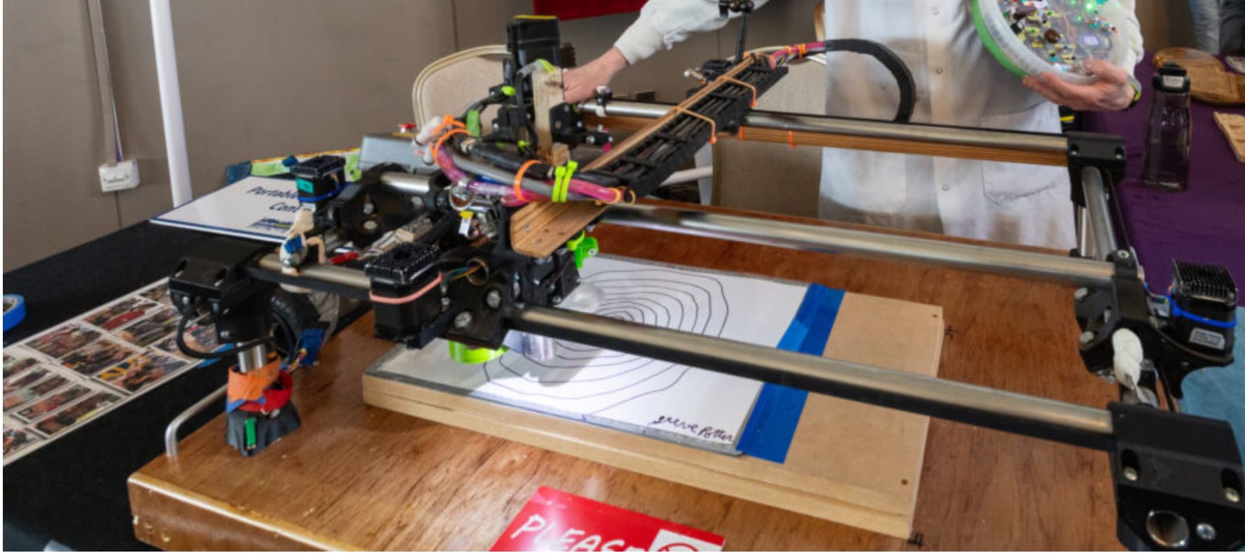

Thanks, yes it was the best Dublin Maker yet! Great big venue, and I think I got one of the best spots for my stand, with huge traffic for 8 hours. I wisely only displayed my Portable Primo and wireless pendant on Sunday so that I could spend Saturday looking at all the other stands. So many fun things! You can see a nice gallery if the fair here.
And here is an unlisted 8x speed timelapse of the whole day at my stand. Many kids got to play with the pendant and make drawings. Huge thanks to my wife, Máiréad, who helped all day. We were knackered!

Can I ask what the cutting capacity of your build is?
My Portable Primo’s Work area: 312 x 618 x 90mm
I also can pass through longer stock in X or Y direction, for tiling big jobs.
Thank you!
I was planning on making mine 700 x 700 - but am worried that there might be too much deflection in the conduit - using the galvanised steel conduit from Screwfix - do you have a view on that?
Also wondering if it’s possible to fit the same supports that people used on the Burly?
It depends on the the trucks being able to pass a threaded rod attached to the underside of the rails.
I used 2mm wall thickness stainless steel tubing, but recently changed the two moving pipes to 3mm thickness because I was getting some bad resonance problems with aggressive cuts. So yes, thin conduit is only good for a smaller build, imho. I can’t comment on Burly which predates my build by a couple of years.
