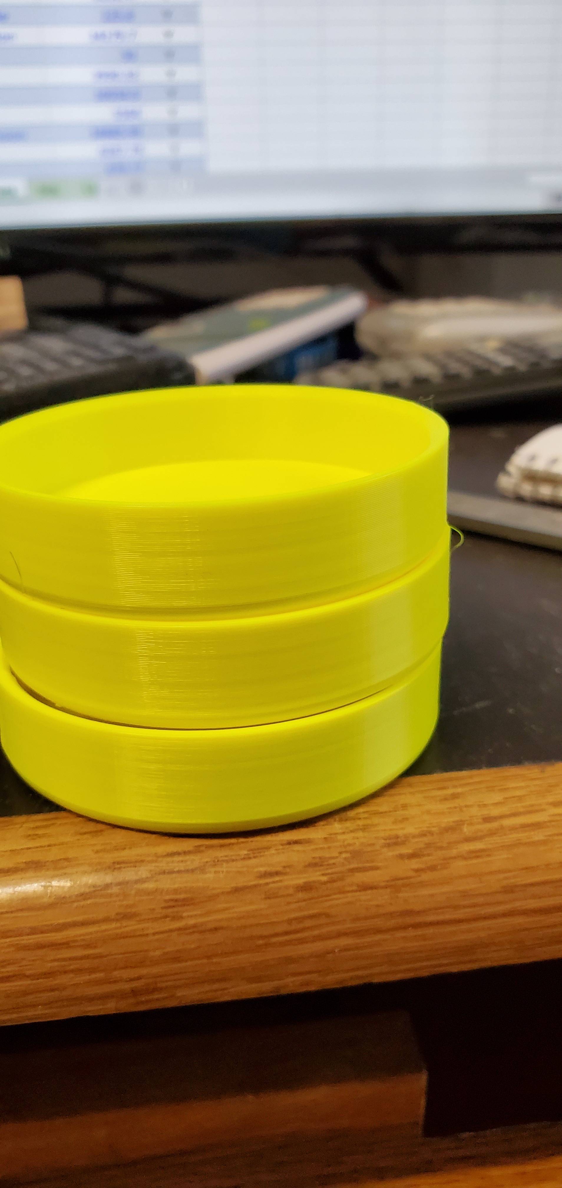

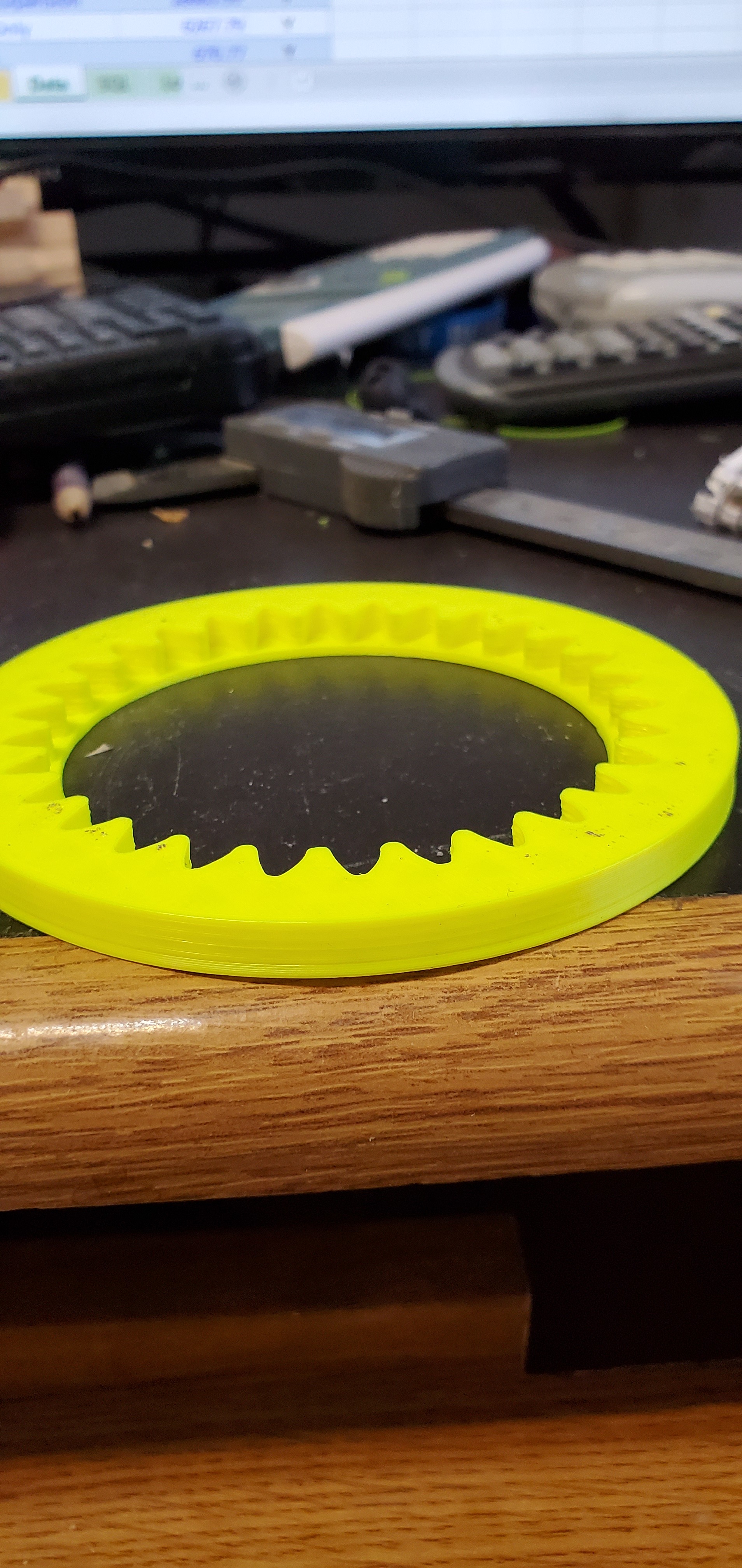

I usually blame the fact that I don’t make the time (and don’t have the patience) to properly calibrate and really dial in my printer. It doesn’t help that the printer is in the basement, and all the computers are on the main floor. Sneakernets suck.
If it wouldn’t kill my real work productivity, I’d bring my printer up into the office.
I get some parts that are great…
And then some garbage like this
Of course, I’m not making pretty things, so…
