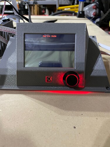

I have an SKR Pro 1.2. Is there a comprehensive installation write up anywhere? I tried to update my firmware tonight and now in Marlin mode it just says Marlin Mode and doesn’t show X,Y,Z or menus or anything. In touch mode I can navigate through the menus but the steppers don’t respond. It was working before the attempted update.
I was installing the firmware for dual endstops. They’re not hooked up yet. Could that cause this behavior?

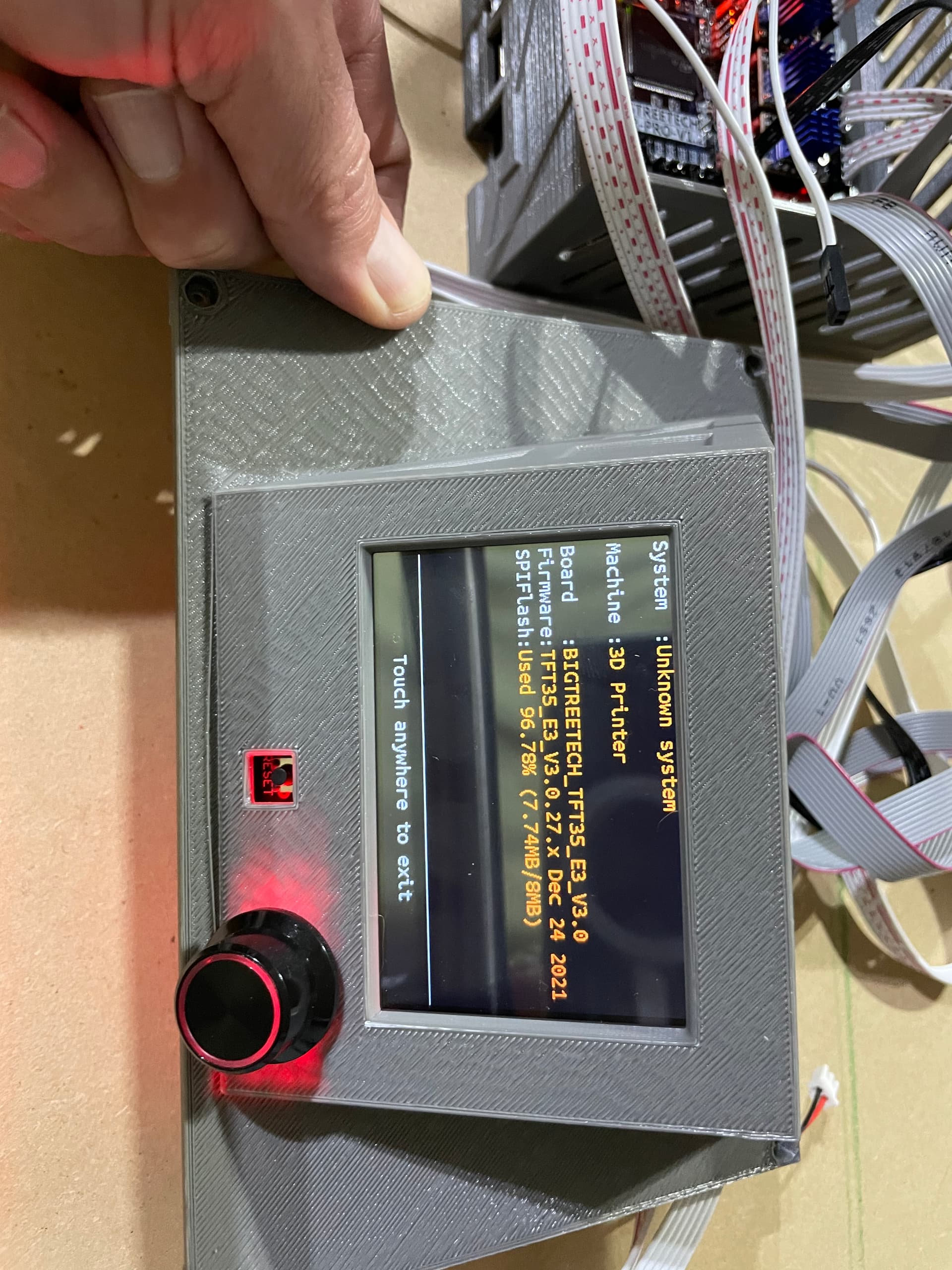

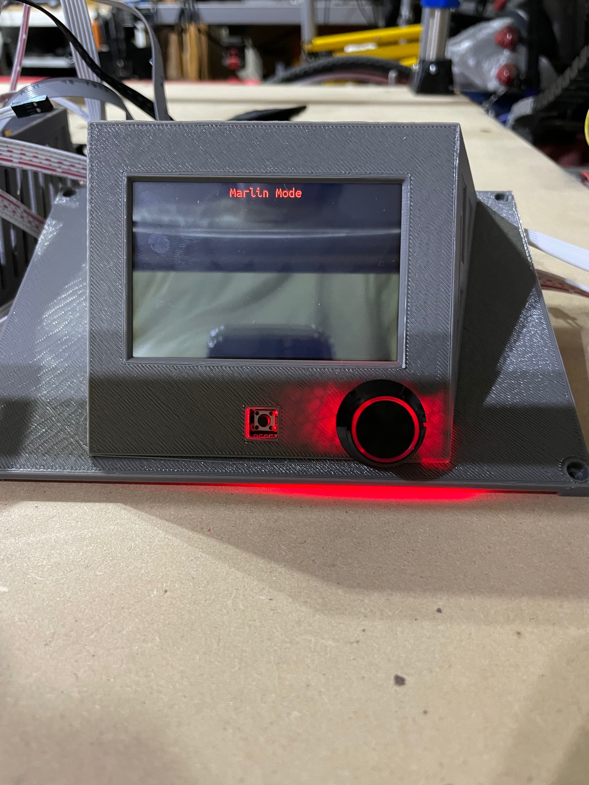

Attached is pic in Marlin Mode. In touch mode it says no printer attached. It seems the screen isn’t seeing Marlin in the SKR board. Also the info screen.
As a first step, I’d reflash the board. Start as clean as you can…fresh download of the firmware from V1 and different SD card, and make sure the SKR Pro is off when the card is inserted. The TFT has its own firmware, so having the menus displayed in TFT mode means nothing in terms of the SKR Pro board.
