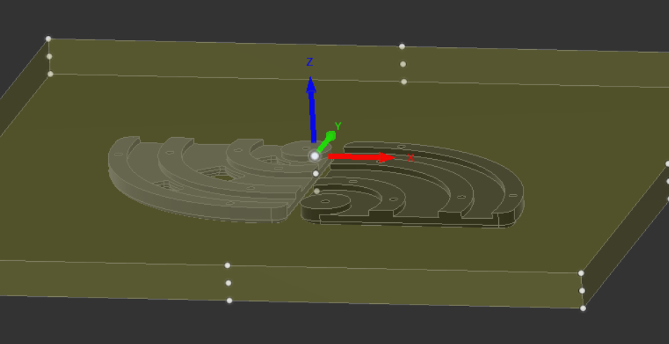

I’ve gone over this so many times I’m just not sure what else is going on. Stuck…
I’m trying to do a Facing operation. Doing Pockets and contours work fine.
Move bit to X,Y that I want. Probe to the top of stock and start the file. Every time
it starts about 10mm above the stock. Hopefully you can see what I cannot. I’ve uploaded my .F3d file.Perpetual Wooden Calendar v12.zip (7.6 MB)

Your stock thickness is 20.2mm. Your zero is set to the top of your part, at z=10. Your maximum stepdown for face is 5mm.
when you set the z=0 at the top of the stock, it thinks you’re setting the top of your part, so it is machining phantom stock above that.
One way around this is to use a box point
and click one of the 27 default locations, as appropriate for you
You can change model position x, model position y from center to offset from left/right, front/back if your stock really is that large and you don’t need it in the center

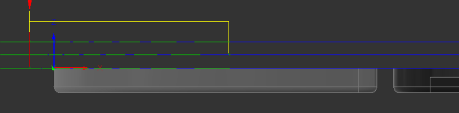

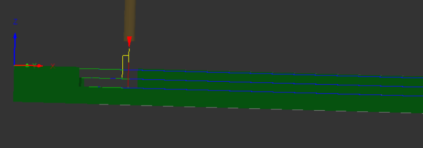

Original facing path:
new facing path:
You can see the paths aren’t changing, but their location relative to z=0 has.

This all makes sense to me now (mostly). The reason for my previous workflow(if you care :wink: ) is that I like to have a fixed size stock so I can setup and see the part cutout on the edges better. I like my XY 0 to be on the top left of the part(not center for this one in particular). The only way for me to choose that XY origin point on the model with a fixed size stock was to pick the models point as there was no spot to pick on the stock box.
I’ve now changed to Relative size stock and can choose the top left corner of my part now and make offsets adjustments to the stock as needed.
I think I assumed that the Heights that I set of each operation would overide my Z level that I set in my setup.
