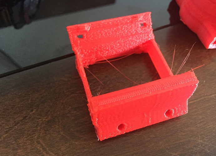

Well now that you have a proper pen mount and the machine is mounted to the table maybe go back to drawing the test file logo?
The test prints looks significantly better. I think I know how to get them looking a little better but maybe you should do a drawing first to eliminate the pull of the filament as an issue.
I am sure this has been frustrating but those last prints prove things have come a looooong way.

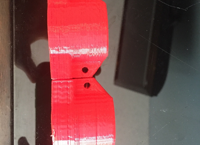

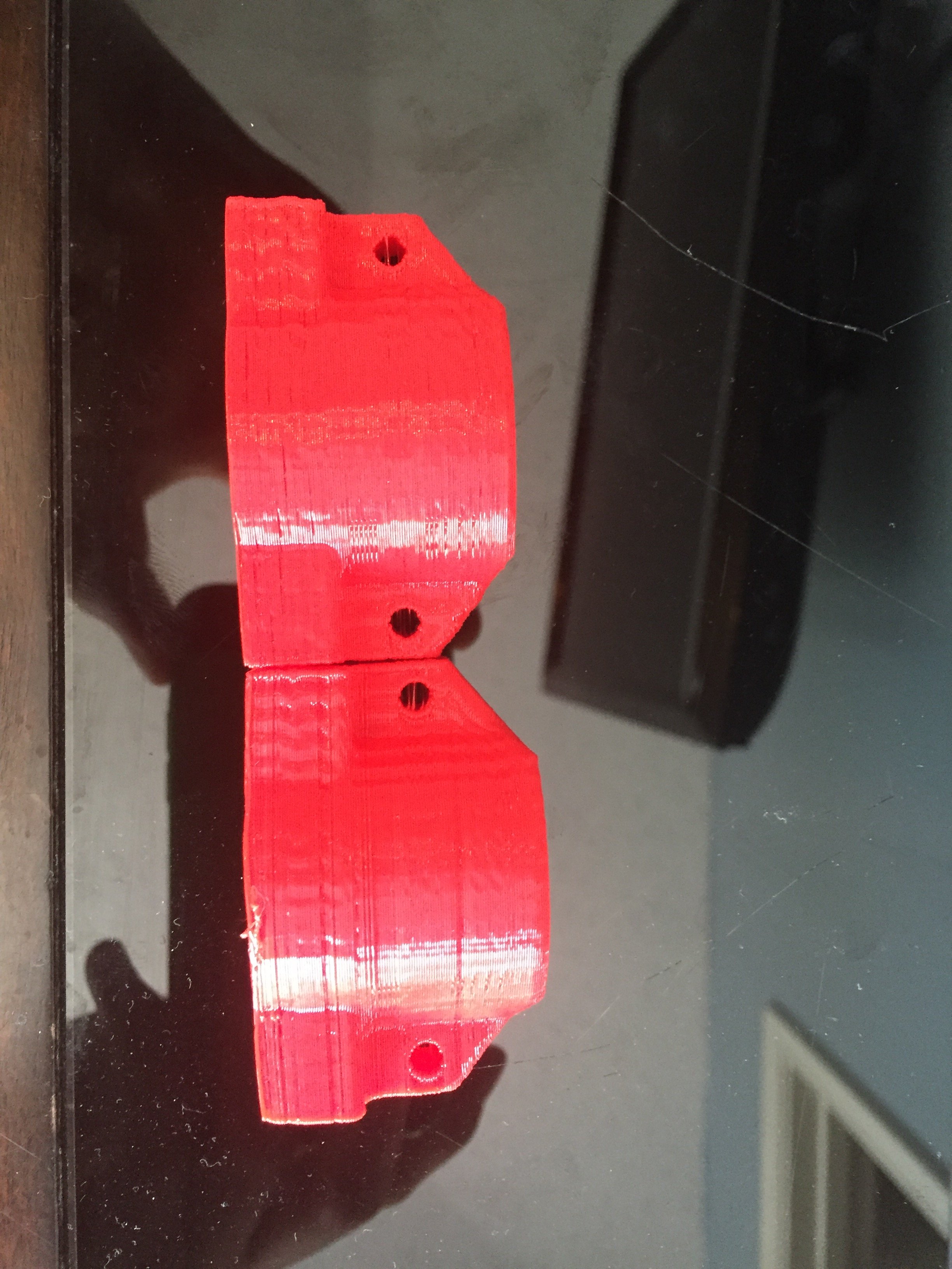

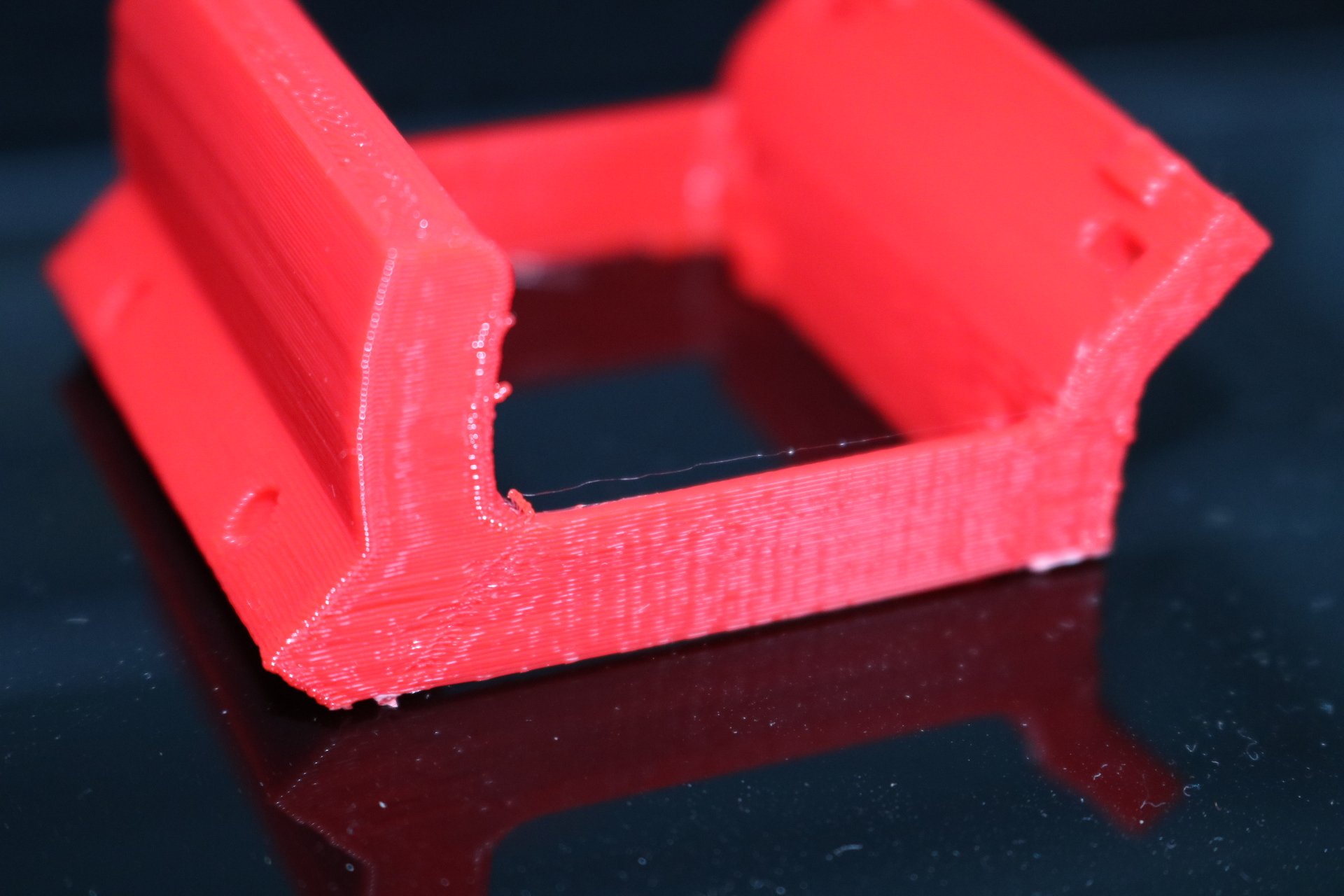

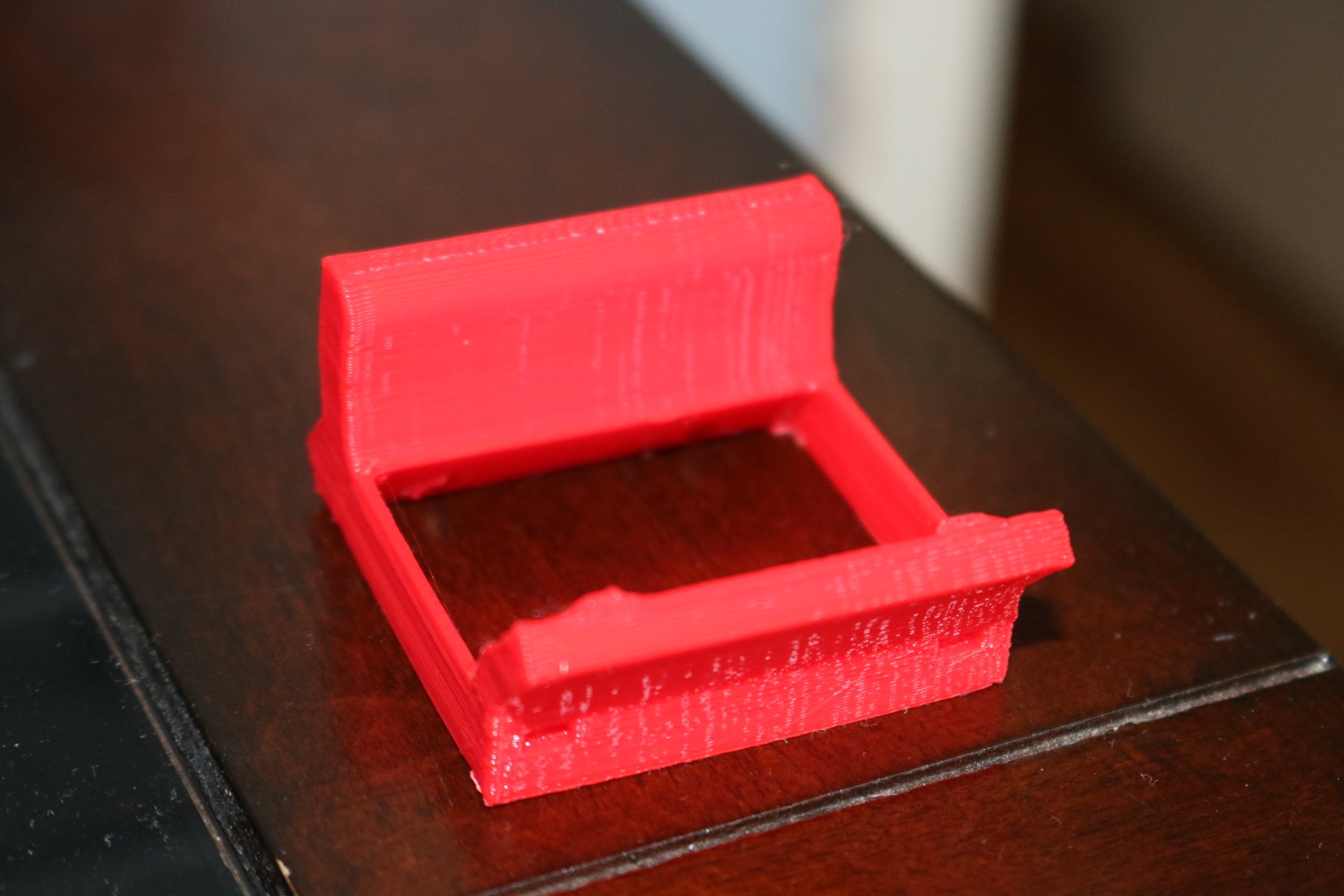

Thx Ryan, will try, but just curious what is the height of the test part supposed to be, remember back when ringing was my only problem? Well I compared the parts, before is on the left, after is on the right, the newer ones are coming out taller.
It probably has to do with your first layer height. Any axis issue will be extreme, as in half or double size at a minimum.
Judging by the last Z move in the gcode, It should be 34.316mm.
Okay you still have some issues if that is the newest part.

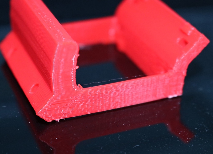

Did you take off the second nut? There is too much heat there, so I am guessing it still on there. I would also tighten the tension screw on the extruder lever 2-3 turns.
Lets see the next print. With both of those done.

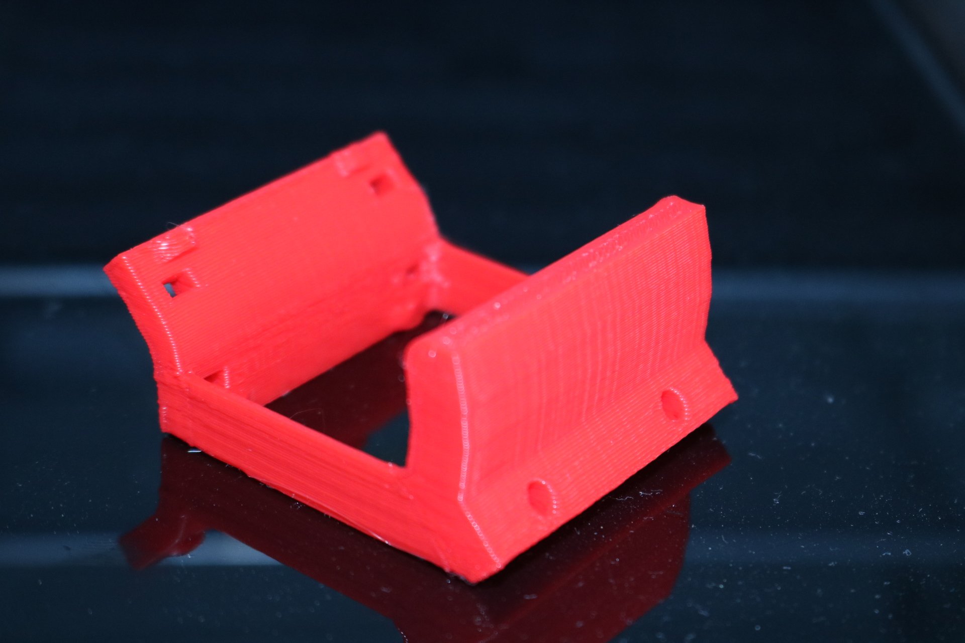

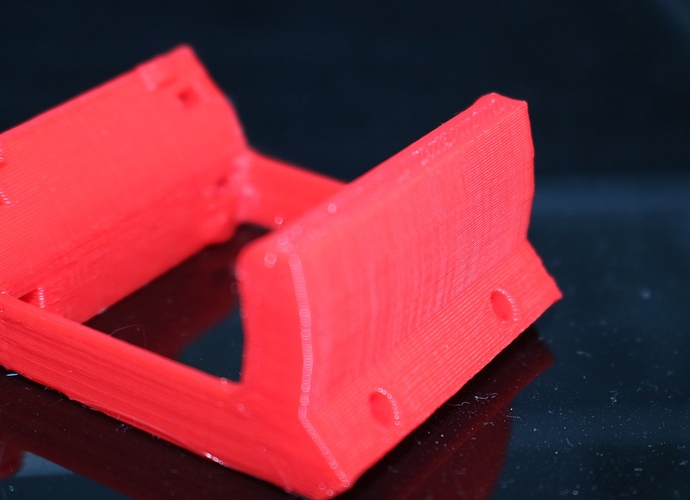

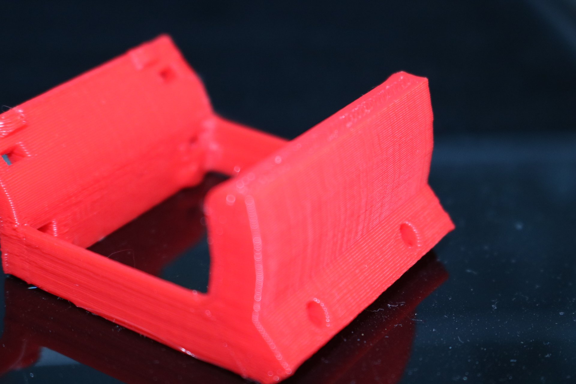

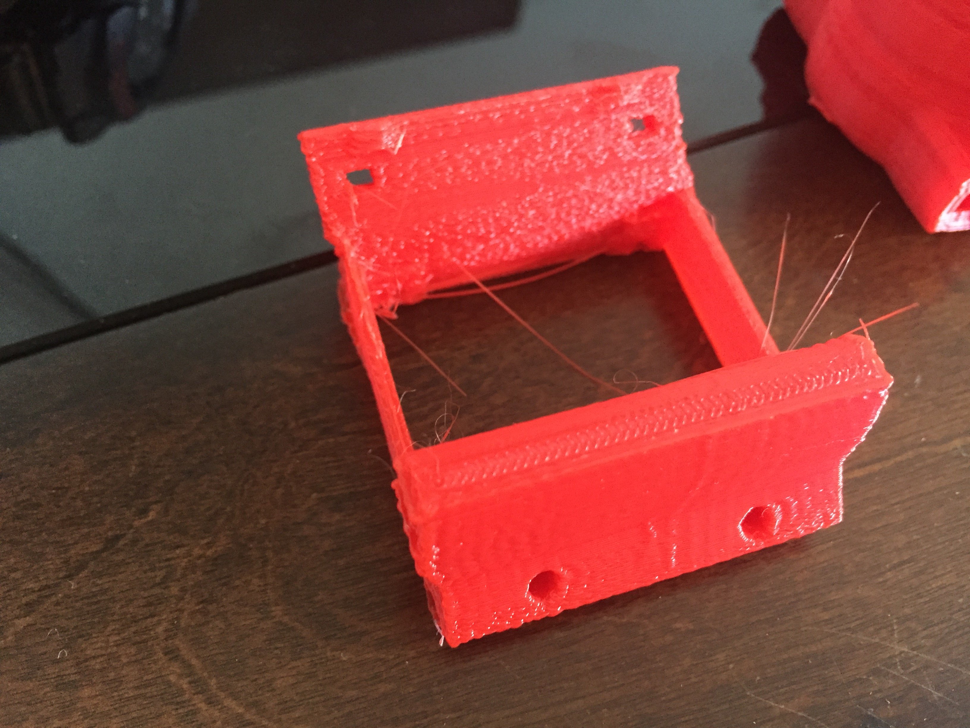

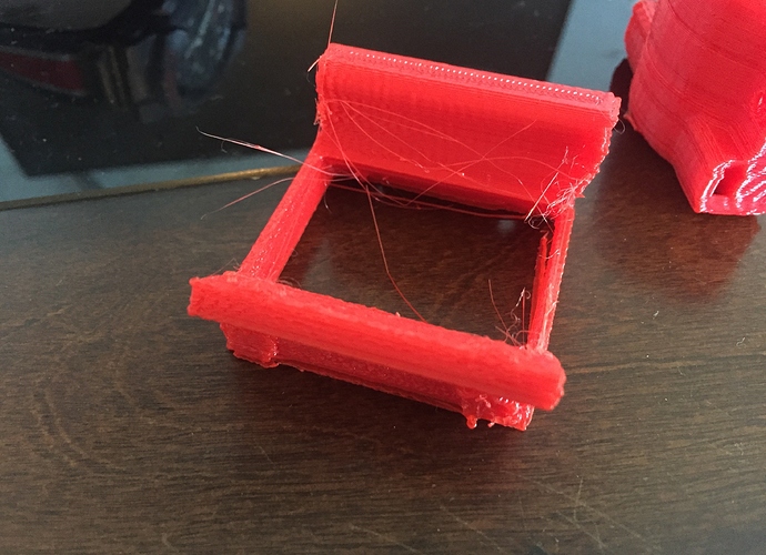

Breakthrough! Ok all, I think we are almost there, messed with the slicer settings out of desperation and and adjusted acceleration on LCD, printed out pen mount again because the other one was horrible, started this when you told me to draw picture. But look below, new one is on right one from 1-2 days ago on left. But it did take 1 hr 30 min…
The acceleration is set in the firmware. You really should not change those setting until you truly understand them, as there are 3 motion settings and they are all interconnected.
But looks like you have a good print, Wished I could have gotten you there sooner. Now have fun.
