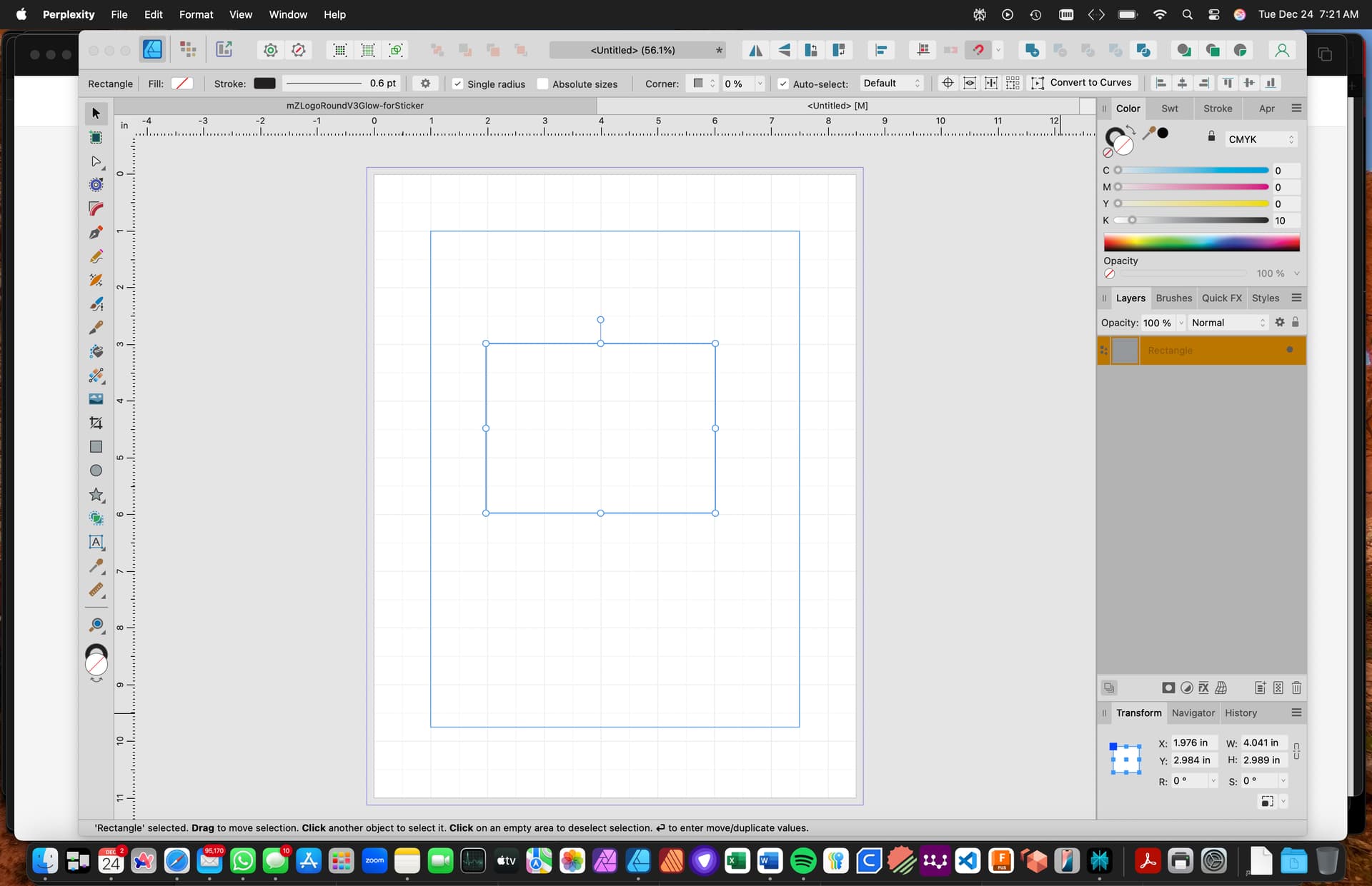

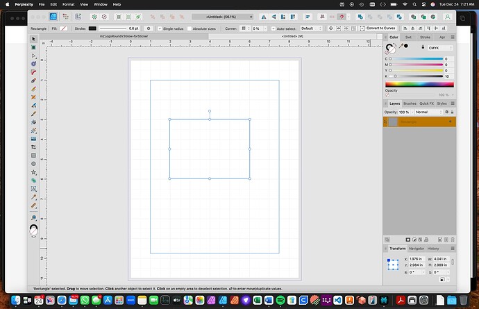

Hi @ahbrown41 I had a similar problem with Affinity. Try this simple square, transparent fill and small stroke (0.6pt), then export SVG with setting shown to ESTLCAM. On import to ESTLCAM check the width and adjust to your actual design as needed. For me the stroke/outline and transparent everything else + the export settings made the difference. Let me know if this works for you or if you need more help. M

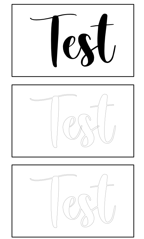

As @quarter42 mentioned, converting font-based text to curves before exporting will mean that plain vectors get exported instead of font-based content, and, as @quarter42 also pointed out, that means that for cutting/engraving purposes, if the font is a cursive / handwritten type font with letters that overlap each other, you’d want to weld the separate vectors (one per letter) together into a merged set of curves.

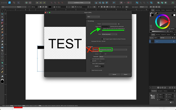

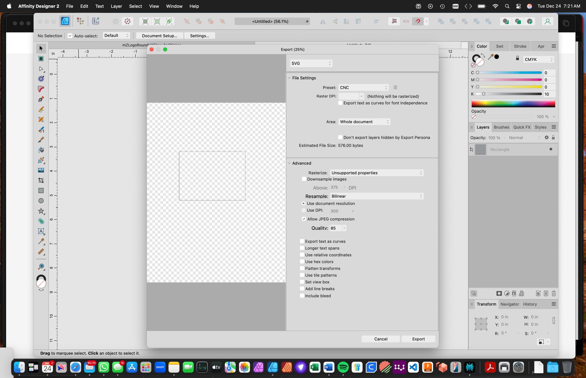

Handily, the Affinity Designer 2 app’s “export to SVG” dialog box offers a check box to automatically convert all the fonts to curves in the resulting SVG (see screen shot). Also, in the same dialog box is an option to rasterize, with a dropdown that includes a choice of “everything” — and that should be avoided by leaving it at “unsupported properties”

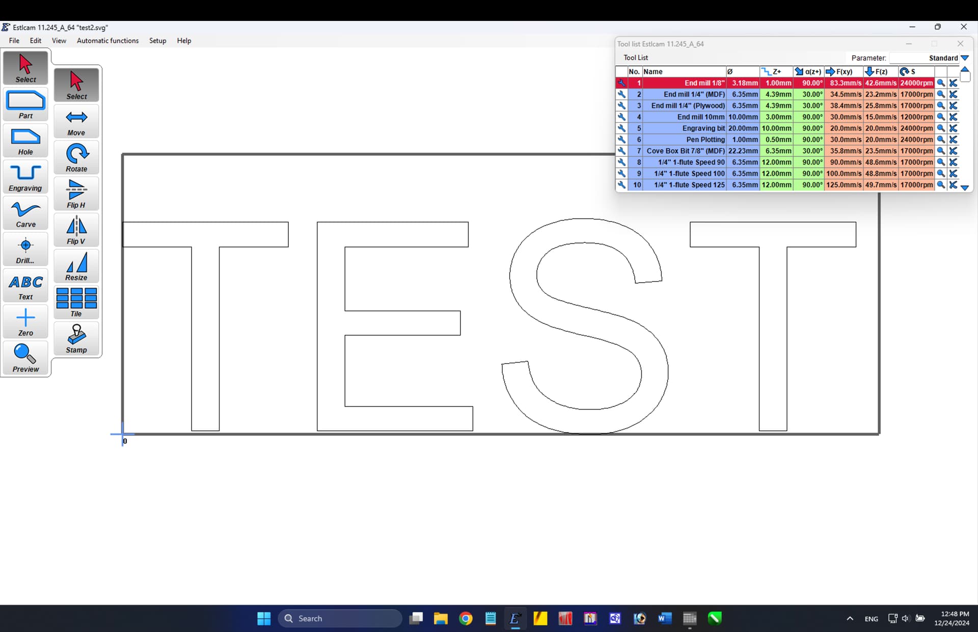

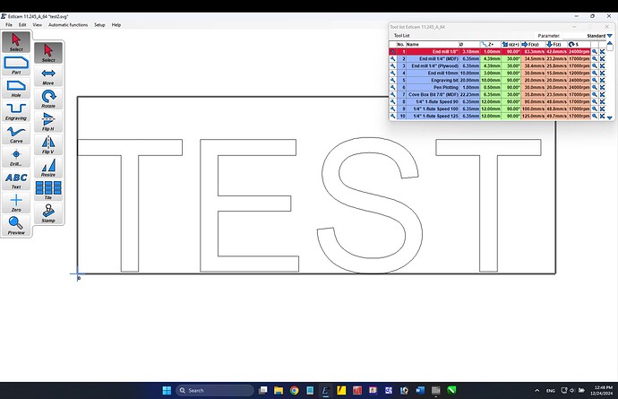

In my test export of the above font-based word “TEST” — all I did was use the export option to convert all fonts to curves, and ESTLcam has no trouble showing the vectors, and there was no need to remove the fill on the word in Affinity before exporting:
