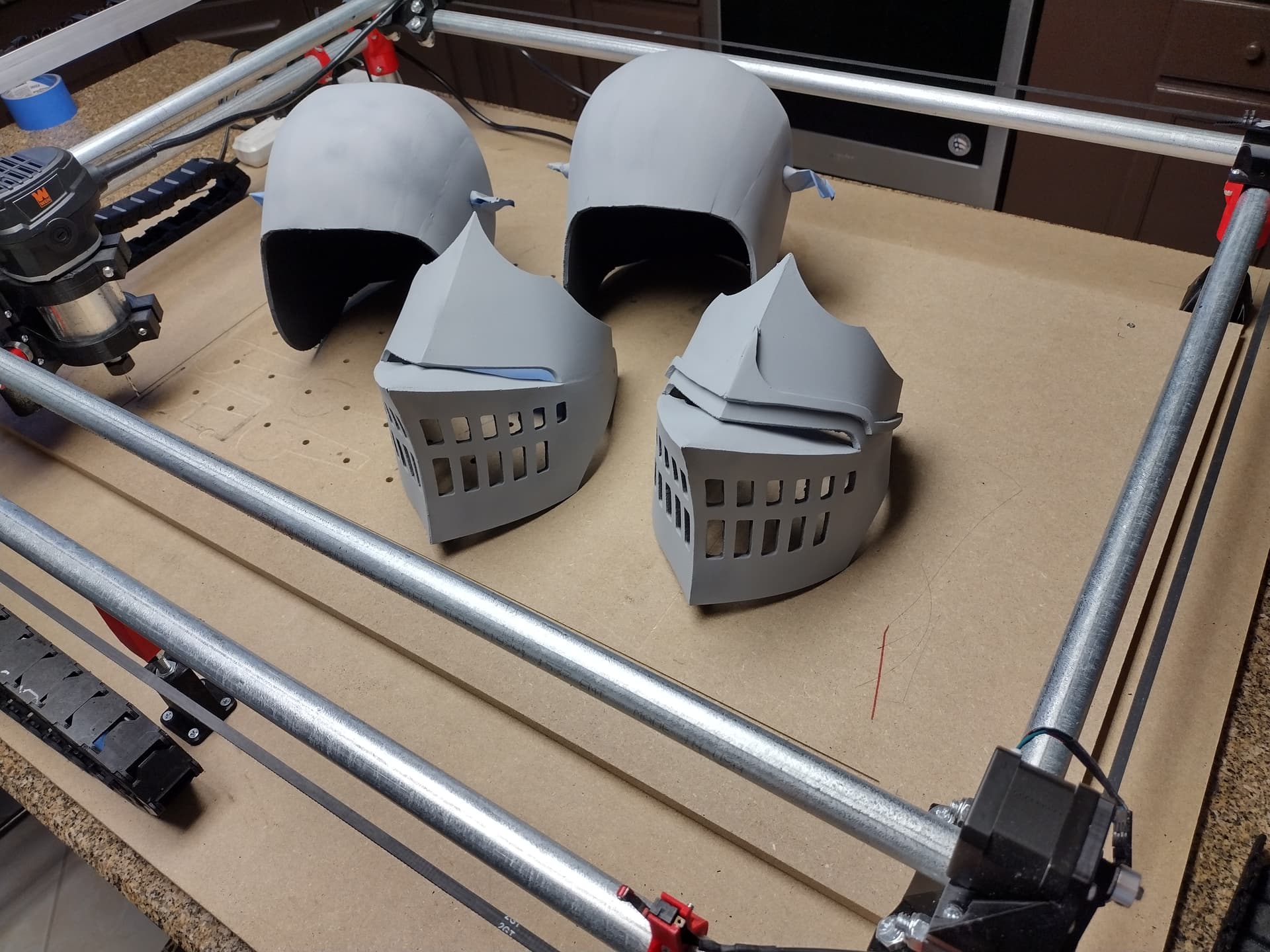

Sorry, haven’t posted in a while, got busy with other stuff. After some reflection, I wasn’t happy with the helmet that I had made. I had sized it up about 10% from the paper template, and it ended up being too big. As much as I hate wasting foam, I decided I’d chalk it up to a learning experience and try again. Got two more helmets and visors cut out and assembled.

My new helmets will be ready for primer tomorrow.
I 3D printed some hinges for them - they have magnets embedded to hold the visor in place for both the up and down positions.

I also got a coat of primer on my helmets.
Tomorrow, I’ll do a little sanding on them and give them another light coat. As long as the weather holds, I’ll get a top coat on them this weekend and be able to call them done.

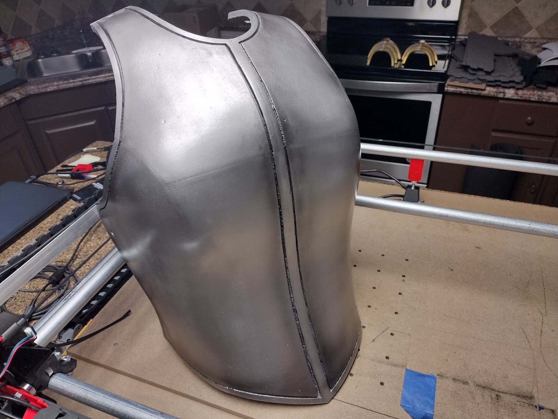

Got the main armor pieces painted. I ended up going over the gold trim. I tried taping it off, but the tape was taking the paint right off. Metallics are notorious for poor adhesion. Ive got some acrylic gold that looks decent, I’ll redo the trim by hand in a couple days.

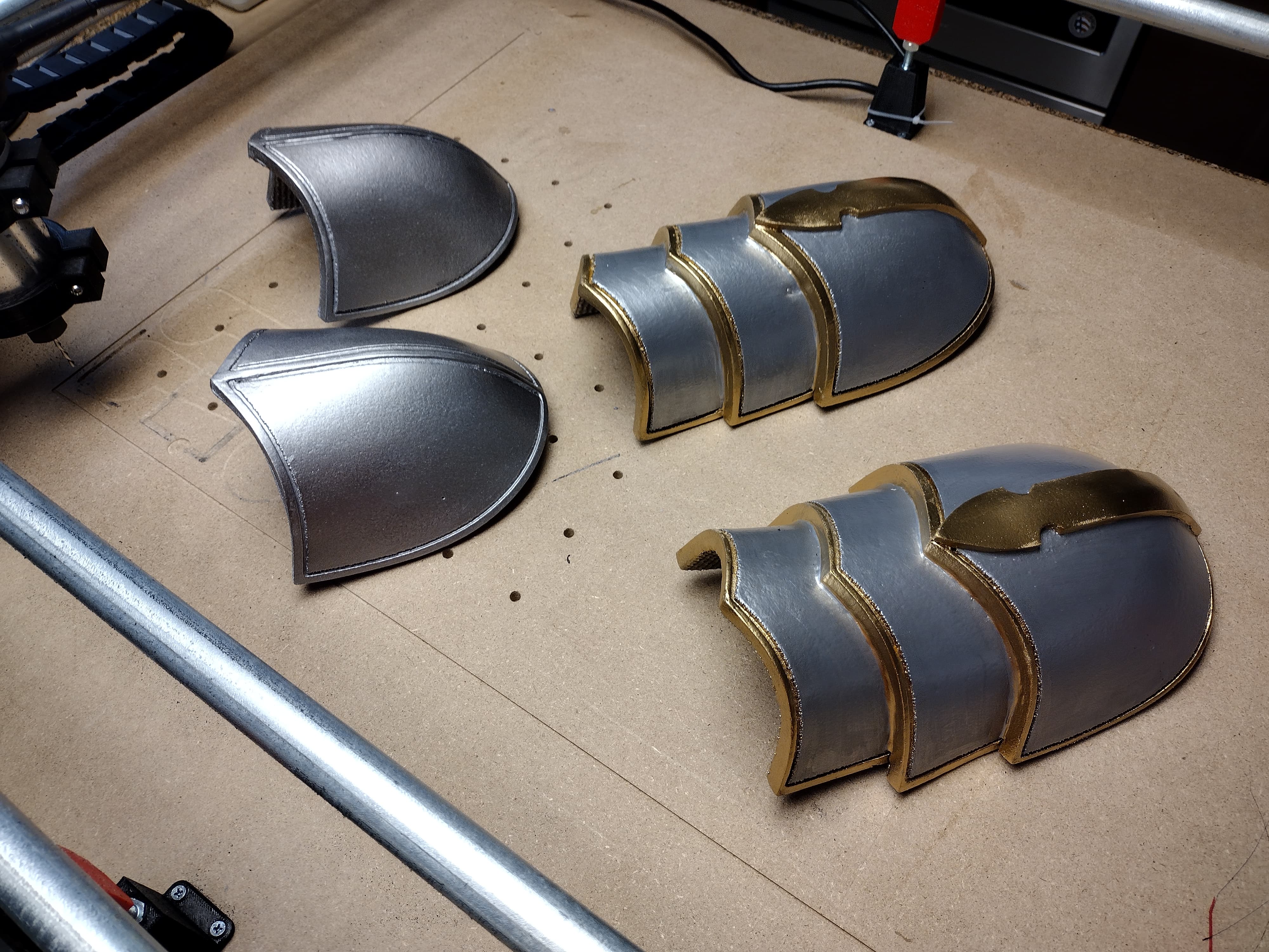

Pauldrons painted. I’m reasonably pleased with how they turned out.

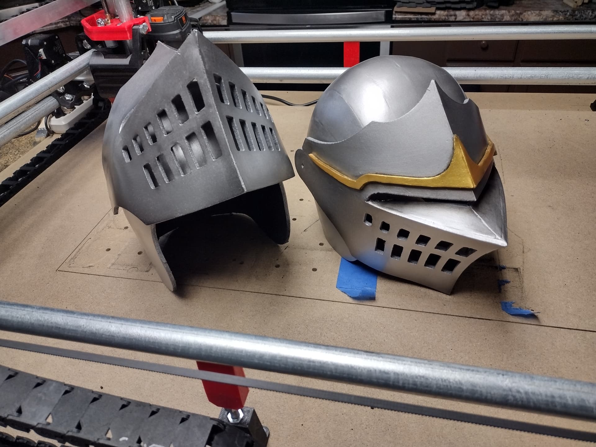

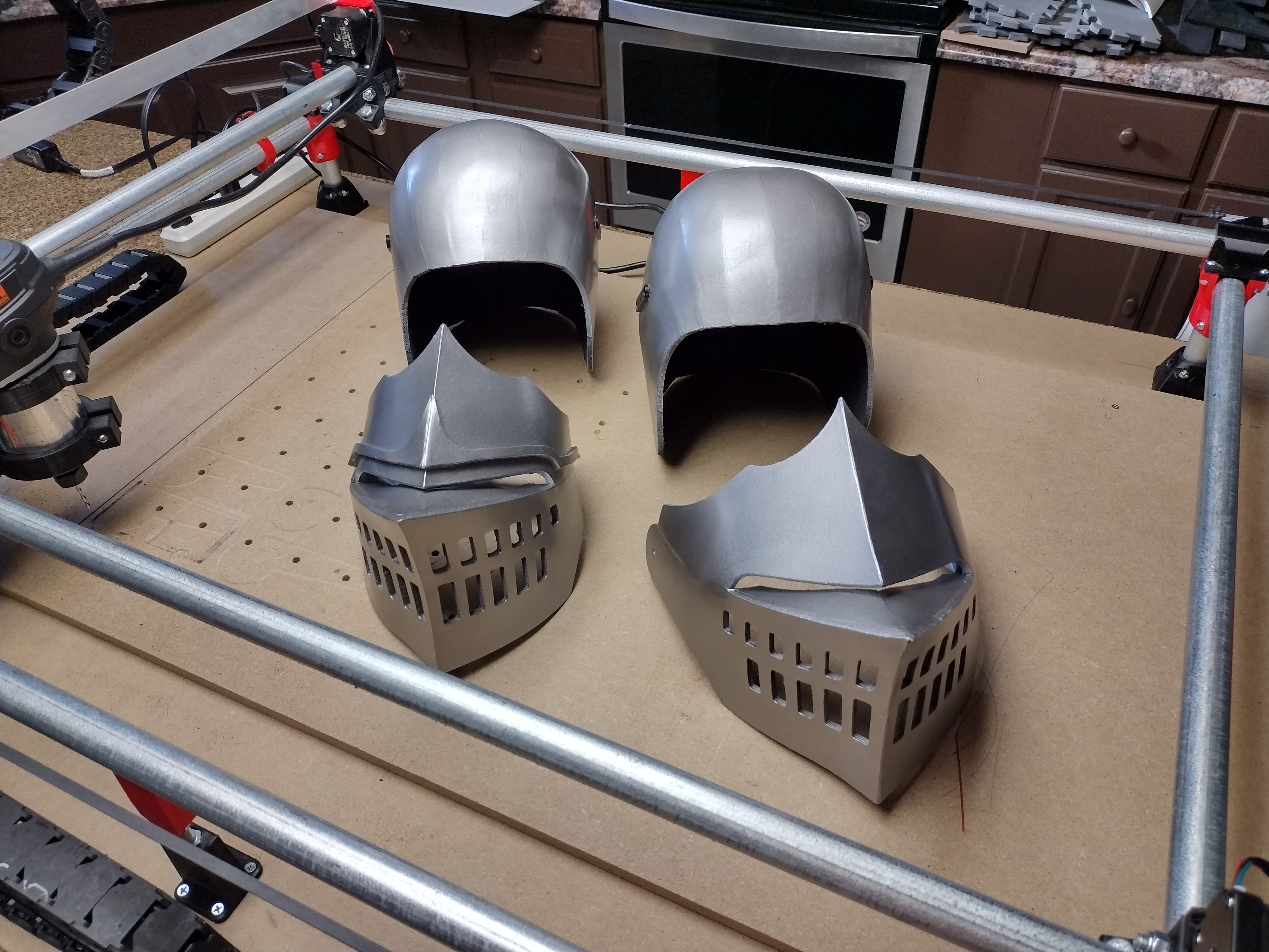

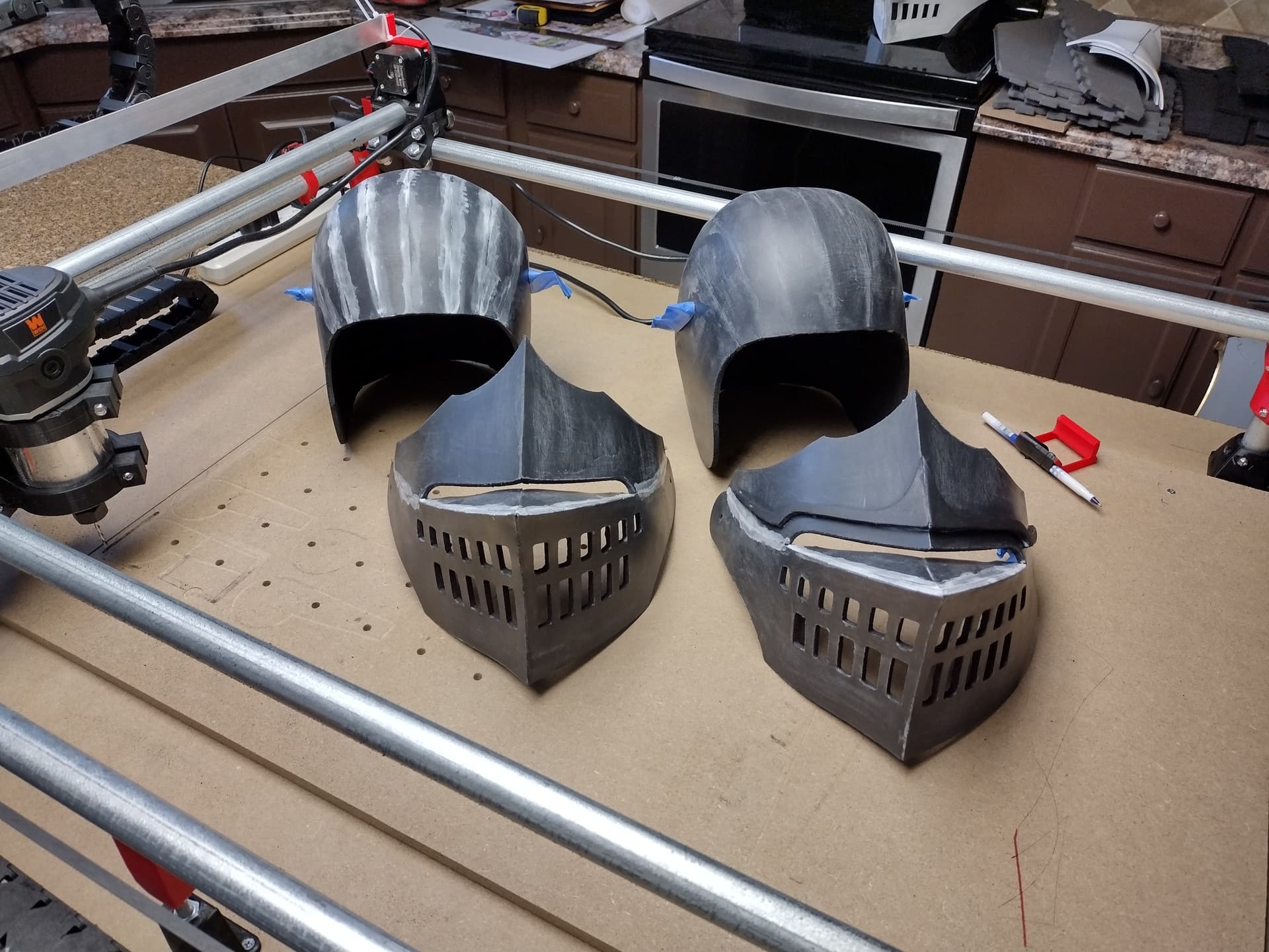

Helmets and visors painted. I really should have spent more time working on the seams, but it is what it is. I’ll do some edge effects and no one other than me will notice.

Got the helmets assembled and attempted to do a bit of weathering on them. I 3D sprinted hinges for the helmets with magnets embedded to they hold in place in the up and down positions. I still need to glue a little bit of padding inside of them.
Did some weathering on the other chest piece. My airbrushing skills need some work, but this is plenty good enough for stage use. Someday, I’ll sit down and practice with my airbrush, and buy one that’s a little better quality than the $25 Amazon cheapo. Someday. But not today.

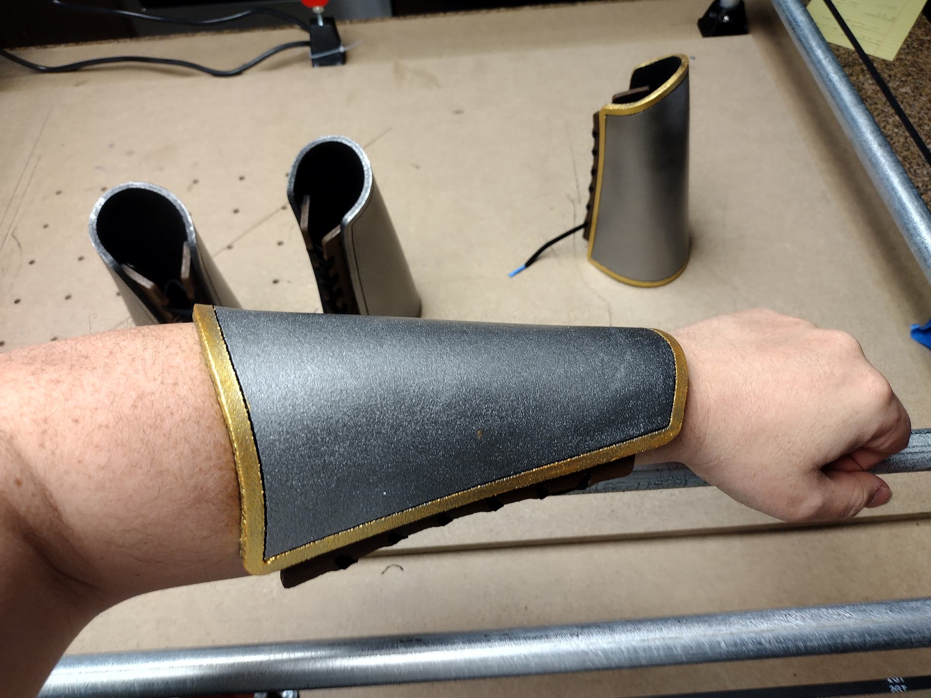

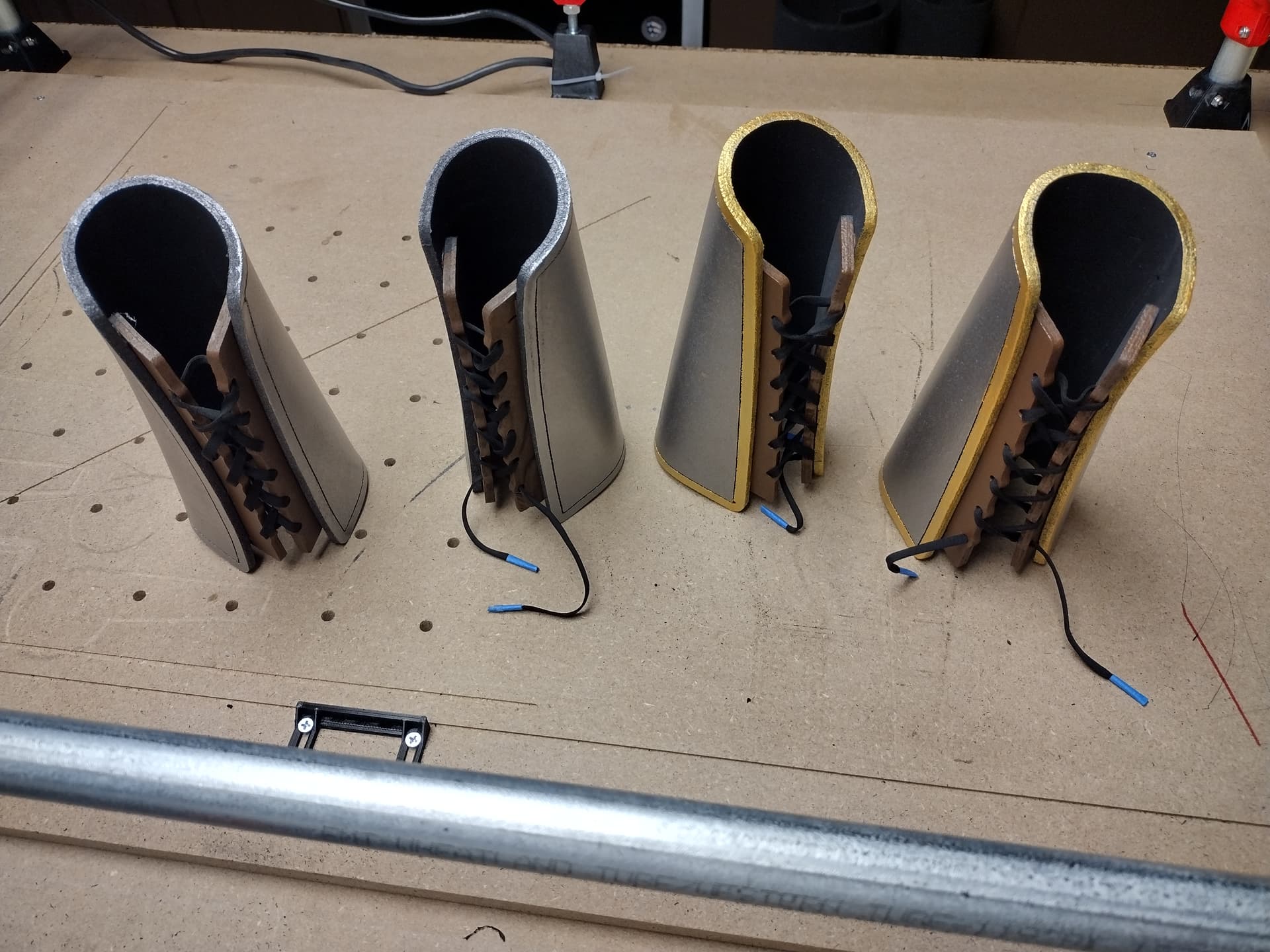

Redid the design for the bracers a couple times, finally settled on something I was happy with. Nothing fancy, but certainly good enough for what we’re doing.
Played around with my feeds and speeds prior to cutting this out and I’m really happy with the results I got. After doing some reading and watching some videos, I realized I was running my router way too fast. I suspected I was, cause I was cutting a LOT of dust and very little in the way of “chips”. Looked in the manual for the router and realized the setting I was using was around 25,000 rpm. According to the (surprisingly few) people who are cutting EVA with CNC machines, around 10,000 is where I should be.
I also cranked up my feed rate. I had been running around 18mm/s. On a whim, I just went ahead and doubled that. Immediate difference! All of the sudden I was getting “chips” and hardly any dust at all, and the edges were SO MUCH cleaner. On top of that, the machine didn’t show any signs of strain at all, so sometime in the next day or so, I’m going to experiment with increasing DOC. I’d love to be able to cut the 5mm foam in a single pass!
Bracers painted and laced with elastic. Once I get a chance to fit them on the actors, I’ll trim the ends of the elastic and tie them off.
Like I said, nothing fancy. Went with a simple straightforward design. Fits me snugly, so they should fit the actors comfortably.

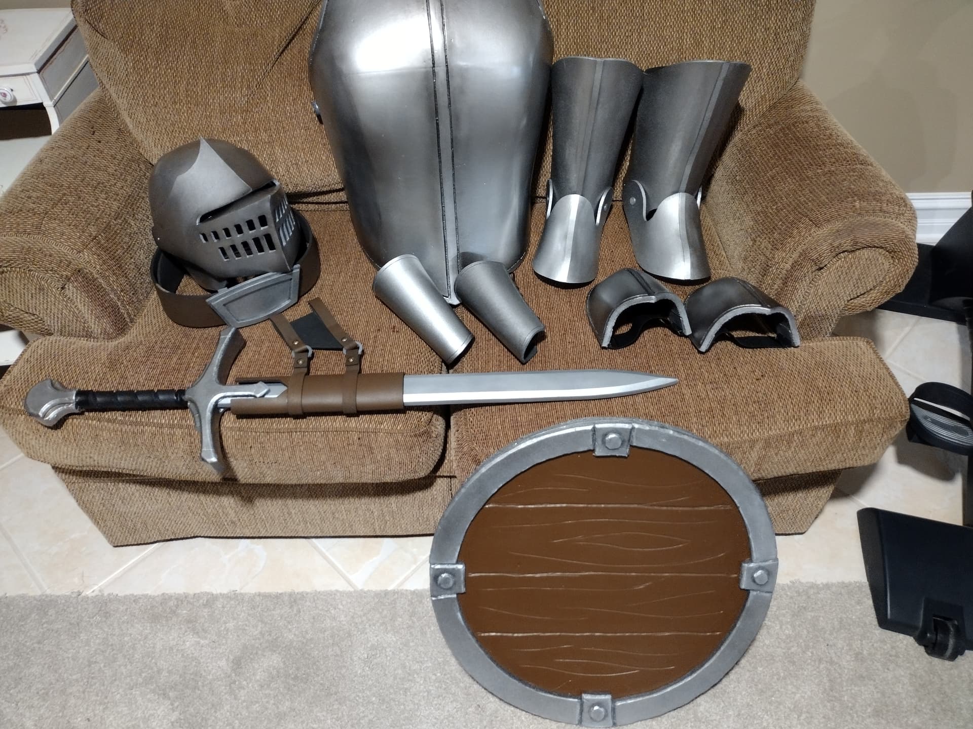

Paint is drying on the last shield, and then I can officially declare this done! Well, I still have to do final fittings and adjustments, but close enough!
Here is our knight’s full armor:
Chestplate, pauldrens, bracers, greaves, helmet, belt, sword, and scabbard. I’ll post the knight’s shield once the paint is done.
Here is the knight-in-training’s armor:
And lastly, here is the king’s sword:
I had joked about making swords from pop culture and video games, but the producer loved the idea. We ended up agreeing on just using a generic design for the knights, but we felt the king should have something special, so I modeled this after the master sword from LoZ. Not an exact replica, enough that the nerds in the crowd will recognize but not enough that Nintendo will send a cease-and-desist (hopefully).
I’ll get some pictures of everyone suited up and post those sometime soon.
