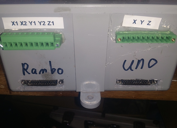

It sees the Controller and end stops I just get no Motor Movement but it runs fine on rambo board when I switch the DB25 Plug
[attachment file=86459]
[attachment file=86460]
[attachment file=86461]
That should determine the amount of microstepping.
Yep I that helps me Remember Now Been a wile since I worked on the Machine giving it complete Overhaul did the Burly Upgrade I am about to throw in the towl with ESTLCAM I have tried 3 different Uno’s 2 Different Shields with 1 Motor only hooked to the Shield Directly and Cant get any Movement I have Been at this for Hours in the Freezing Cold
How about connecting the power supply directly to the expansion board, instead of relying on the feed through the UNO board. Mine works, actually its never not worked if supplied direct, though never tried it from the UNO.
Thats A Great Idea, It Seems Lie a Power Issue.
Even If I hook New Stepper hooked to nothing Bunt the CNC Shield I get Nothing no Stepper Movement and after Going thru trying 3 different UNO Boards and 2 Shields It Was getting to Definition of Insanity Especially at like 31 Degrees in all Glass Green House Thats About Imposable to Heat :frowning: Will Update you Tomorrow When the Suns Heating up the Green House :slight_smile: I have Dedicated PC to run it some of the Trochoidal Milling seems to Bring Marlin to its knees running of SD Card and I love Using the Touch Plate but My Laser Software seems to Run Better off the SD…

I recall the volt regulator on the UNO board steps the power down to 5 volts, to allow the UNO to run independent from the usb cable. I do not think it powers the drivers on the shield.
Its summer here!
Yeah, you have that 12-36V connector on the shield with no power to it. That’s the power that drives the motors.
