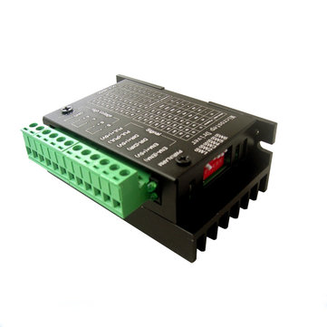

I’ve recently ordered such a Estlcam mega board from cnc-technics.de as well because I like the opto isolated inputs and also the possibility to wire an emegency stop for switching off the power rail in case of the cases…
But I want to go a more profesional wiring and looked arround and found the following steper motor drivers on Bangood:
I haven’t wired it up because it is curently to cold in my shop, but spring is comming soon… :wink:
On question to Christian: You mentioned, within Estlcam, the best way to switch the spindle motor is by using a solid state relay… Now on the mega board from cnc-technics.de the spindle output is througth a mechanical relay. Can I just use the mechanical relay to switch the solid state relay from the spindle motor, which I’ve already wired up from the previous Ramps 1.4 solution?
Why you prefere solid state relays? Is it because of the cross zero switch capability of the solid state relays?
Cheers,
Juergen
