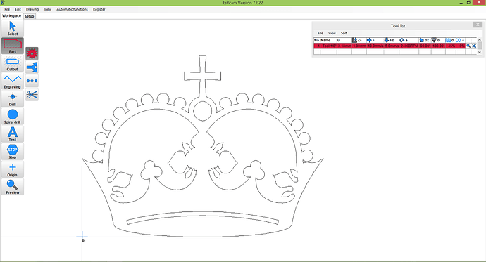

Also, you can try the premade test crown gcode. It will draw about 6" wide.
