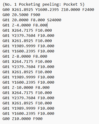

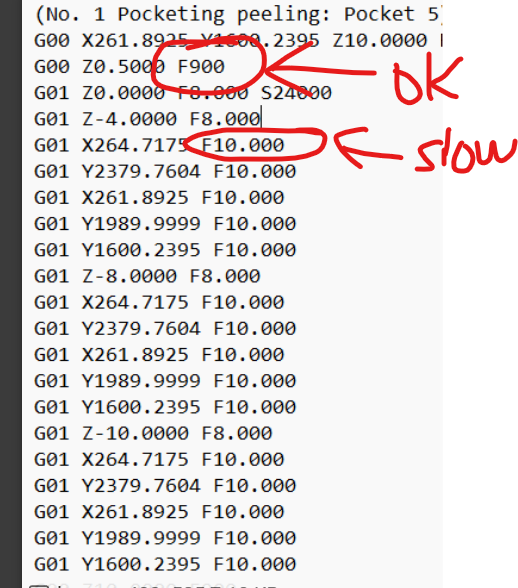

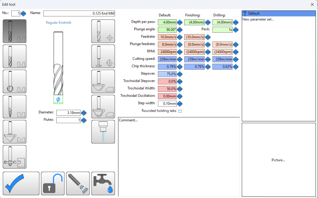

I am doing my first pocket cuts in Estlcam and for some reason its going very slow.

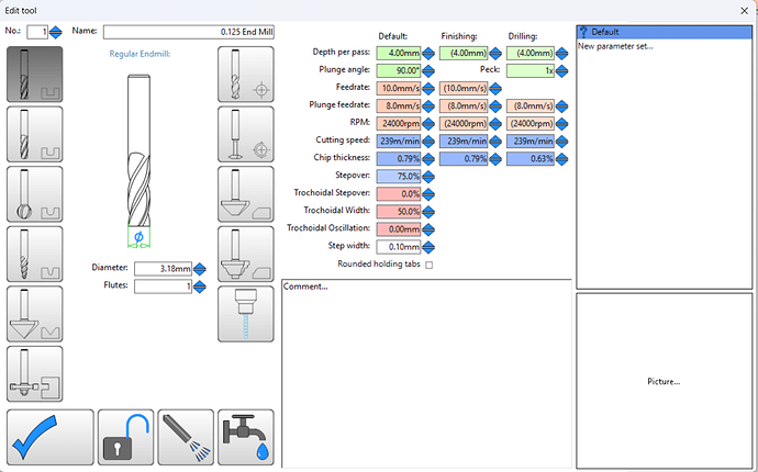

Here is the G code and also the setting for my tool data.

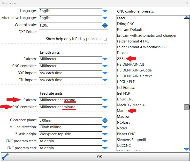

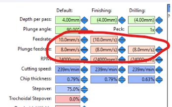

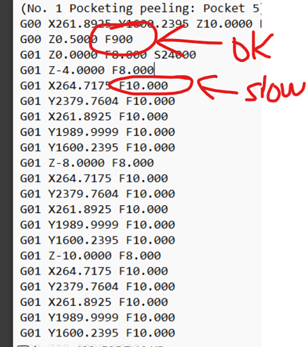

what is your tool stepover %? click the wrench to the left of the tool name and look at your settings. and your cut feed rate of 10 mm/s is 600 mm/min, which is ok, but nothing to write home about. You need to have estlcam send gcode out in mm/min not mm/sec, so it is actually running 10 mm/min because it should math it for you to send mm/min, but show you mm/sec in the tool screen. most of us come from printer speeds, which is mm/s. cnc runs in mm/min. you can have it show you one and send in the other units.
F = feedrate = speed
find your estlcam settings and change your output to mm/min

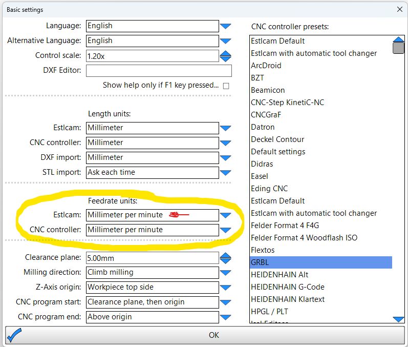

should be like here:
In the online setup it shows this should be the correct settings
Thank you! That fixed it. I had that set correctly but it somehow changed on me…
