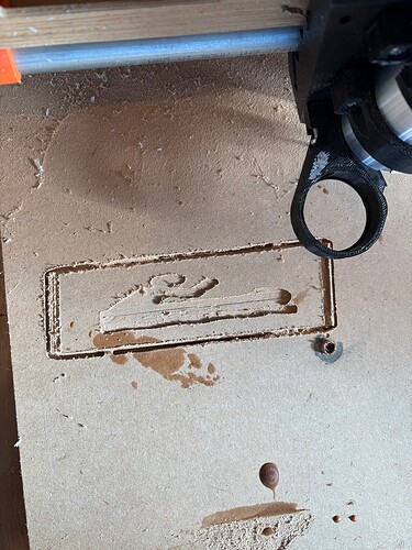

I ran my “first” cut on our LR3 w/ FluidNC today. I say first, because my son has a windows based fusion workflow that he’s had success cutting things on our LR3.
The cut was supposed to be a square with a figure inside.
Designed in Rhino on a Mac, exported to VM (parallels) of Win11 running EstlCam.
X axis cut to scale, but the Y axis is about half of what the total value should be.
There are some squaring issues, but not sure what would cause such a uniform Y axis scaling issue.
Any ideas where to start?
Did proportions appear correct in Estlcam? Can you share the gcode file?
Canoe MUTCD 8in.nc (19.9 KB)
Yes, appeared normal in Estlcam.
Code attached
The gcode looks fine and it is square. I don’t think it’s an Estlcam issue.
That’s both helpful and frustrating at the same time!
I had hoped that there might be a simple issue.
I’ll start driving it in a square to trouble shoot and see what I can uncover.
Thank you for looking at the code Jason!
In FluidNC and Marlin you set the number of steps per mm - how do you do that in Estlcam?
Or could you have a mixture or 0.9 and 1.8 degree steppers?
