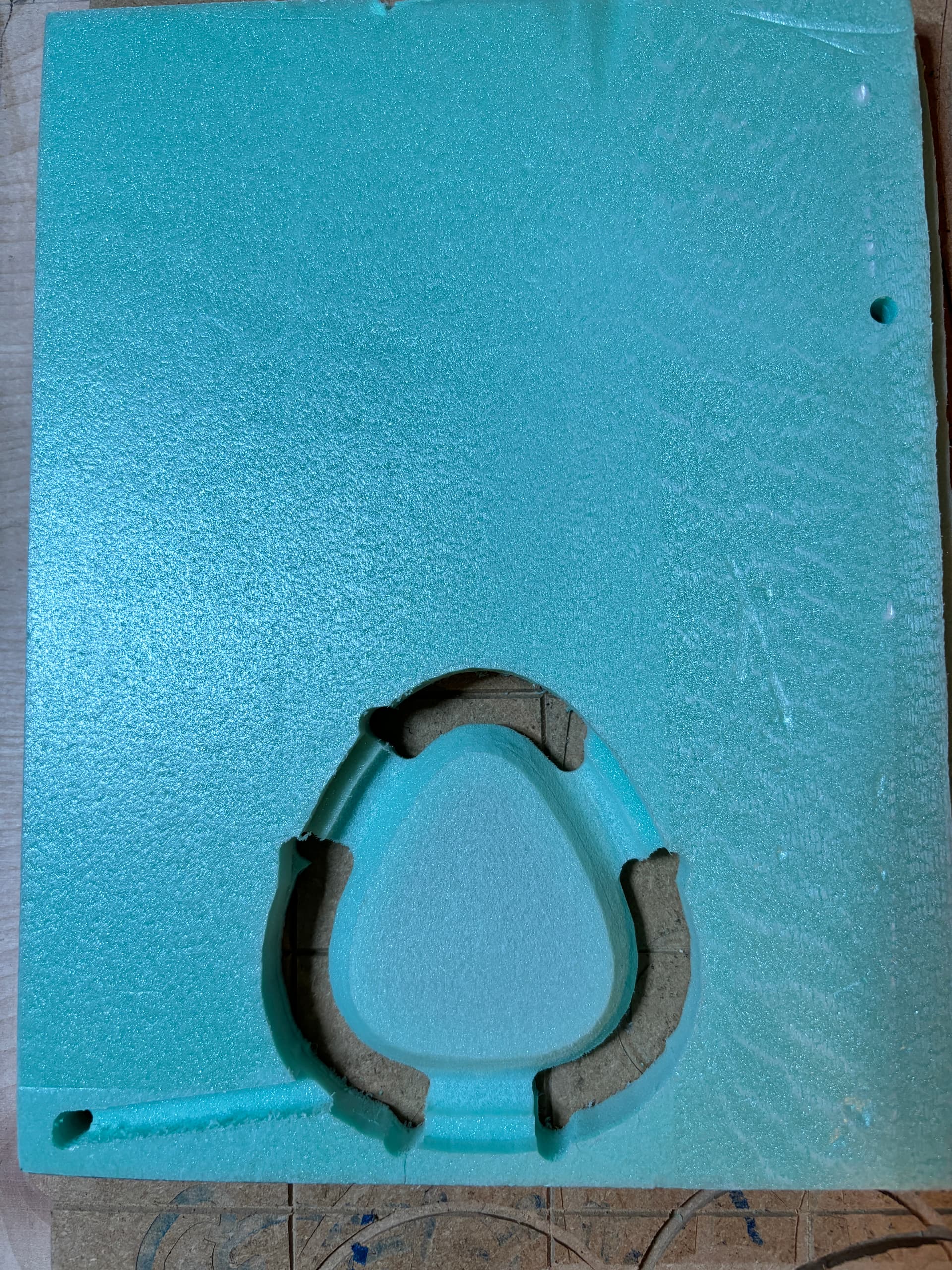

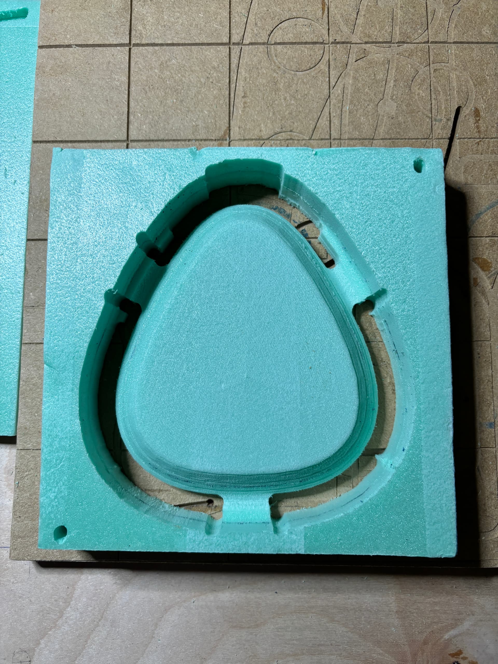

My issue is, when I flipped the work piece over and started the 2nd EstlCAM job (the bottom file), it was going fine, then when it was towards the beginning of the finishing pass, it just cut right through the tabs I set up and that the 1st EstlCAM (the top file) left in place. Good thing I was doing this in foam so nothing got damaged or hurt.

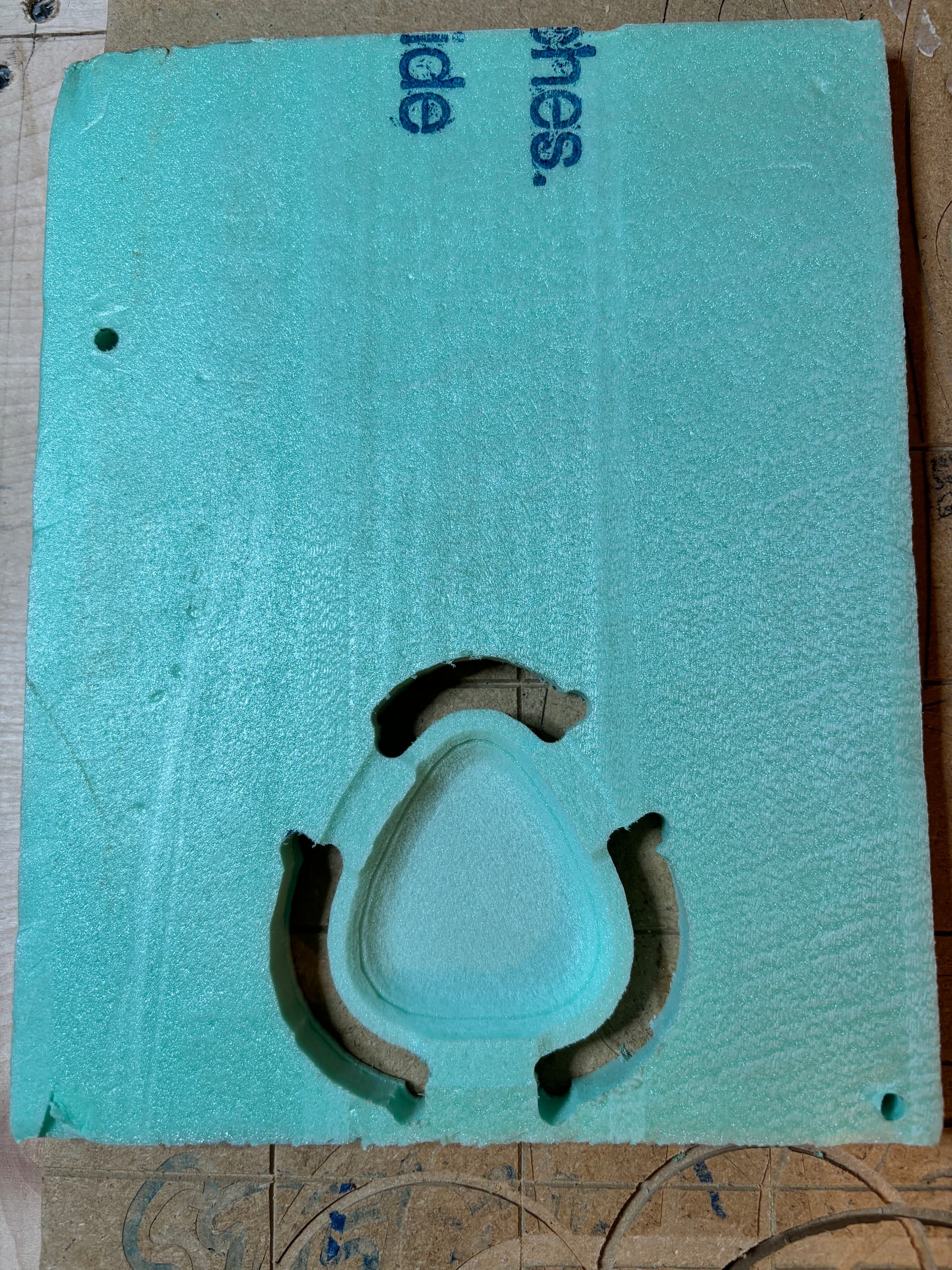

Here is Side 1:
[Note the cut in in the lower left corner. Of all the tests I’ve done, this still happens, but only with the Side 1 cut. I haven’t looked at the gcode yet, but I just used the Estlcam prompts to set things up. So I think this is part of the feature. Note to @christian-knuell ]
and Side 2:
I still have to play with the machining strategy for the roughing pass and finish pass. I think I’ll stick to waterline for both (less sanding, I think).
I also noted that for side 2, it did a LOT of air-cutting around the outside edge where it was already cut out from the side 1 cutting. I’m guessing that is because you’d want to make sure both sides are cut out and not just ‘connected’ on the sides to the raw material.

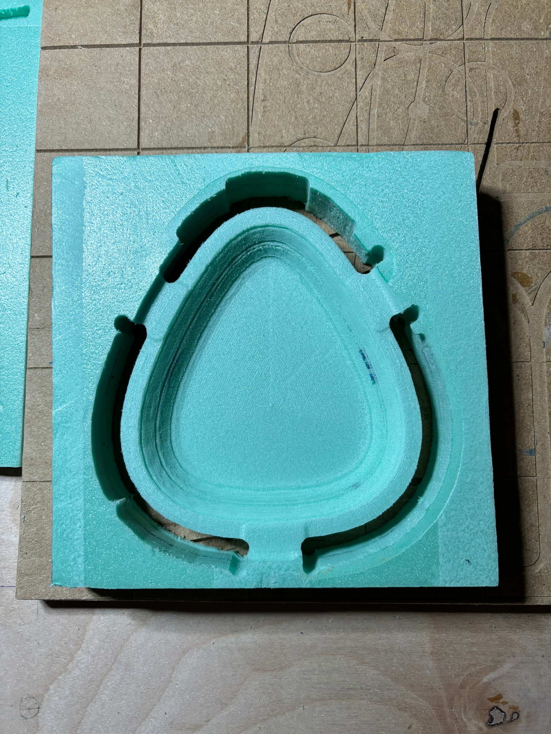

Well, I noticed there were a few updates to EstlCAM and I updated. Now the initial dive in doesn’t happen. Still a lot of air-cuts, but I can understand that. I think doing the waterline was the best machining strategy, so I’ll stick with that. This is the result using version 12.100C
Bottom (1st job)
Top (2nd job)
(there does seem to be a line/rough spot inside the bowl. This is because I had to glue two pieces of foam together to get it thick enough for the job. The glue started to give out and that is why there seems to be a line/rough spot.)

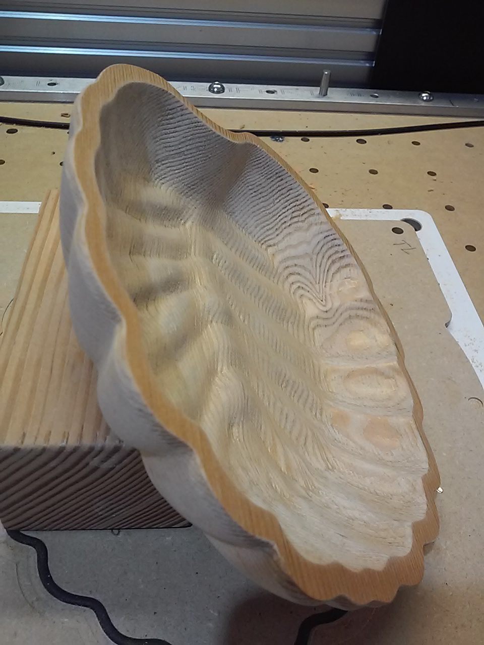

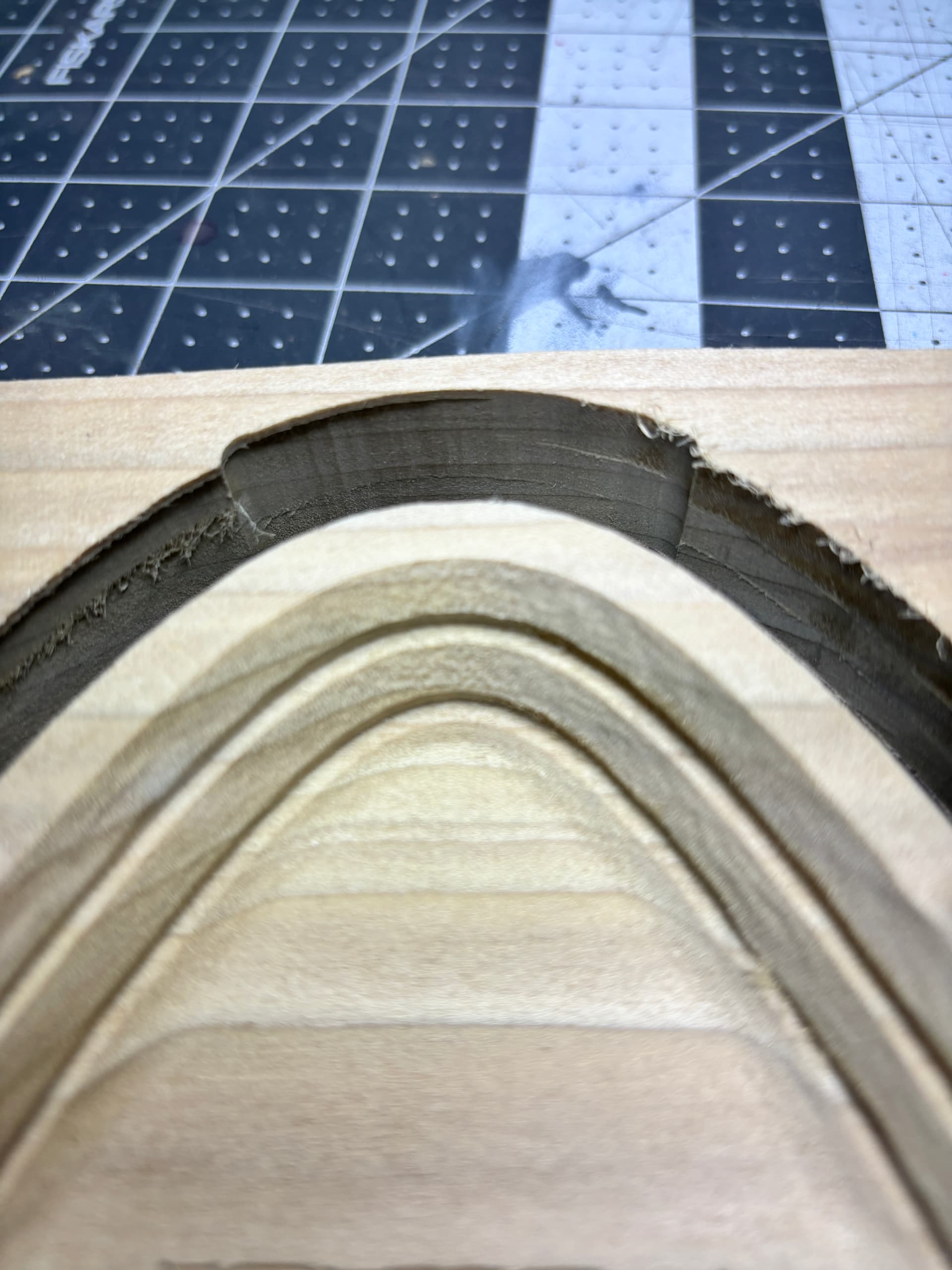

Finally decided to just do the job I wanted in wood (poplar). It took my 3 tries. The 1st two were messed up by me. 1st when I had a logo carved in the bottom inside, I forgot to just have the router raise up and stop. Instead, it raised and then it went home and cut right through the side of the bowl. 2nd time I forgot to add tabs. 3rd time worked.
But, I think there is still an issue with the 2-side cutting using a STL file.

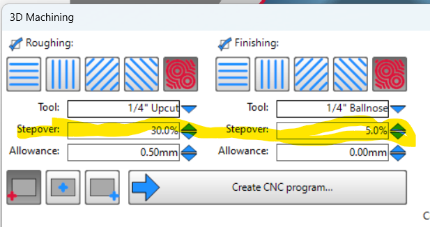

@christian-knuell Christian, It seems there is an issue with this feature. I’m not sure what the problem is. It seems maybe the calculations for the 2nd side uses the ‘Stepover’ from the tool list instead of the stepover that is provided in the 3D machining window.
Screenshot 3d machining
The above is what I selected as my stepovers and my tool list has the default stepover as 40% with the 1/4" Upcut and 80% for the 1/4" ballnose.

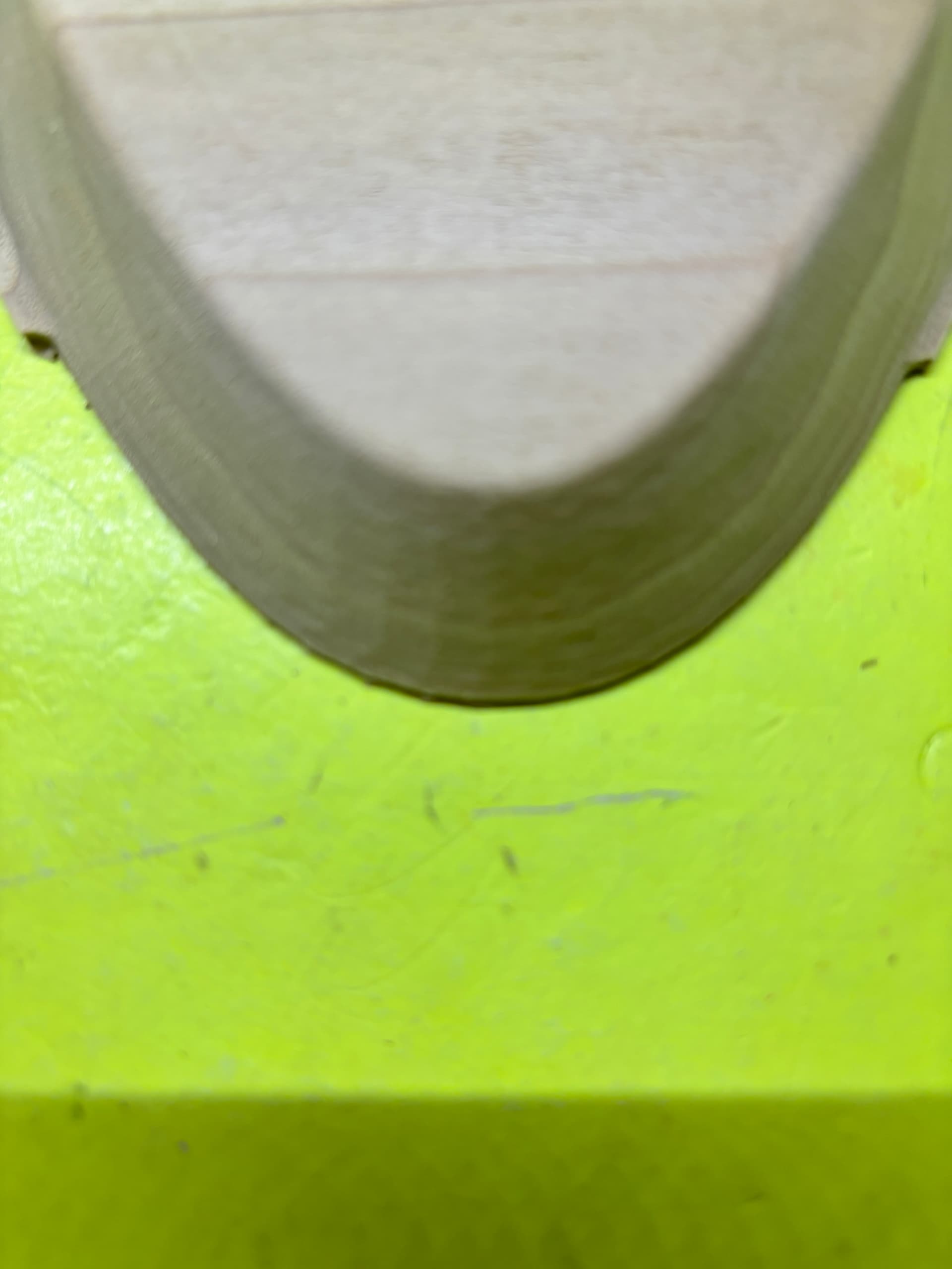

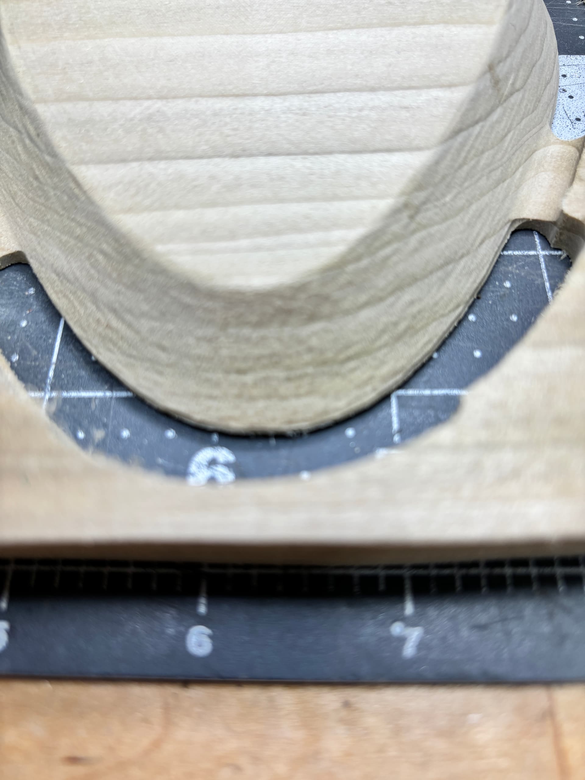

On the 1st side (bottom of the bowl I was cutting), the sides came out nice:
…but the 2nd side (inside the bowl), the sides came out as steps - as if the 1/4" upcut bit was set to a larger stepover (maybe the 40% as my tool list showed me):
Is there a bug here? This was done using EstlCAM v12.101C (I see now that there is a 12.102 version, where do you keep the version log so we can tell what changed?).

I’ve only done 2 sided 3D with the v11 solid of revolution, but I would try rotating the opened STL so that the inside of the bowl is up and gets machined first (material top Z0). Assuming you’re accurately resetting Z0 at the same spot after tool changes I would hope that the inside of the bowl would be clean - no leftover groves from the roughing pass and no funky raised tab bits extending onto the face of the bowl rim (neither is a stepover issue).

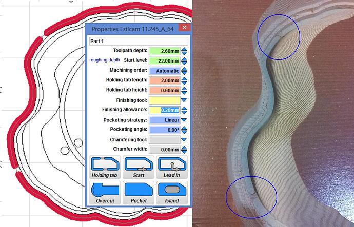

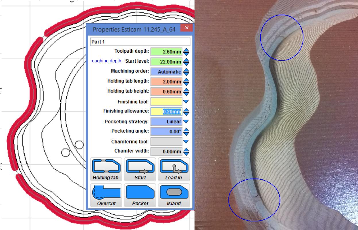

Setting tabs seems to work best when the clicks are made outside the margin, when clicking along the perimeter they can extend inside the perimeter which may explain the tab bumps on the top of the bowl rim (foam images).

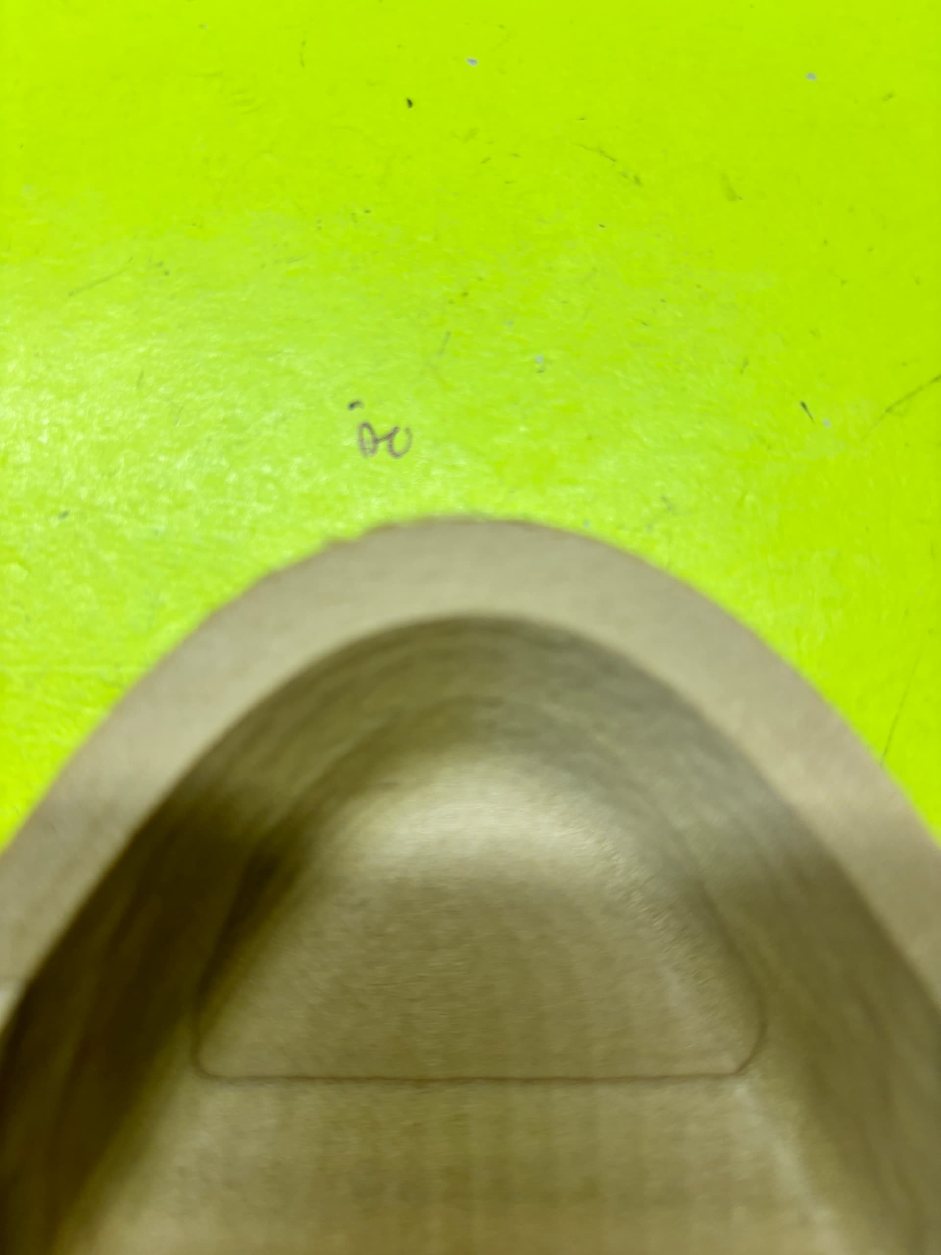

Thanks. your method worked fine. That project is done (from a CNC stand point). Now I need to do some finish sanding, sand the tabs down and smooth, and paint/stain the bowl.
It does look like there is a line, but I can’t feel it with my finger or fingernail. It should work it’s way out when I do a finishing sand. Happy days again! :grin:

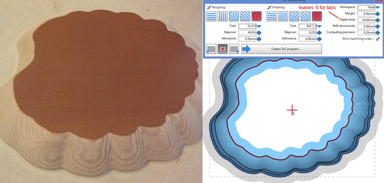

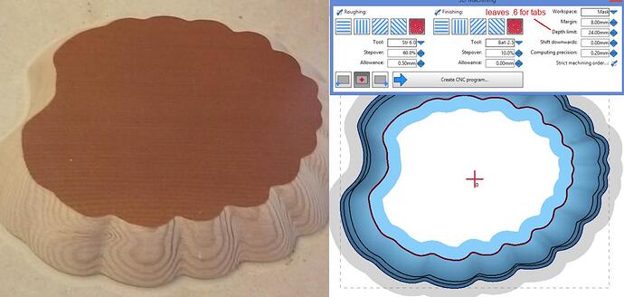

Actually, Free machining allows masking and the mask file can be used to do a separate tabbed perimeter path. A Depth limit needs to be set so that the 3D won’t go through. The tabbed path Start level is the distance from the surface to the already cut roughing depth.
My primary purpose for using a mask was to avoid having to unnecessarily machine the flat. I don’t know if it’s a bug, but when a perimeter Margin is needed a margin is added to the masked area and the G-code has to be manually edited to get rid of it :frowning_face:.
Mask files are easy to create using the v12 3D Covert to 2D Drawing > File : Edit drawing. With a mm STL and (Setup : Basic : editor set to) Inkscape it’s Manual scale (mm) > Save as (default svg, no changes/edits required). The only twist is that the SVG needs to be opened (Workspace > Mask) as Pixel 96dpi (Setup : Basic : Length unit = Ask).

I achieved what I wanted. Using a mask reduced bottom machining time by something like 75%. That the tabbed path worked was just a bonus, something I tested for the community.
