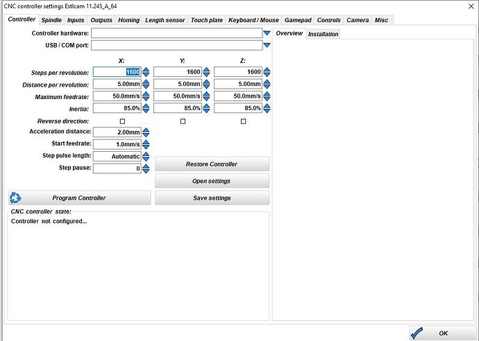

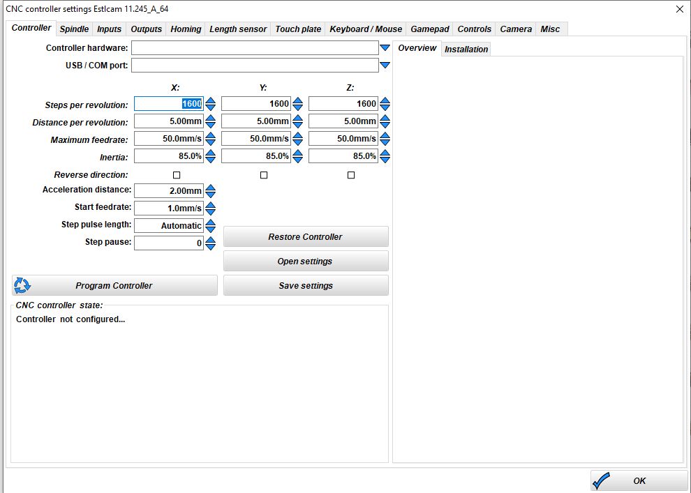

I have my LowRider up and running now and have managed to print the crown (Test-Crown-12mms) downloaded from this site.
I have been trying to follow the instructions to generate my own gcode for the same crown again using Estlcam II from the 0102.dfx file, again form this site.
I have followed the instructions carefully but when I load this up to my LowRider and press start the tool just bottoms on the z axis.
As it is working ok with the test file, it must be something I am doing either in Estlcam II preparation or how I have set up .
Can anyone help please?

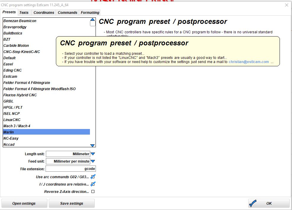

What could be the problem is that in the Basic Settings the “Feed unit CNC programs” and “Feed unit Estlcam” are different. I think the way it is setup now you are saying that it should move 15mm/s in Estlcam, in the Gcode it writes 15mm/min. Might be a start at least. :smiley:
That is fine for Marlin.
This was going to be my guess. Did the premade gcode test crown work for you? That has a G92 X0 Y0 Z0 at the top.

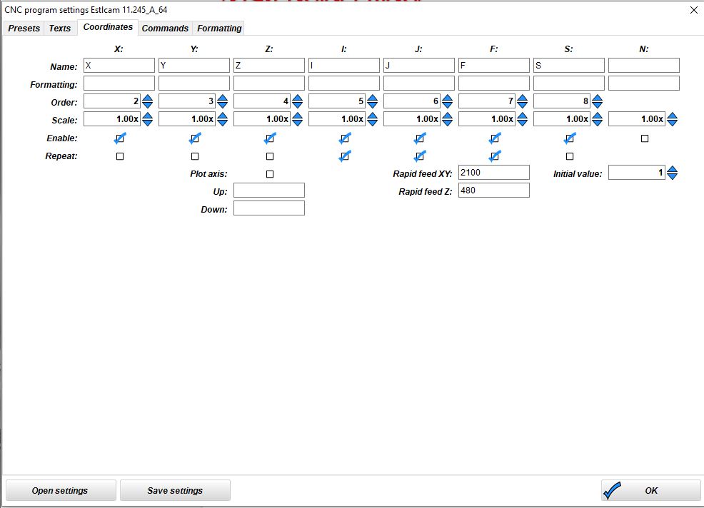

Ah, I thought that might be the case
So when you home everything it sets x and y as 0,0 and Z as 200 - up out of the way.
The thing you have to do next is tell the machine when the tool or pen is touching the top of the workpiece/page - THAT is Z at 0
How you do that depends on if you are using a touch plate but essentially you move the z down so it’s touching and then send a command to set that as 0
The command is G92 Z0
This can be sent using the terminal from the lcd, from software or included in the starting script of your gcode file
Thank you for getting back to me. I did this and it certainly stopped the machine crashing into the work piece, but it only made a couple of short moves then locked up. I ran the premade gcode test crown file, and again that works perfectly, so I suspect it’s a problem with how I am compiling the gcode file in Estlcam II.
In all fairness I would certainly like to understand what I am doing wrong, then at least I can gain a better understanding of CNC work. Saying that I can use Fusion 360 reasonably well so would this be a better alternative to Estlcam II?
Thanks again
Estlcam is MUCH easier to set up and use than fusion in my opinion.
I agree it is much easier that the vertical learning curve of Fusion CAM setups. Once I added these lines to the set up text it works really well now.
