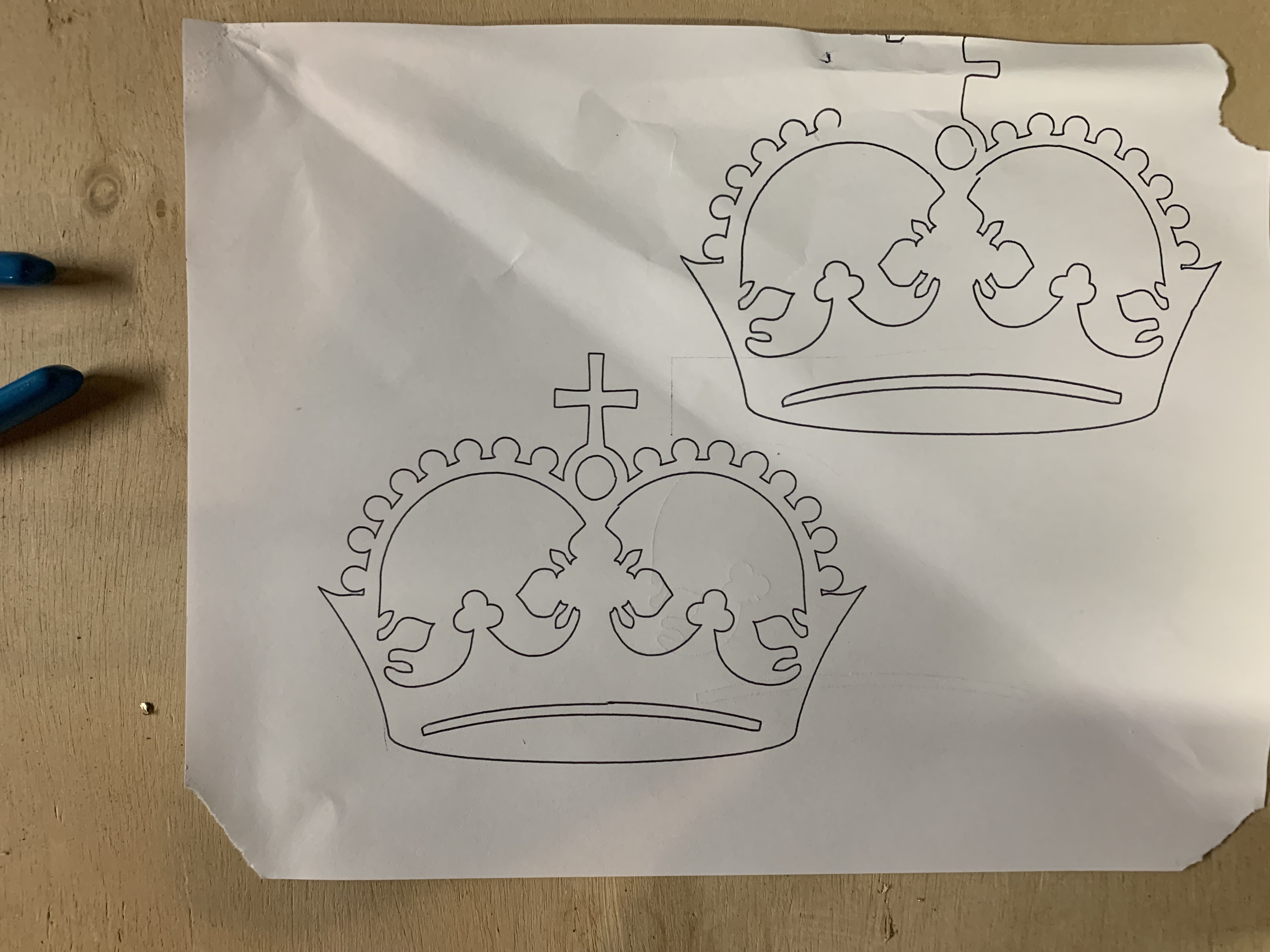

I have my Primo all built and its moving!
I am installing software (Estelcam) so I can attempt the crown test but I have a question. I am unsure which version of Estelcam to download. There is a 32 and 64bit version. I have a Primo with an SKR board purchased from the V1 shop and am using a Mac if that matters.

https://www.v1engineering.com/wp-content/uploads/2015/09/Test-Crown-12mms.gcode
Thanks for the Gcode file I was able to put that into repeater and save it to an SD card and print out a few crowns!
I think they came out okay…
