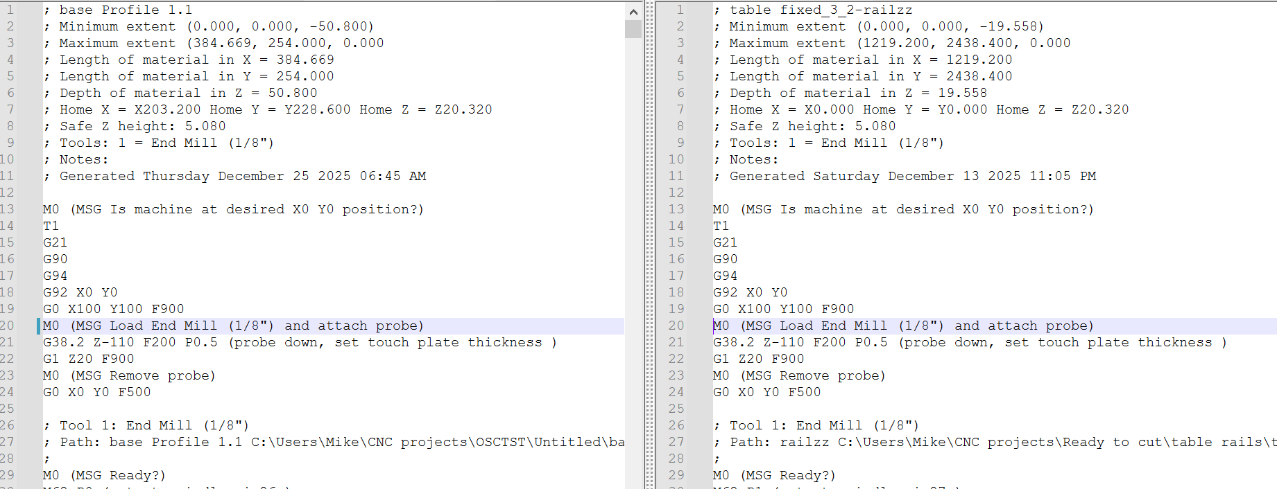

ERR: 2 (Bad GCode number format) ALARM: GCode Error ALARM:17
Gcode created in Vectric software.
Using the PP posted here
https://forum.v1e.com/t/vectric-post-processor-for-lr4-grbl-jackpot
The relevant line in the PP
"M0 (MSG Load [TOOLNAME] and attach probe)"
Here is the Error and $SS output
ok$SD/Run=/CNC/base Profile 1.1.gcode
[MSG:INFO: MSG,Is machine at desired X0 Y0 position?]
<Hold:0|MPos:3.000,403.000,3.000|FS:0,0|SD:1.07,/sd/CNC/base Profile 1.1.gcode>
[MSG:ERR: Bad GCode: M0 (MSG Load End Mill (1/8") and attach probe)]
[MSG:ERR: 2 (Bad GCode number format) in /sd/CNC/base Profile 1.1.gcode at line 20]
[MSG:INFO: ALARM: GCode Error]
ALARM:17

I figured out that the error was caused by the nested parentheses around the tool size. If I manually remove only that nested parentheses it runs fine.
Whats really got me confused is that line has been in every gcode file that I have ran that was produced by vectric and it has worked prior to today with no issues.
The file looks correct if I load it into NC viewer and I don’t seen any errors on the output.
I did update FluidNC from what shipped on the JP1, 3.7 if I remember correctly, to 3.9.9
Any insight on what could cause this? Was it the update to a new version of FluidNC?
I don’t think it’s relevant, but I updated to WEBui v3, and successfully got Jason’s joyjog & holdmontior panels working.
New problem code on the left, code used to successfully cut table rails on the right.
:thinking:
Edit to add: I just went back and read through my build post and I updated to FluidNC v3.9.9 before I cut the table rails, so it looks like that is not the cause…did I bump the wrong line in the config or something?

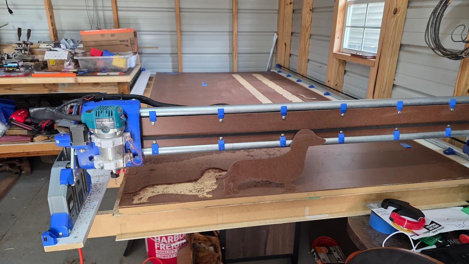

I’m still not 100% sure why it was not causing problems in the beginning with the original PP, though what worked for me was editing that file to include this line, which substitutes the parentheses with curly brackets.
SUBSTITUTE = "({)}"
Made a successful test cut and it worked with no errors.
Here is the working vectric post processor should someone else find it useful.
Lowrider Grbl (mm).zip (2.3 KB)
And an obligatory photo of the cut :grin:
