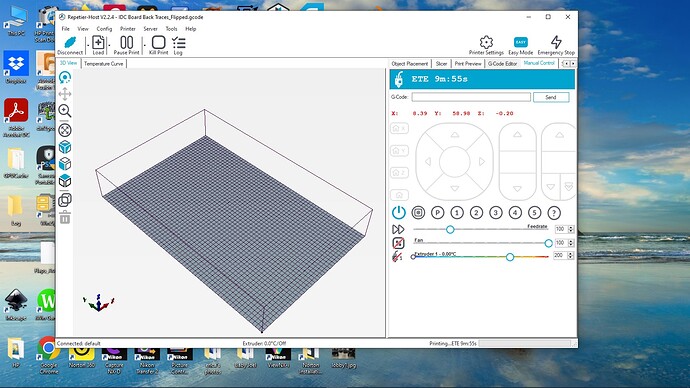

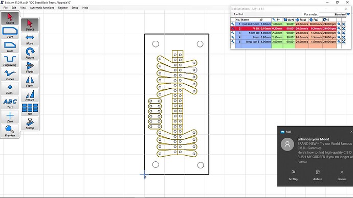

I started a different board today, much more simple. It measures 32mm x 70mm. Estlcam Work Area is set the same size and Grid is set at 10mm x 10mm.
I opened it in Repetier-Host, homed x & y and set the V-bit touching the board, disconnected and reconnected Repetier so x,y,z all show zero. The first part of my gcode is:
G90
M03 S24000
G29 X0 Y0 Z0
G00 Z2.0000 F480
;No. 1: Engraving 10
G00 X16.5080 Y9.9147 F
G00 Z0.5000 F480
G01 Z0.0000 F9 S24000
G01 Z-0.2000 F9
G01 Y61.7662 F1200
G00 Z2.0000 F480
;No. 2: Engraving 17
G00 X19.1608 Y58.3444 Z2.0000 F
G00 Z0.5000 F480
G01 Z0.0000 F9
G01 Z-0.2000 F9
G01 X13.8248 F1200
G00 Z2.0000 F480
but when I start the Print the V-bit moves to these coordinates for ;No. 1: Engraving 10:
I don’t understand why.
so I think your zero is not working. I believe it should be G92, not G29
Yeah, g29 is bed leveling
Oops, you are right. I copied and pasted that from an old text file that wasn’t corrected. Thanks, Riley
Well, I changed it to G92 and saved the file but it did the same thing.
Jerry
so with G92, you need to have the machine oriented to the lower right corner and touching the board when you issue G92 x0 y0…
Did you do that?
Just realized the stupid mistake I made. I turned the board 90 degrees from the direction I intended too. There are too many things for an old man to remember.
I started over with a new board and it seemed to be going right this time although it seemed to be cutting a little deep. Then my V-bit broke. I accidentally put 1mm instead of 0.1mm for the cutting depth. Now I have to order a new bit and wait for that!
Jerry

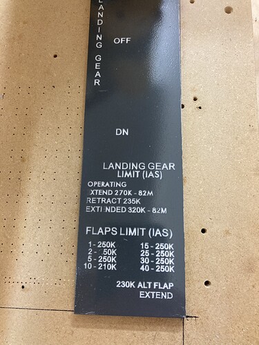

Here is my first attempt at engraving text. The work piece is 60mm x 325mm. I’m using the V-bit with these settings: Tool Diameter 0.10, Depth Per Pass 1.0mm, Plunge Angle 90, Feed Rate 20.0mm/s, Plunge Feed Rate 0.2mm/s. 24000rpm. Cutting depth is set at 0.3mm. Its taking a really long time, partly because instead of engraving a whole word it will engrave one letter, then move way across the board and engrave another letter then back again. I don’t understand how to make it engrave whole words at a time. What causes it to skip all over the board rather than doing everything in order. I don’t understand how Estlcam arranges the cutting order or if there is a way to adjust it. Also, after it engraves letters it comes back and pokes at them and I don’t understand why its doing this. Is this some kind of finishing pass?
All in all, the depth of the engrave seems to be about right. However, it just barely cut the 2 on 2 - 250K and the E in EXTEND 270K - 82M.
I was happy with the final result. This was just a test piece. It took an hour and 40 minutes which seems way to long for a 0.3mm cut. Maybe someone can tell me how to make some adjustments to shorten the time.
Hmm, I’m not familiar with estlcam, but it sounds like it may have been cutting each depth separately… like several 2d pockets ending at assorted depths, instead of 3d toolpaths. So the tool would have to lift, move, drop into the next spot, finishing a ‘layer’, then dropping down to dot off here and there for the last layer. This would explain jumping back and forth cutting each character more than once… and also why it would take so long because it’s doing step downs and doesn’t have to.
I use f360, which has an operation called “engrave”, where you select just the top edges of the letters, and it makes 3d toolpaths to cut them out. The result is the bit plows through each part in one shot, changing depth as it goes to keep the desired shape of the top edge. This way the cut goes very quick and clean… I figure like 10-15min for something like you have there. Maybe estlcam has a similar feature?
Now, that missing 2 in the 250K? …ugh, also a line through the E on extend and extended. Are those spots where the sheet has a dip? Hard to see in the photo. If so, even with something like bCNC that would take a really dense grid of probing points to zero out. My guess though is it’s not the material… probably just some mechanical bumps here and there… bearing hurdling over a chunk of junk on the tubes… z screw snagging on a greasy spot… cat jumping off the gantry in the middle of those characters being cut. It doesn’t take much to mess up engravings, and those spots are too random for me to say anything more conclusive based on photos.
edit: Also saw your question almost a month ago… yes bCNC will work with a RAMBo v1.4 controller, but only if it is running grbl firmware. Unfortunately bCNC is meant for grbl, and does not support marlinfw. This is another item to motivate folks to use grbl instead.
