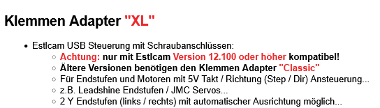

Rocketronics has the new Estlcam Terminal Adapter XL and it looks like Timos has their version of it available as a module (Estlcam Terminal Adapter XL) for their CNC Shield 2.
…The Timos doc says the module is “only compatible with Estlcam version 12.100 or higher!” which is a deal breaker blanket statement instead of a to be expected ‘some features/functionality require v12’ one. Neither Estlcam or Rocketronics say anything about the new hardware being incompatible w/ v11.
Of those three, ONLY the Open CNC Shield can do autosquaring with 5 motors via an integrated ESP32. The others use EstlCAM 12’s new feature of autosquaring, but that only includes X,Z and 2Y. So those boards are not an option.
Only Timo’s new Estlcam adapter does not work with EstlCAM 11, the old one with the Arduino still does. Neither the Klemmenadapter XL nor the Rockettronics board work with 11 either.
As in v11 cannot connect to the firmware (which TTBOMK remains unchanged) when it’s on an AVR64DB64 microcontroller (new Estlcam boards)? If so, that Estlcam page should be titled Estlcam v12 open source hardware and I’ll take a hard pass on it.

I don’t know how they are called, but the new boards only work with Estlcam 12. It’s been explicitly stated on Christian’s page as well.
Rocketronics is not mentioning it and only link V12 though.
Timo’s page also says so and links to the old version if you want to use 11 and 12 (and don’t need the autosquaring of 4 axes):
The only English webpage I’ve seen that mentions incompatibility is on the Timos site, but after downloading the Estlcam project .zip file I found the following on line three of the README:
Requires at least Estlcam Version 12.100 - older Estlcam versions won’t recognize the new boards.
