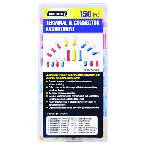

So i was looking at these but I am not sure if they have the right size:
I can’t say for sure, but I believe it would be the Red ones in that pack.
Short answer is no, and I wouldn’t trust that style of crimp anyway.
Long answer:
Those red ones are probably fine for the larger size microswitch, but I think all the ones used here will be the smaller size that needs smaller terminals.
Usually the quick connect terminals (spade terminals, fastons, etc.) are sized by width and thickness. The ‘standard’ size is 1/4" / 6.35mm wide by 0.032" / 0.8mm thick. That’s what will be in that kit.
