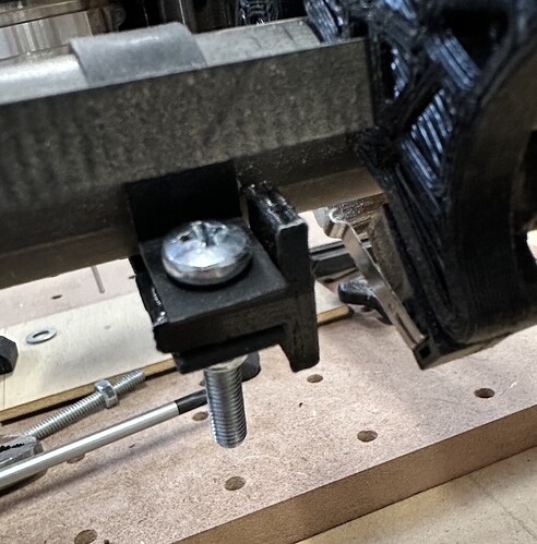

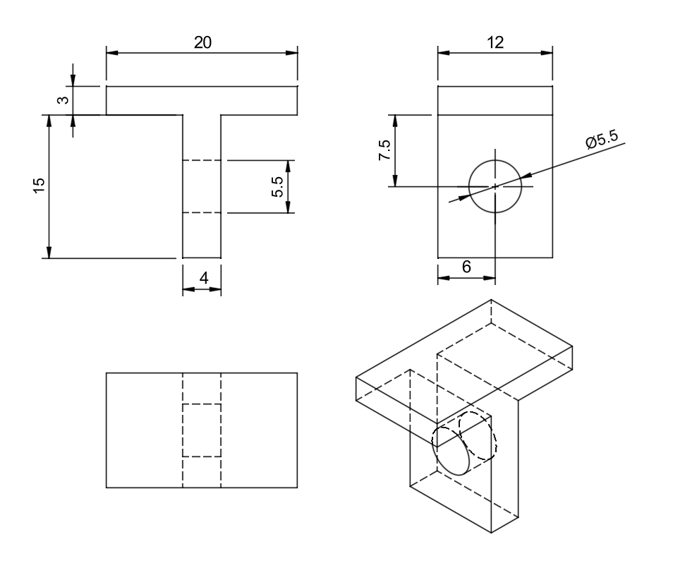

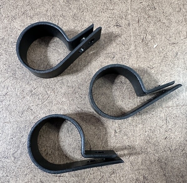

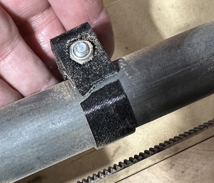

Today went to use my Primo and found that 3 of the four stops for the dual end stop system had broken (see photo). That is, the little clamps that the limit switches hit. This seems to be the most fragile part in the system so I decided to replace them with something mostly not 3d printed. I happen to have a handful of one inch cable clamps (my pipes are one inch). I printed a set of T shaped items that the clamp will hold and provide the target for the limit switches. It works great and as the band is injection molded it should not snap like the printed ones. The pictures should explain it all.

those broke on mine as well. I figured it was from being in the garage at subzero temperatures… easy enough to reprint, but your solution is a better long-term fix.
Same here. :slightly_smiling_face:
I had multiple break as well so I ended up wrapping a hose clamp around the broken piece and tightened them down. Lol. My solution worked but I like your idea better. :grin:.
Me three.
I thought about hose clamps also but then I found the cable ties and decided they would be easier. They hold very tight because I played with them and realized my added 3d printed T would work best if it was 4 mm thick. This allowed the cable tie to hold the T but also grip the pipe well. If your pipe or conduit is not 1 inch in diameter you may have to design a different T piece, maybe one that provides a shim for the cable tie.

I believe the PLA ones have an issue being that thin, and people (me included) tend to over tighten them. Then throw in temperature swings in an unconditioned shop/garage and that becomes too much for them
