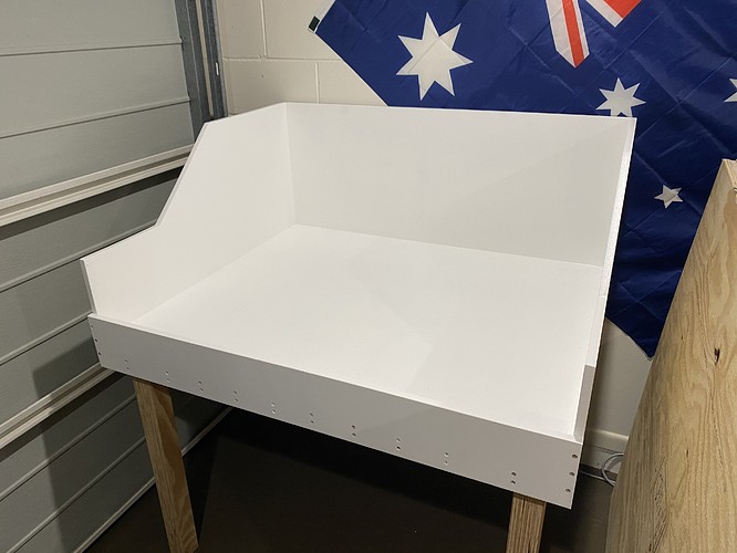

Knocked up the first part of my enclosure over the last few days
It’s built out of laminated plywood for the legs and frame , and mdf for the cabinet, sealed and painted , need to finish the top and lid. It measures in total 1296x972x1162 with an enclosure size of 940x464x1130
For a work area of 600x400x81
There’s enough room left over for sound proofing and what ever else I’ll need , I’ll be adding a small window on top of the one day. The whole point of the enclosure was dust and sound.

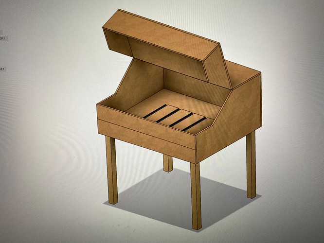

Plans are done up in fusion if anyone wants them
Cheers

Ben, I am exploring enclosure options and would appreciate getting access to your plans/cut list for this build. Thank you
First: Really cool enclosure, congratulations.
In my opinion you should create the opening-part in a transparent way. To see what is getting on on your working area.
Only a recommendation. I had a couple of - lets say - not nice situations/experiences and to not see what happens on the working area, I wouldn’t work with such a tool!
To be honest, too dangerous!
