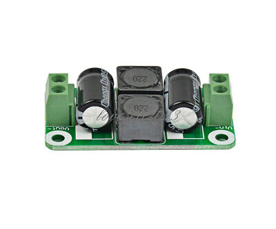

I have an AC filter coming for my controller build, but also wondered if a filter for the DC side might also be an advantage.
The type I had in mind was
Can anyone with experience shed some light on this subject please.
Itā€™s unlikely to be needed unless youā€™re trying to solve a specific problem. Itā€™s also not uncommon for poorly designed EMI filters to cause issues, so Iā€™d be a little wary of adding something like that.
Specifically, that looks like it adds significant inductance to the ground path which isnā€™t necessarily a good idea. Typically filters like that would be of the common-mode choke style, not a pair of differential mode chokes. This will still let common mode through, which is the most common form of EMI, potentially even making it worse by giving you a differential-mode to common-mode transformation at the inductors.
