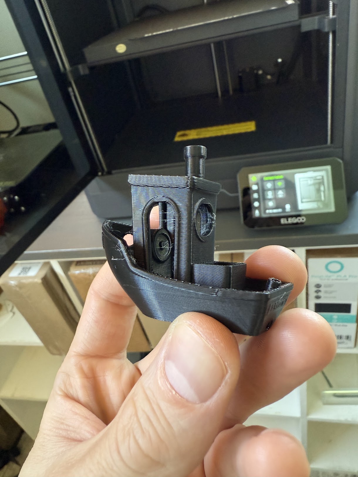

I’ve been 3d printing forever. My first printer was built from parts at Home Depot like 20 years ago. Then I had Prusa MK3s+ more recently.
It took ~10 minutes to take out of the box and power it on. Then another 20-30 of the auto calibration. After that, it printed a 15 minute perfect benchy.
This thing is so fast. This thing is incredible for $300
I used garbage old filament so a little stringy, but this is right off the printer.
