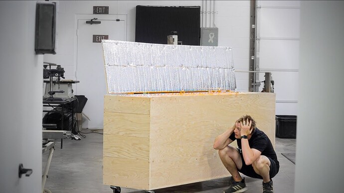

Also, have you considered making a curing oven? Could get you to that curing temp easier.

Oven could be an option but right now I am quite limited in space. I could potentially conceive a box that I put on top of the mold. Have you experience with this kind of setup?

I use laminating epoxy for most of my paddle board projects, they are too big for a vacuum bag and fragile for compression. I have made an oven-type box once and it was pretty straight forward, back then I had a thermostat AC switch that would turn the chicken light on an off at temp. I also used the same silver bubble wrap insulation that is in the video and it is pretty magical to keep in the heat, I also used it for the inner insulation on my sauna.
