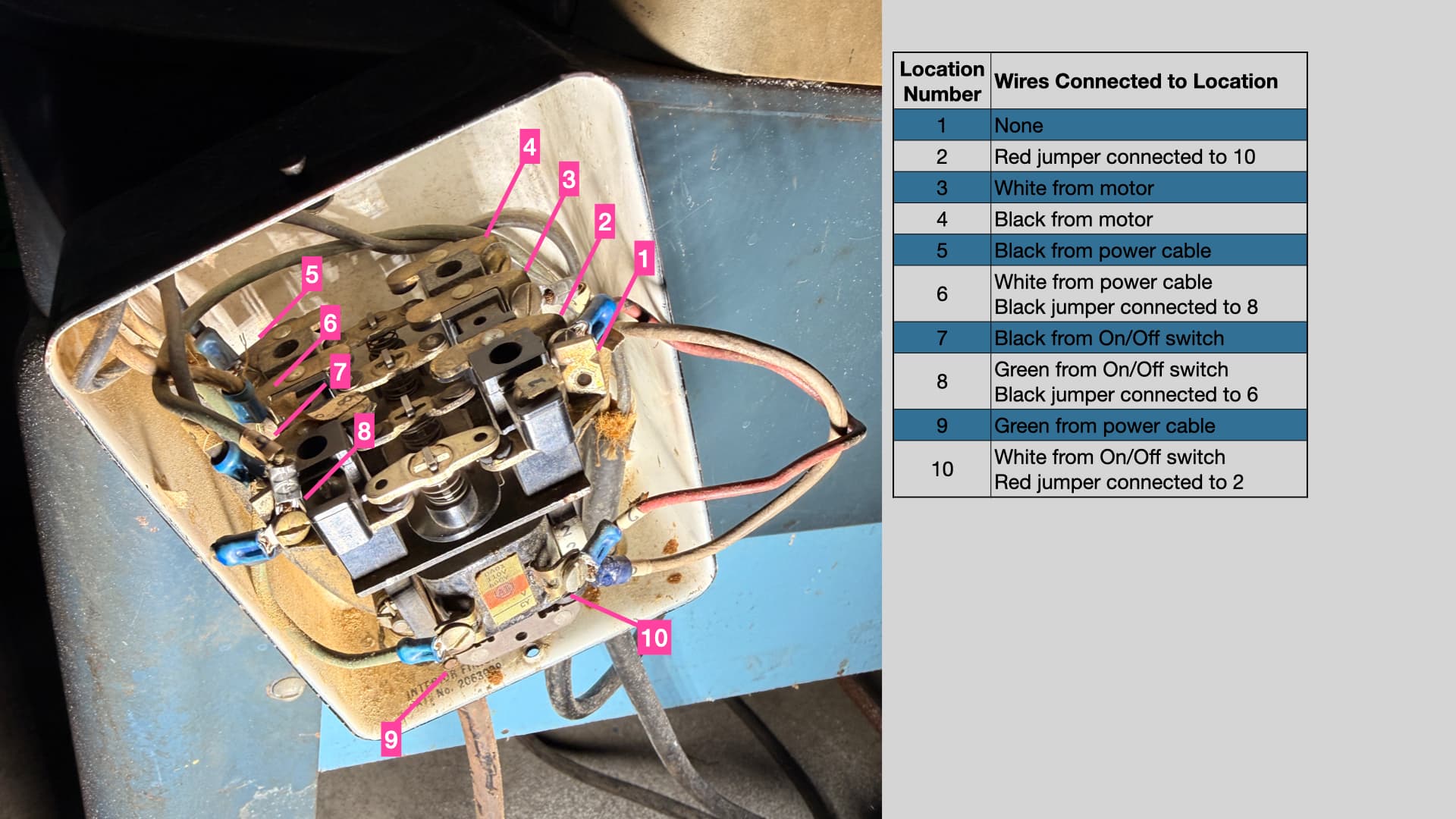

On the mag starter, the left terminal screw on the coil has a green wire attached to it. From what I see it is the ground wire from the power cord. A no no. It should be the white neutral wire. That is probably why the gfi is tripping. This looks suspicious. Without being able to trace the entire circuit, don’t act on my limited observation. If you live close to Gainesville Florida, I can look at it for you. I’m an electrician.
Thanks a lot for your help!! I was able to confirm what you are saying. I studied the mag starter and mapped everything out into the following diagram, hopefully it will help communicate what I should do? For example: “Remove green wire from #9 and attach it to #X. Remove white wire from #10 and attach it to #Y”.
Sorry for not numbering them clockwise, but one of the terminals(?) is physically labeled #1 in the picture, so I felt it was less confusing if physical #1 was also digital #1 lol.

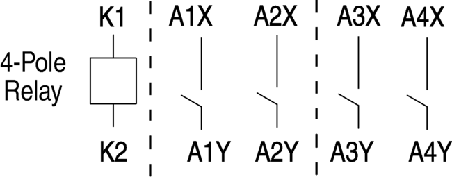

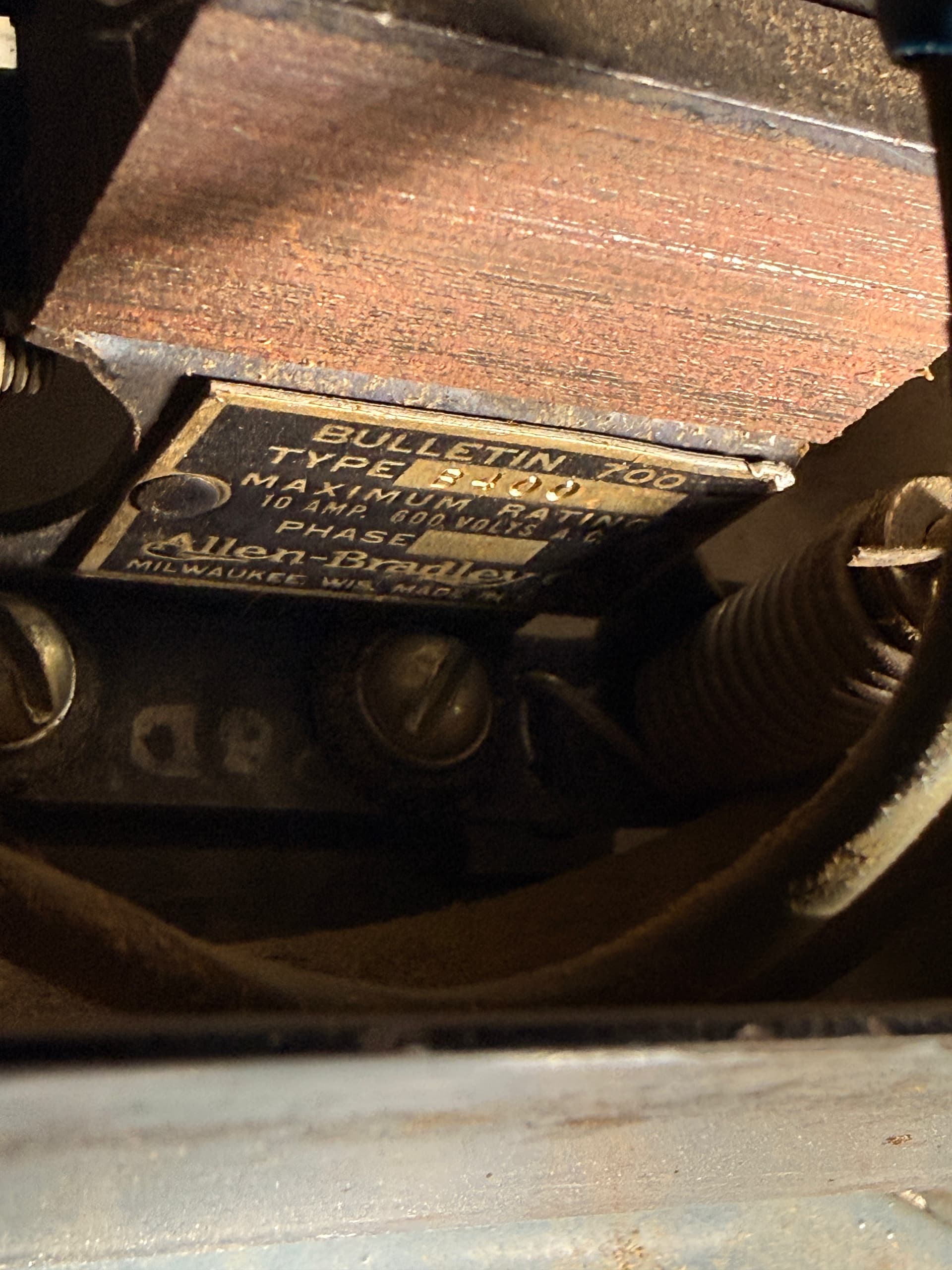

Update: Found the model number info stamped on the side of the mag starter, it’s a Bulletin 700 Type B400.
I found this site, which had the following wiring diagram for the mag starter: https://support.rockwellautomation.com/cc/okcsFattachCustom/get/1055395_4
Will continue digging!

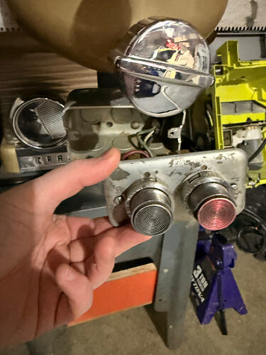

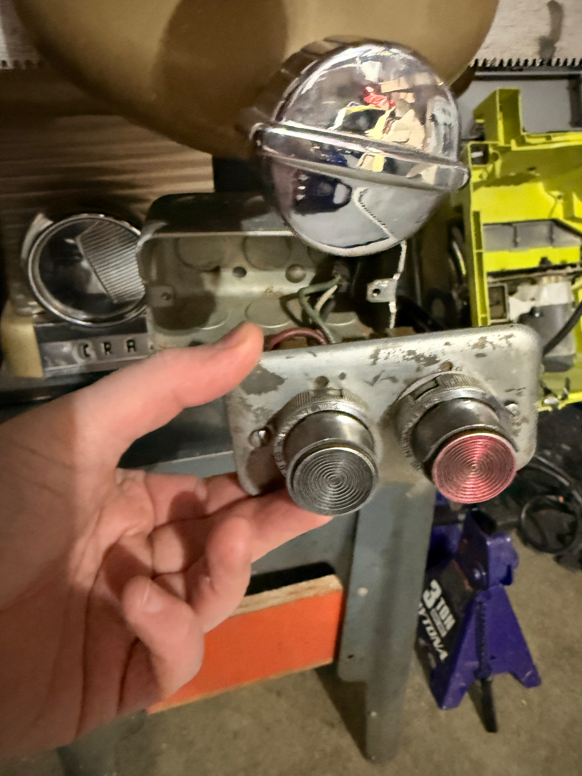

It’s been many years since I have wired a mag starter. Do you have a two button power switch?
Green for on, red for off.
On the mag starter term 1 is normally closed. It should energize the coil when the green button is pushed, then be self sustaining when the started is energized. Can you get the power switch opened and get a picture of the wiring?
I suspect terminal 1 should be attached to the coil terminal with the green wire from the power cord. The green wire should be attached to a ground terminal. Each wire should be verified by examining both ends. Homeowners don’t generally follow standard wiring color codes. That green wire should be on the grounding pin in the wall plug.
Do you live anywhere close to Palatka Florida? I could get you fixed up quickly if you do. If you get some pictures of the switch wiring, that will help.
I REALLY appreciate your help!! I’m up in Toledo OH so a bit of a drive to meet you, unfortunately, but again very kind of you to offer. I’ll get the power switch opened up and some pics of it tomorrow, it is a two button green/red switch.

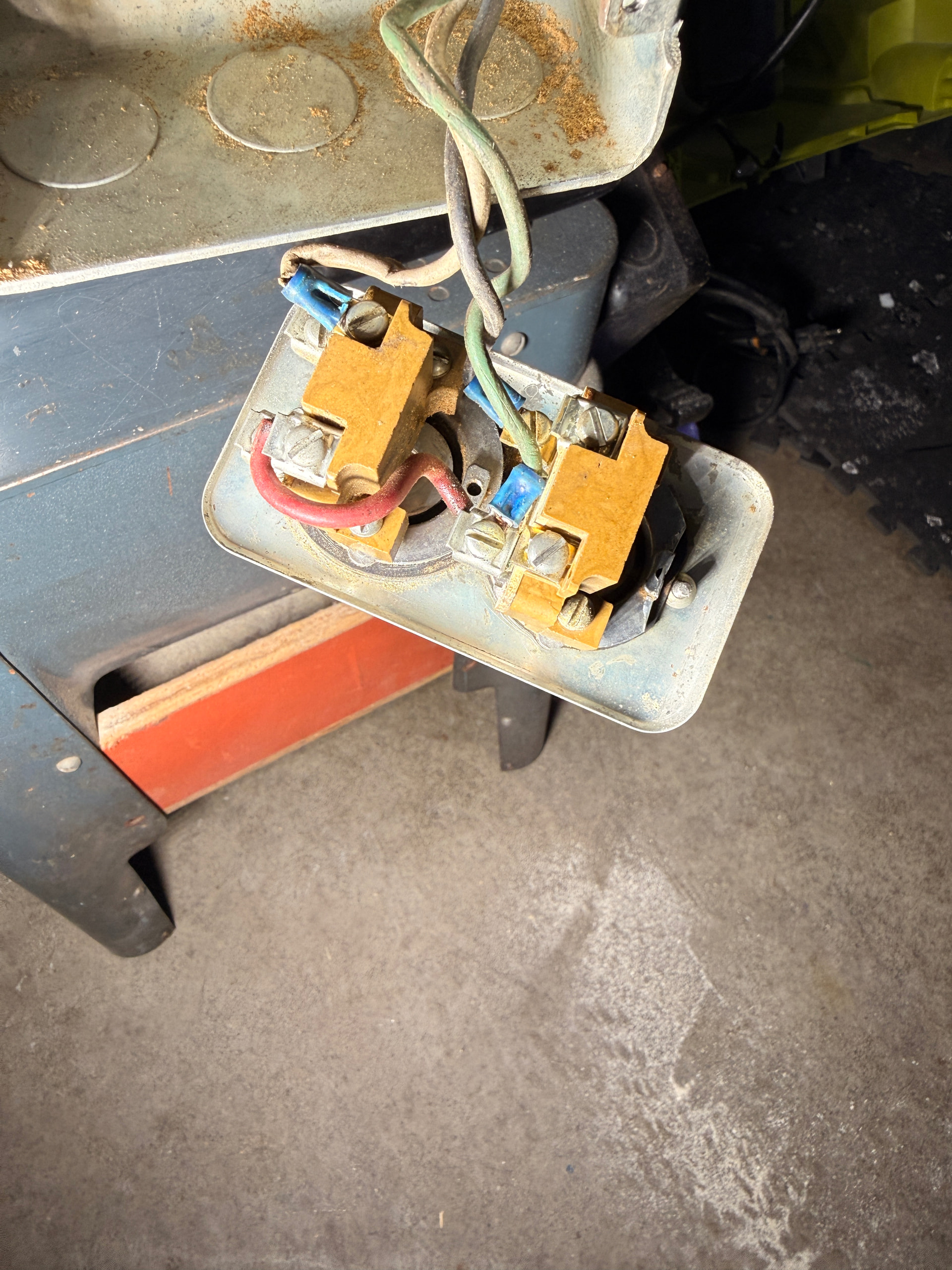

I was able to get some pics of the switch, let me know if I can get any other info for you. Thanks again for the help!
Ok, thanks. I’ll study this and try to figure it out. The green wire from the power cord is a ground wire, connect it to the box. I’ll draw a diagram tomorrow.
