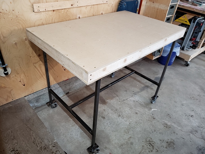

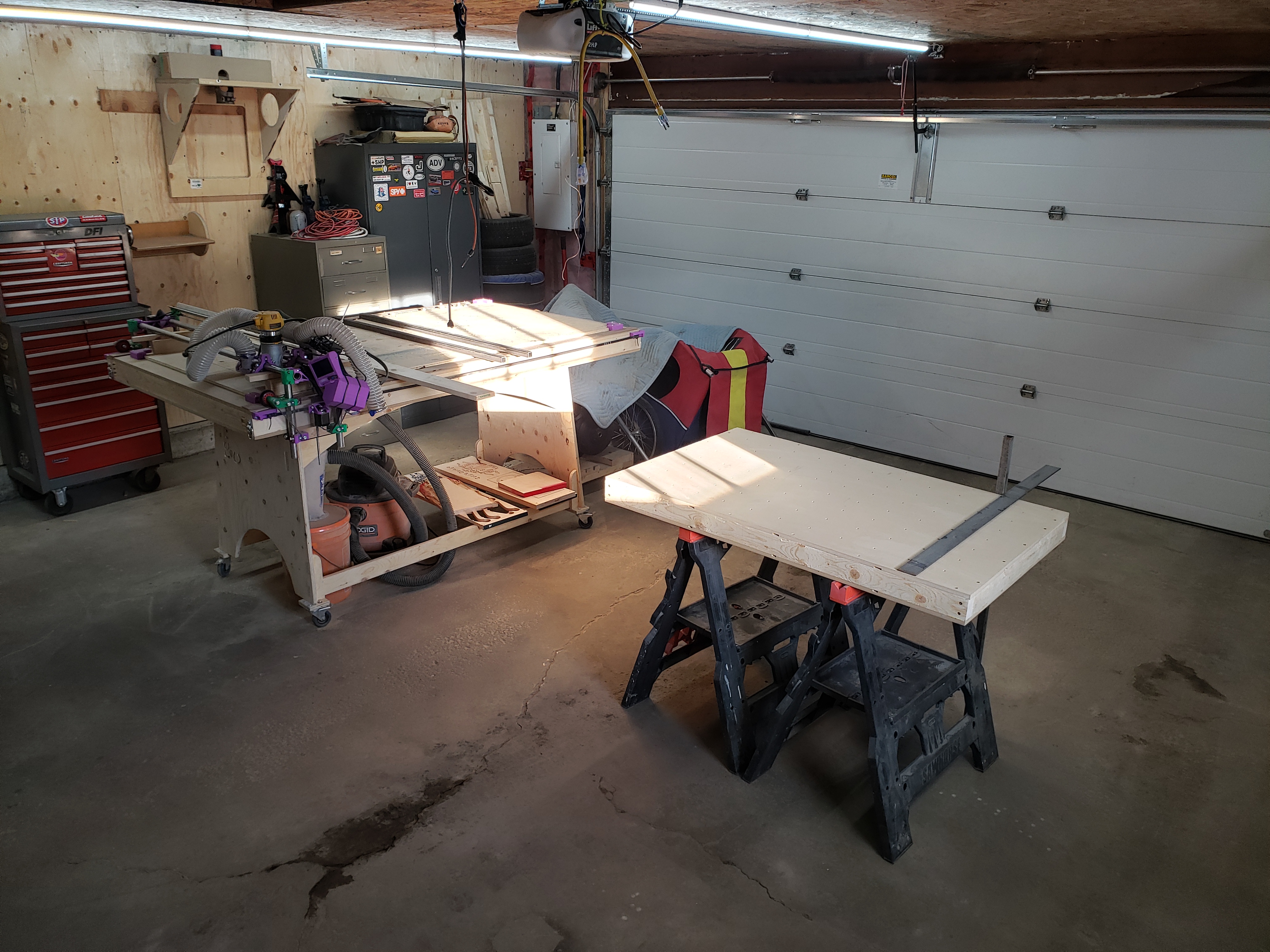

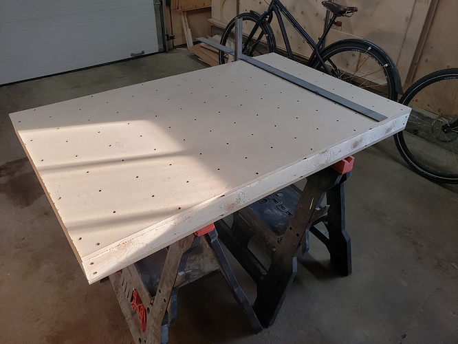

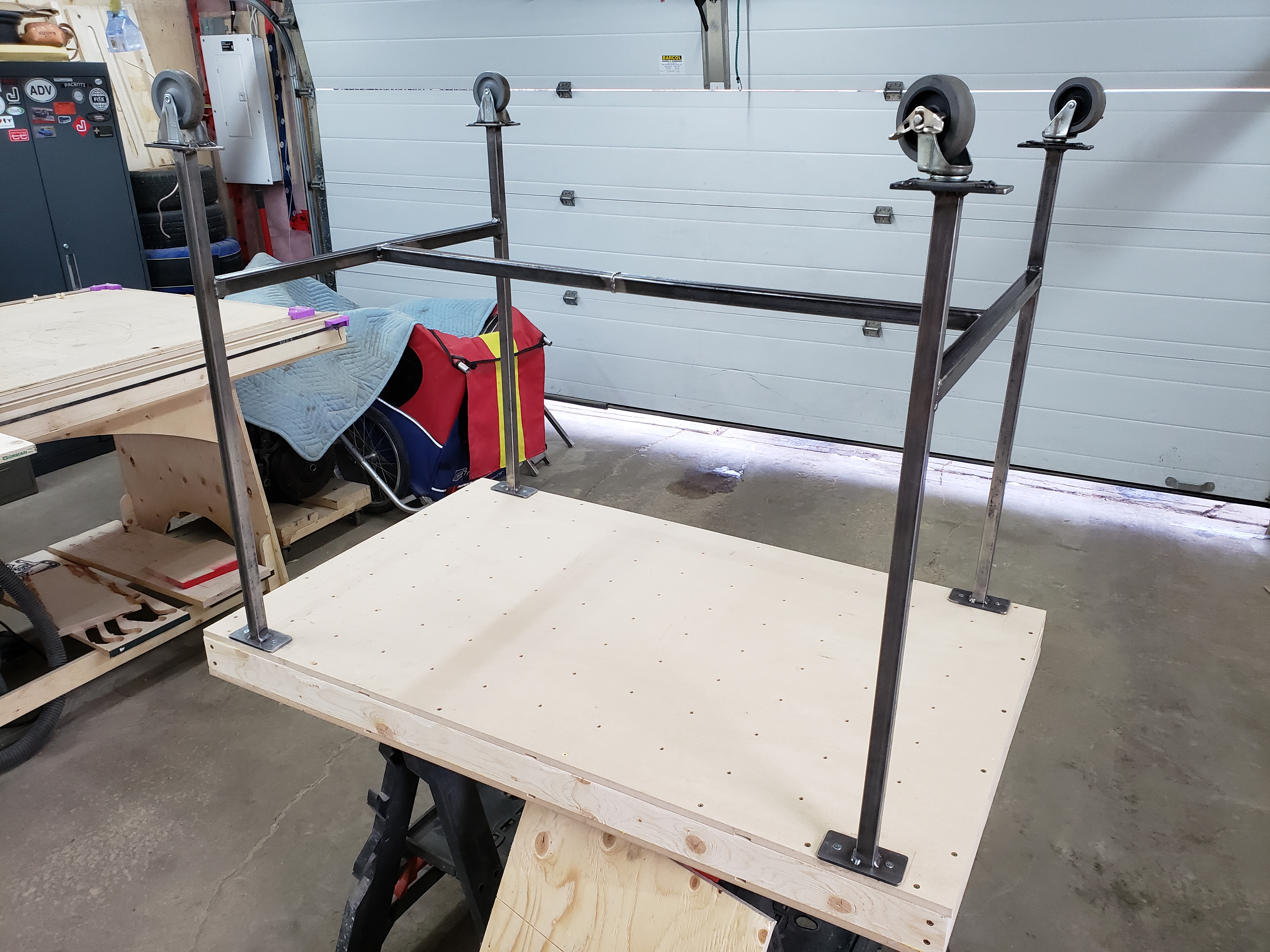

Mini me torsion box is constructed, it’s weird but it feels like I’ve done this before… final revised size is 48" by 30" so my cut area should be a little inside this. The reduction in size is purely for space, and my father in law’s built a huge shop where he intends to put a 5x10 CNC so the full table needs/wants) are covered in the future.

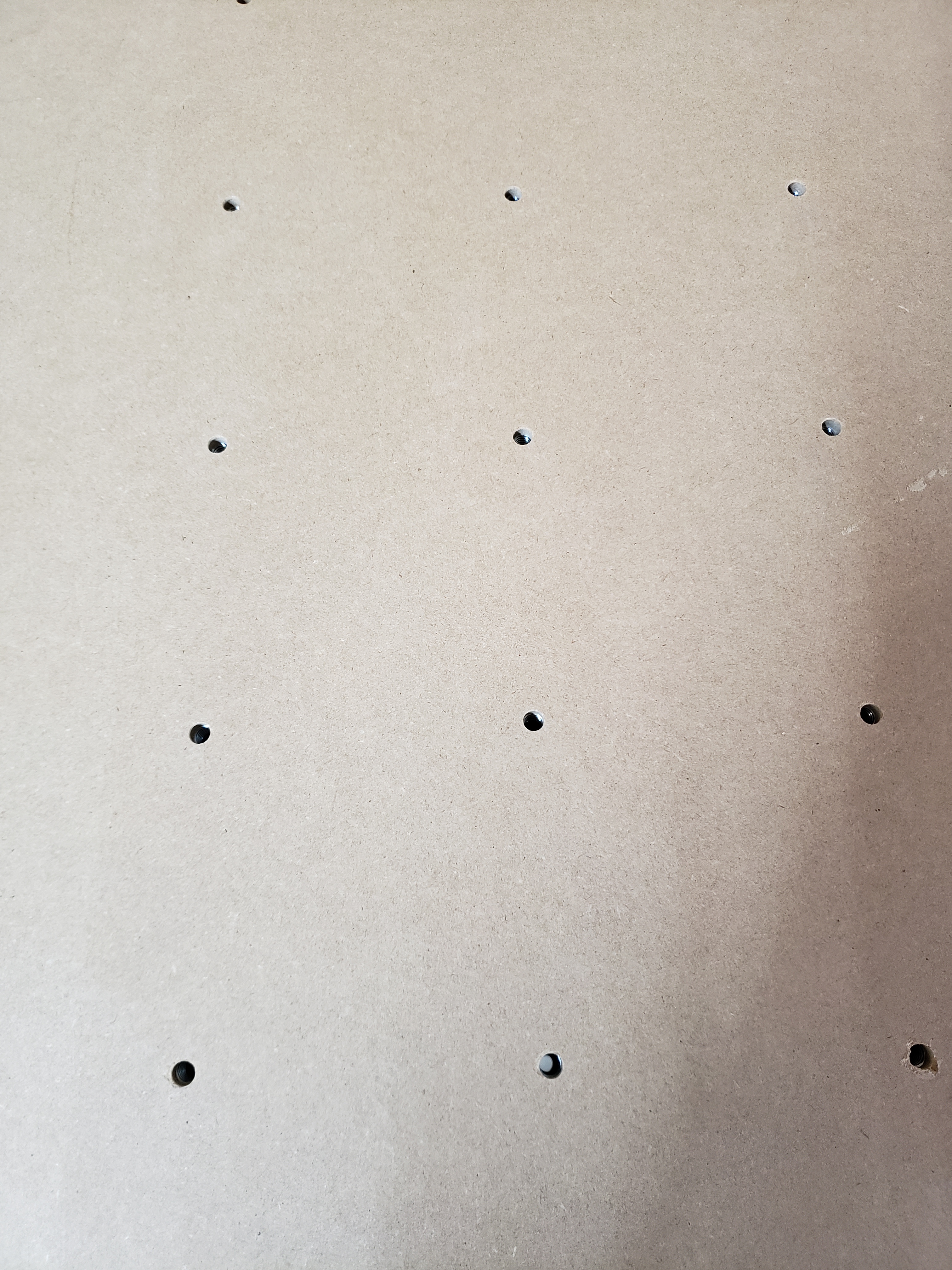

Like before it’s a torsion box design, 1/2" mdf sandwich with same for ribs, and squared 2x3"ish solid wood edges all around. I used my big daddy lr2 to lay out the grid, and the top piece has 1/4" 20 tnuts in every hole for hold down strategies

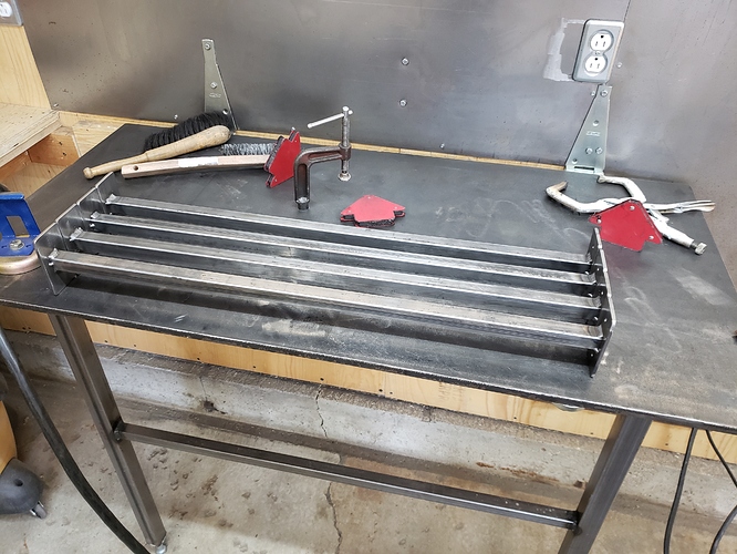

After going back and forth on the support idea I’m opting for mixed media and am welding up a custom metal base which is a work in progress.
Well great success, now just to flip the machine.
This is going to be a great machine size. This is how big mine is, but I want to make it again, with a bit more support, and a better plan for the table.
Looks great!

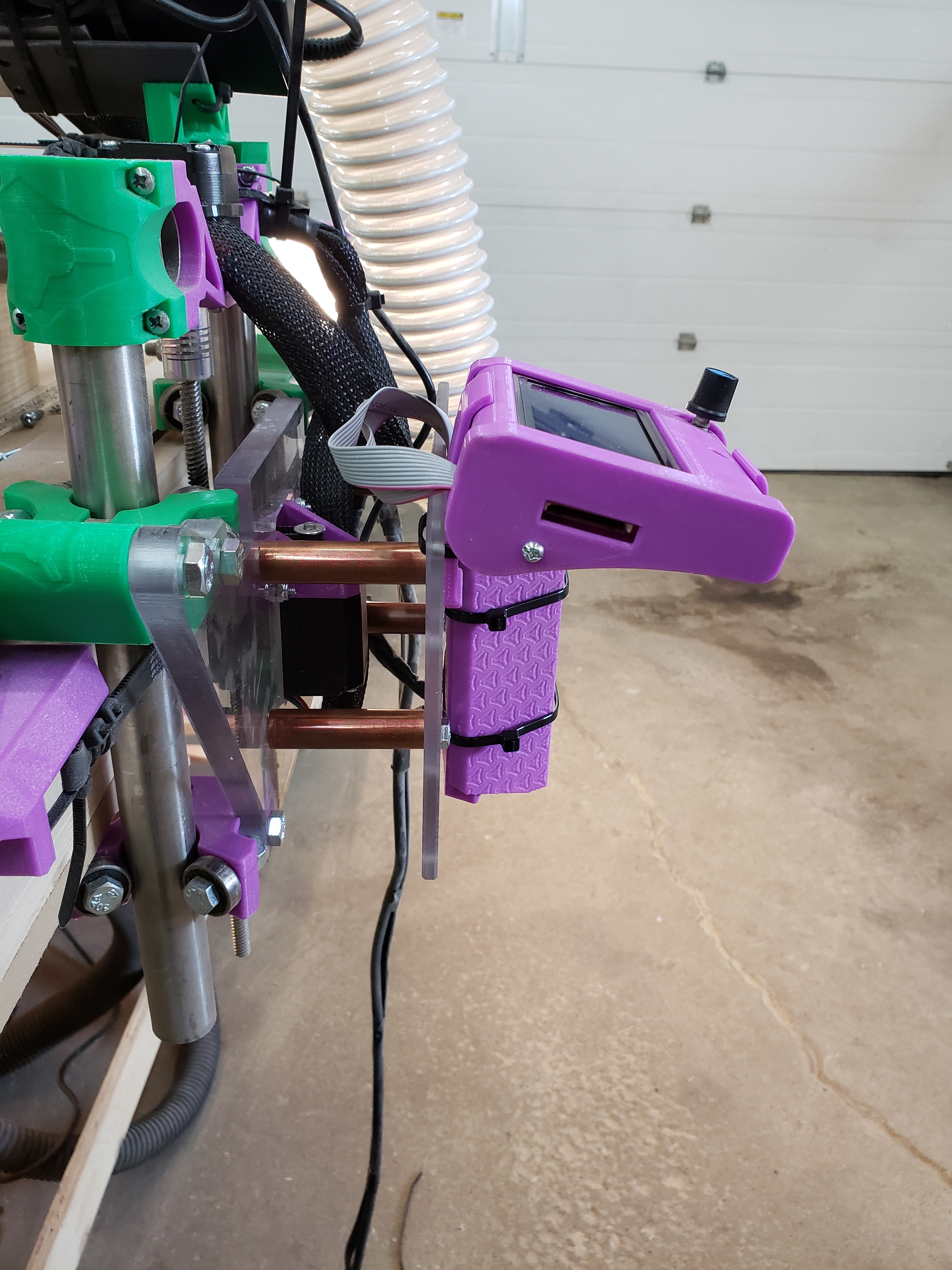

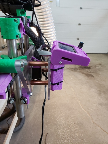

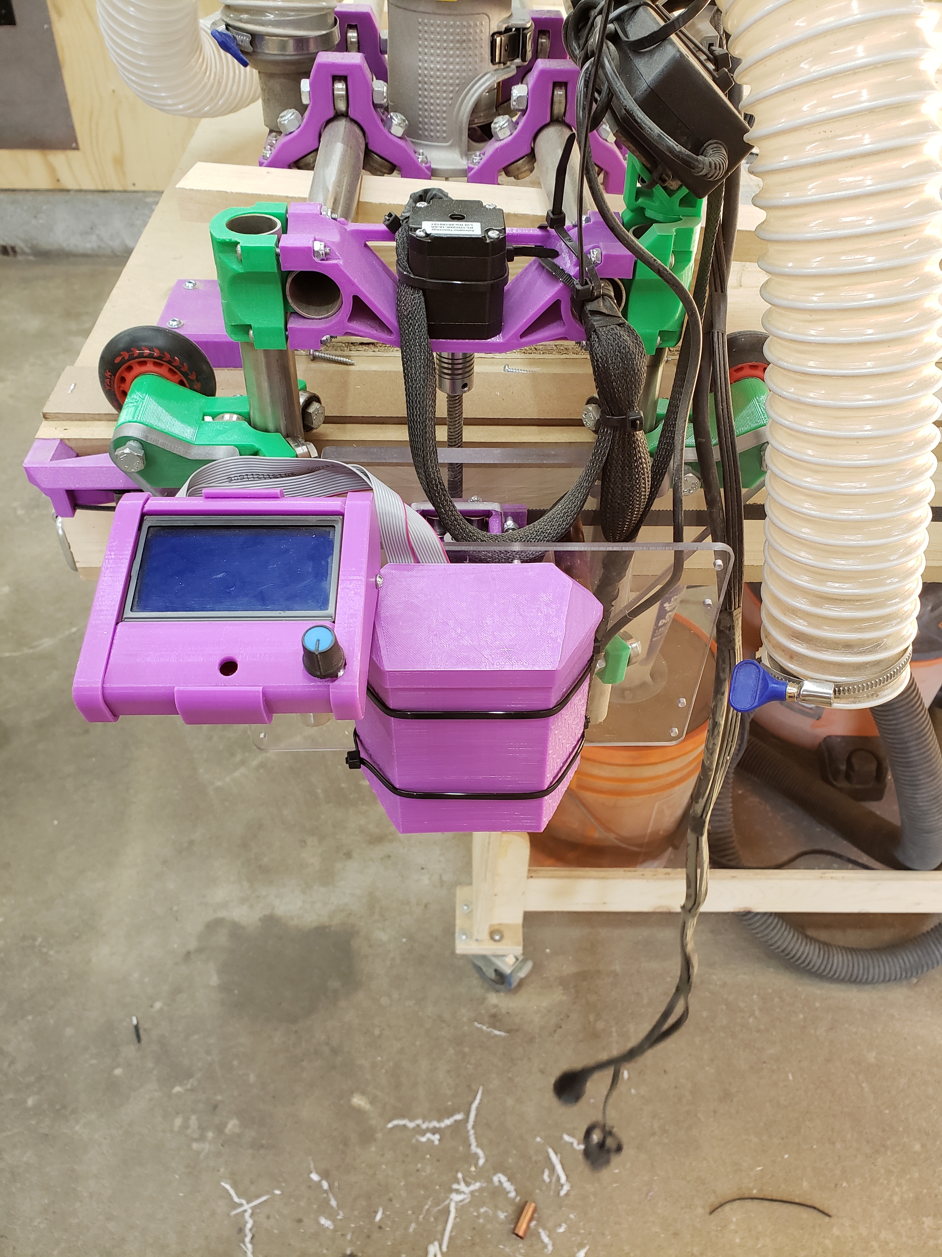

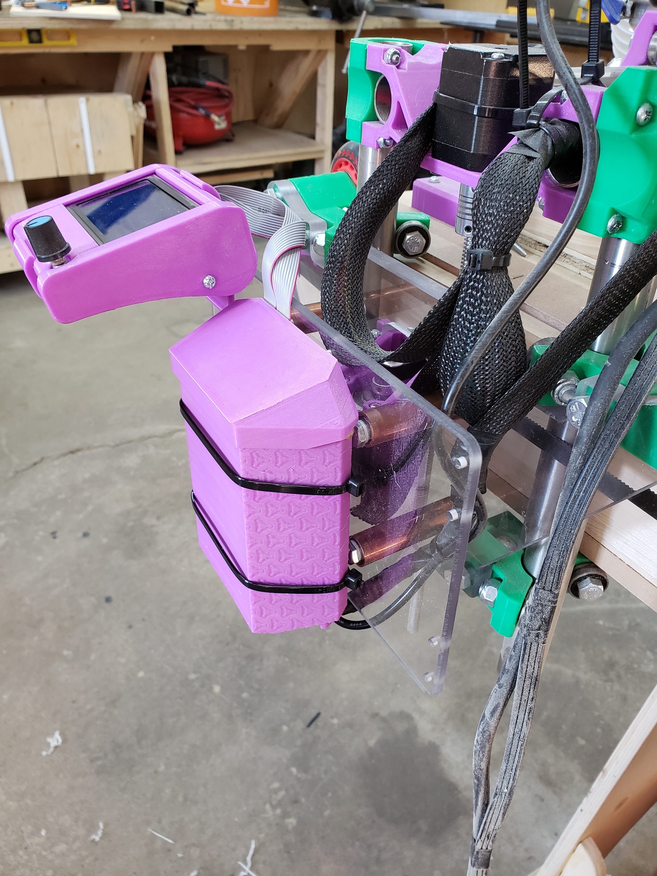

I agree Jeff and thanks Greg, having a second crack at the table is allowing me to refine some parts like the hold downs, and I was never completely happy with how I did the wiring or the lcd/mini rambo mount. The size should be good too, with the exception of just a couple of things nearly everything I’ve cut so far on the cnc would have fit within this cutting area.
I like how small metal legs can be. I have so many wood tables around. I need to use some more metal in the shop. Nice table for sure!
