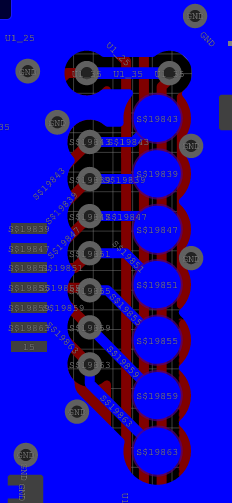

I don’t see any major issues that would prevent ordering.

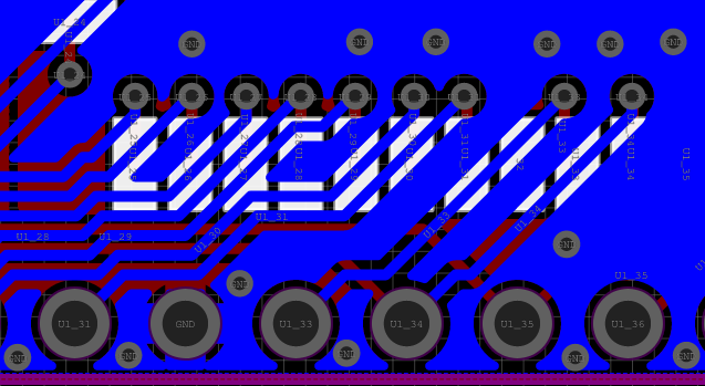

The bottom side plane is starting to get pretty thoroughly sliced and diced, so for future revisions/work, I’d try to focus on keeping that a little cleaner.
Is there any particular reason you’re routing at 0.254mm? 0.2mm should be well within capabilities and is my ‘standard’ routing size. Typically I’d route with 0.2mm trace width, 0.2mm clearance, 0.25mm plane clearance. If the board fab’s capabilities go lower, I’d consider dropping that further even for things like the links from the pin headers to the ESP32 as there are so many in parallel.
Things like this here:
That’s basically a slot under the USB traces which will disrupt the return paths. There’s a via there that creates a pretty reasonable bridge over it, but it’s better to not need to rely on that. This signal is DC, so it’s extremely insensitive to routing. An easy fix could be moving it left by ~5mm so that it’s under the USB connector. You can also easily hop back to the top side to shorten the slotting which won’t matter because of the DC trace:
This is a pretty major slot that also has traces on the top side following it so there will be current crowding around the top and bottom sides of that slot. I’d try to move them apart a little to allow a sliver of ground plane through somewhere near the center, at least.
This kinda thing:
Looking at how this ground pin connects, I’d also try to get as much of these traces onto the top layer as possible and widen this segment, perhaps by bringing the vias across to the left a bit. Mostly this just looks like you’re somewhat restricted to by re-creating the devkit layout, which is already kinda questionable in a few spots. I don’t think this will matter particularly in practice, though as none of the signals off the headers are ‘that’ high frequency and there are other grounds.

I can make a bit of space. UI34-35 really make things a pain here. They were on the bottom so all that was on the top. I flipped them so the voltage regulator would get more heat dissipation from the last review.
I think it does connect to a large return on the top? I will double check this evening.
It does, but just by a slightly weird route. The goal is to try have all the ground connections share the lowest inductance path possible between them so that they can all be considered the same voltage, regardless of the frequency of the signal. It’s a little harder to consider in this case as this is a board that’s going on another board, so it all gets a bit strange and can’t necessarily just be considered in isolation, but I don’t think any of this is actually critical, it’s more just ‘clean up’ kinda stuff. The board will be fine if submitted as is, as best as I can tell.
