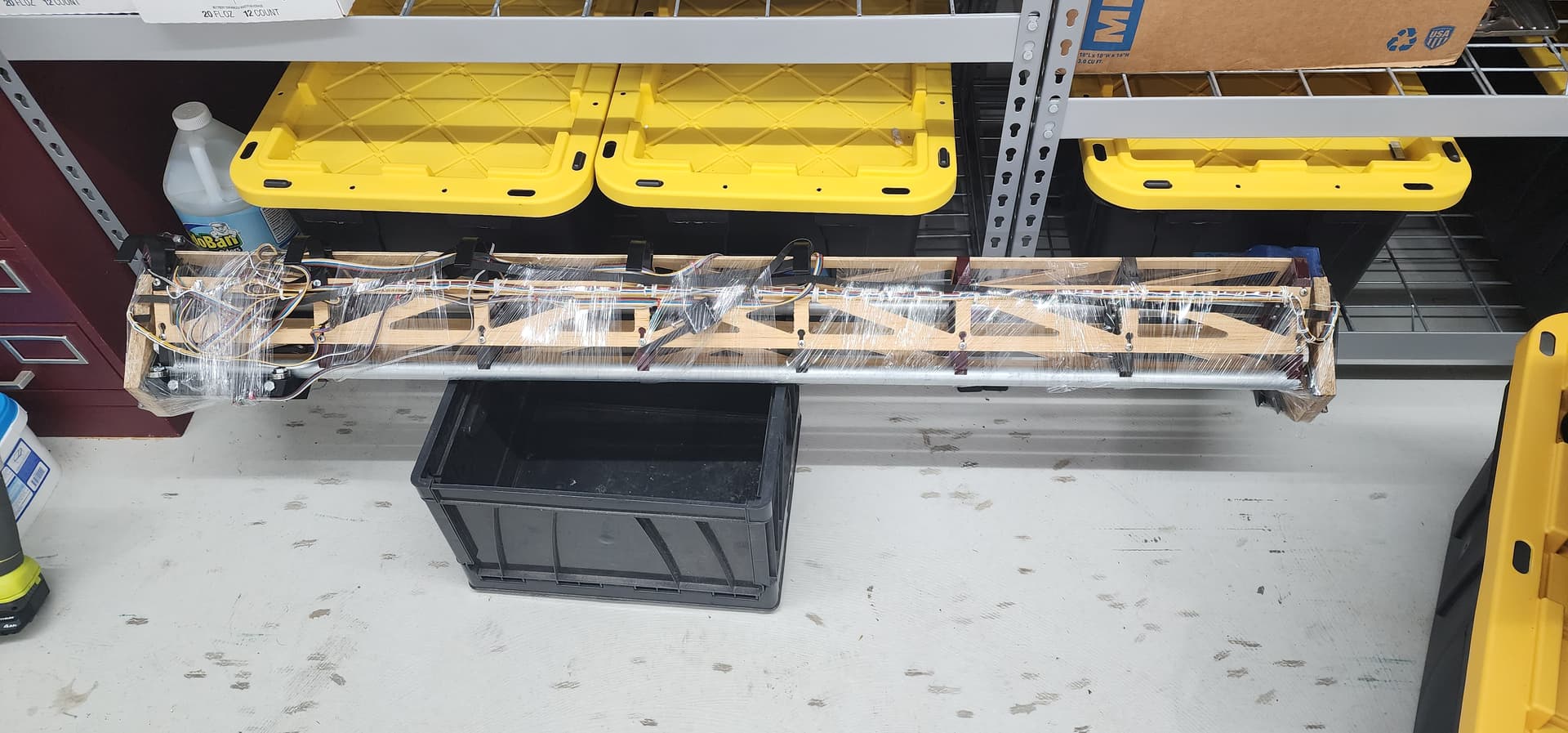

The beam contains a power box with an outlet for disconnecting the router. If I were to do that again I (and I may yet do this) I would make the router disconnectable near the machine rather than at the “other end” of the cable, so that disconnect does not mean removing the vac hose.
Here’s the business end of what I’m talking about.
Here’s mine at the moment.

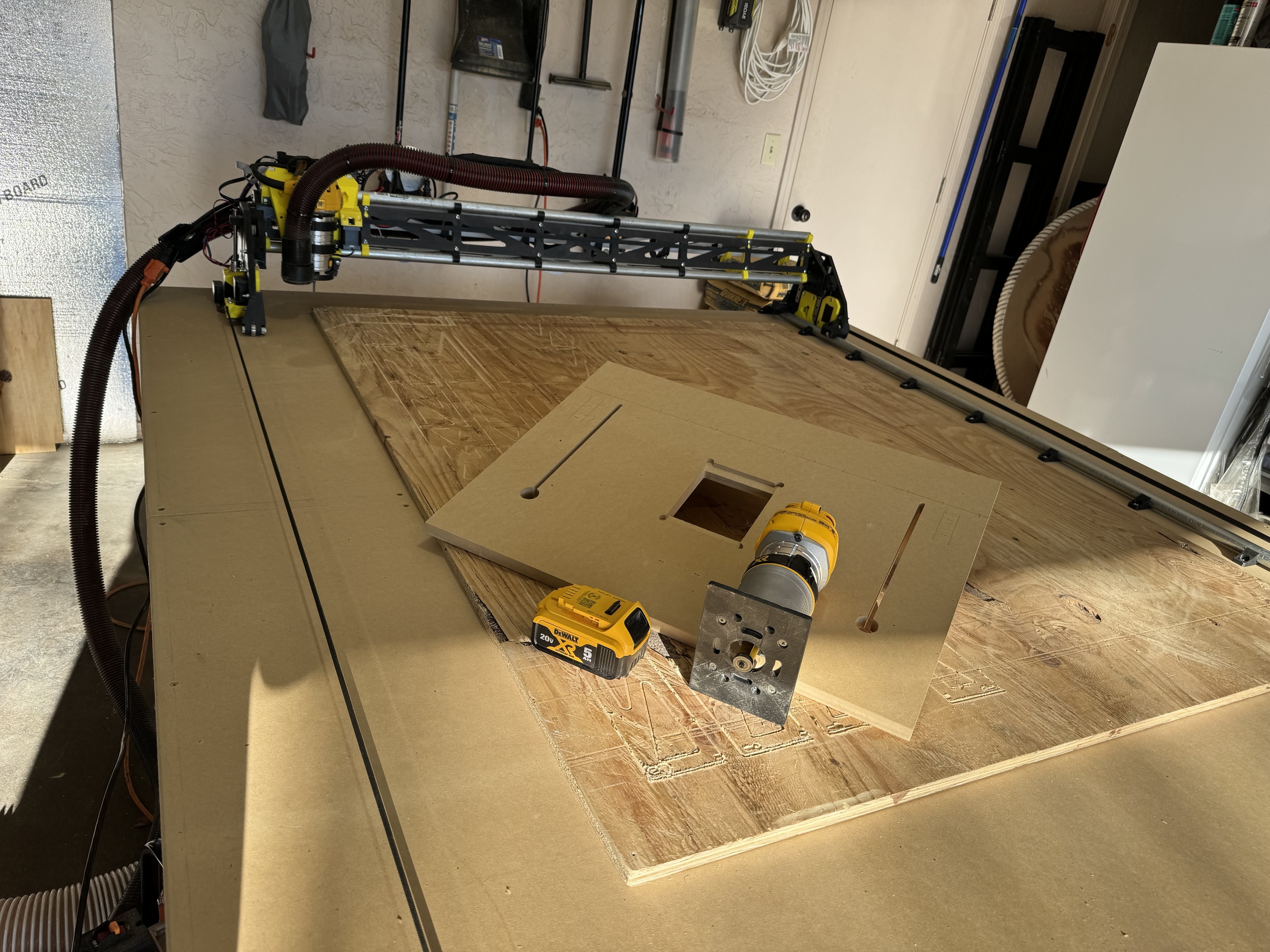

Mine goes a little like this… takes about 25 min to set-up or break-down. As a heads up, my table is a 3 part screw-together top that sits on top of a set of Bora Centipede 4x8 foot legs to make a 6x10 foot surface so it can be stacked up to allow the car to park back in the garage. While this likely isn’t the most calibrated surface to use for CNC purposes, I built mine this way to allow me to do all of this alone, if necessary. When I get a bigger shop space, I’ll cut a permanent torsion box using my current setup.
LowRider v3 Set-Up/Break-Down Procedures
Set-Up
  1. Expand 4x8 Bora Centipede table base fully
  2. Place table sections onto the base in order (marked 1, 2, 3) with first section closest to back wall. Middle section will only balance on a single line of posts, so place this one carefully.
  3. Place 4 star knob screws with washers in holes underneath table sections to connect sections 1&2 and 2&3 together on either side and tighten to form a single 6x10 table top. (You can use a Philips #3 Bit in the impact drill and a driver adapter (Looks like a Pan Head Screw with two nuts on it) to assist with this procedure)
  4. Retrieve linear rail (8 foot 3/4" EM conduit pipe) and fasten to table with screw holes facing inward using 16 - 3/4" 1/4-20 pan head screws (Philips #3 Bit)
  5. Place CNC body on table top at foot of table and roll to the head (that way you don’t have to spin it around awkwardly)
  6. Remove geared belt from velcro strap on one side and connect short end to the belt mount at the head of the table. Carefully unspool the long end and ensure that the belt is not twisted. Then place into the tensioner mount at the foot of the table and tighten 10 half turns using a Philips #2 screwdriver. Repeat with opposite side.
  7. Plug in the power to an extension cord run to the midpoint of the table on the left side (facing the head) of the table and turn on the power.
  8. Connect the dust collector vacuum port to the CNC vacuum hose and the power to the CNC power controller using one of the “normally OFF” receptacles.
  9. Use the CNC controls to raise the Z-axis of the CNC up to 40 mm (Maximum height is 80mm) above the table.
  10. Slide the wasteboard under the CNC and fasten to table using 4 1-in 1/4-20 pan head screws (Philips #3 Bit)
Break-Down
  1. Use the CNC controls to raise the CNC Z-axis up to 40mm (Maximum height is 80mm) above the table and lower the Y-axis to the head of the table.
  2. Unscrew 4 - 1" 1/4-20 pan head screws with Philips #3 bit and place in plastic snap box. Remove wasteboard and place upright along back wall.
  3. Remove the dust collector vacuum port from the CNC vacuum hose and the power from the CNC power controller and store.
  4. Loosen the tension screw 10 half turns using a Philips #2 screwdriver. Remove geared belt from tensioner mount from table floor and roll up towards the table head. Remove geared belt from belt mount and pull tensioner side until mount rests against motor housing. Loop velcro strap over Z-axis lead screw and insert coiled belt into strap to retain. Repeat with opposite side.
  5. Unplug extension cord, coil and store.
  6. Roll CNC body to foot of table and lift and place in storage housing on top of the wide toolbox on the small rail.
  7. Unscrew 16 - 3/4" 1/4-20 pan head screws with Philips #3 bit and store in plastic snap box. Move linear rail to top shelf storage, handle with care as rail mounting blocks are prone to breakage.
  8. Remove 4 - star knob screws from beneath the table top and store in plastic snap box.
  9. Remove the three table sections and store against the back wall with the plastic mounts protected by neighboring sections.
  10. Collapse the Bra Centipede table and store at back wall.

Ok, I would say yes to this, with the caveat that it may not handle anything overly heavy duty, which shouldn’t apply to the LR3, in general. I’m using it right now to cut a trim router table and it’s running great on 1.5mm passes at a 1500 mm/min feed rate with my 1/4” end mill.
I would agree that the Bora Centipede table is far more stable in the vertical direction than the horizontal, but while the CNC does exhibit some horizontal wiggle, it’s not enough for me to call a negative so far. I could probably jump up and down on top of my CNC table and it wouldn’t move at all, but if I walk into it on accident the whole table is going to shake. What would that do to an active CNC work piece? Not too sure at the moment, but my guess is not much since everything is attached to the top of the table by the rail and belts.
I would say it is stable continuously and I don’t see any drawbacks at the moment except for my 3-pc table maintaining perfect flatness after multiple set-up and break-down cycles, which isn’t all that important to me, yet…
