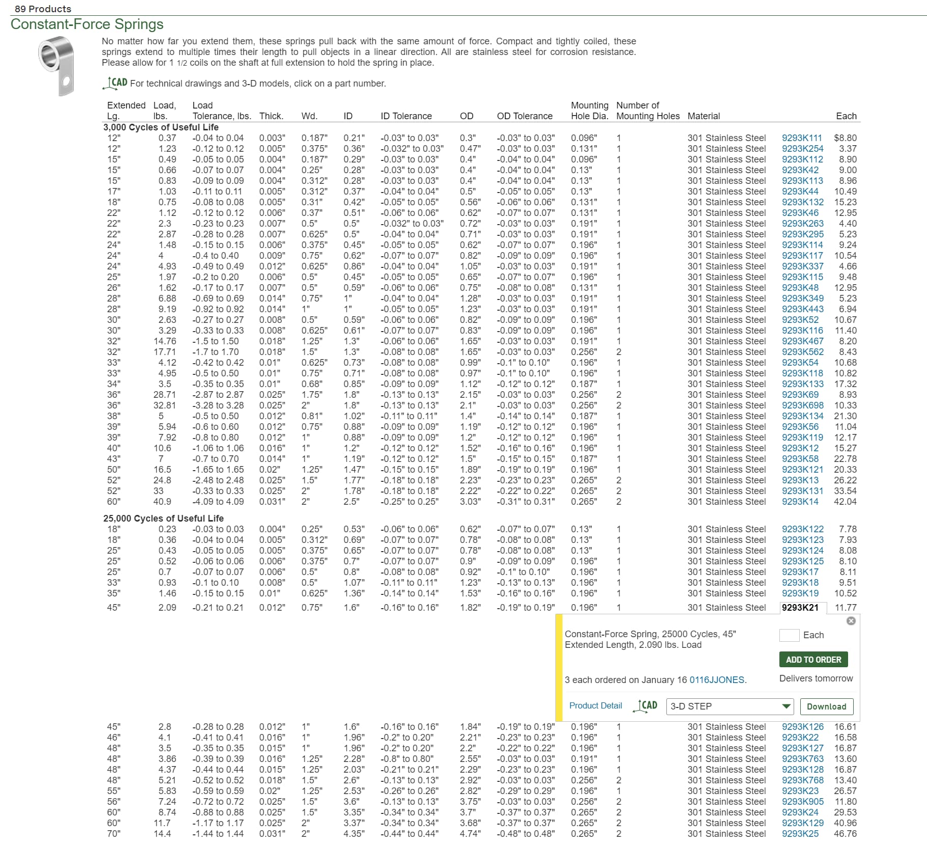

It wont give me a link to the individual part but here is the link to the page and a screen shot of the one I got. I misspoke before. They are 2.09lbs not 2.4.
This was the first thing I have ordered from McMaster Carr before. And I was very impressed. They were ordered at a little after midnight Tuesday morning and arrived here Wednesday afternoon. Better than amazon LOL
Also nice that they have the .step file to download for fusion360 as well

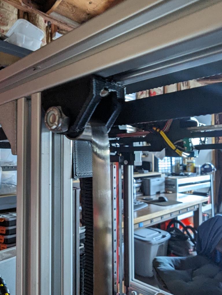

I have installed tension springs and they work great, but I’m not running the printer yet since I didn’t have time to compile Klipper firmware for my Octopus board.
Videos without https://www.youtube.com/shorts/1SWS--e2MTE and with tension springs https://youtube.com/shorts/zRqqBFRCHQc.

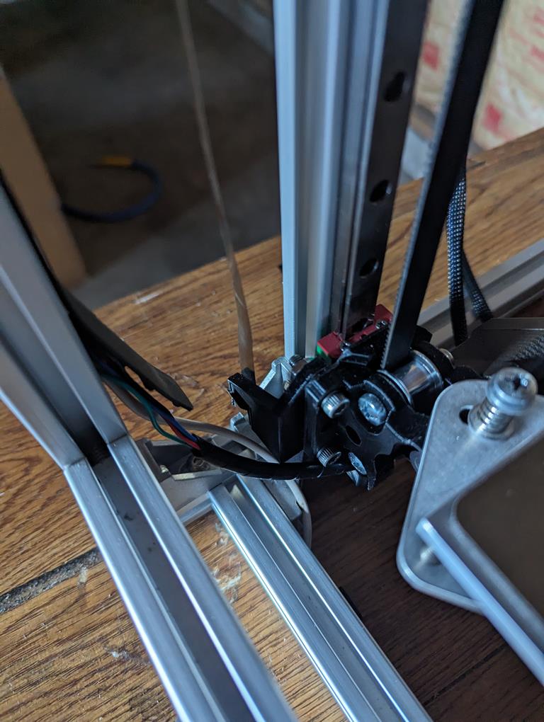

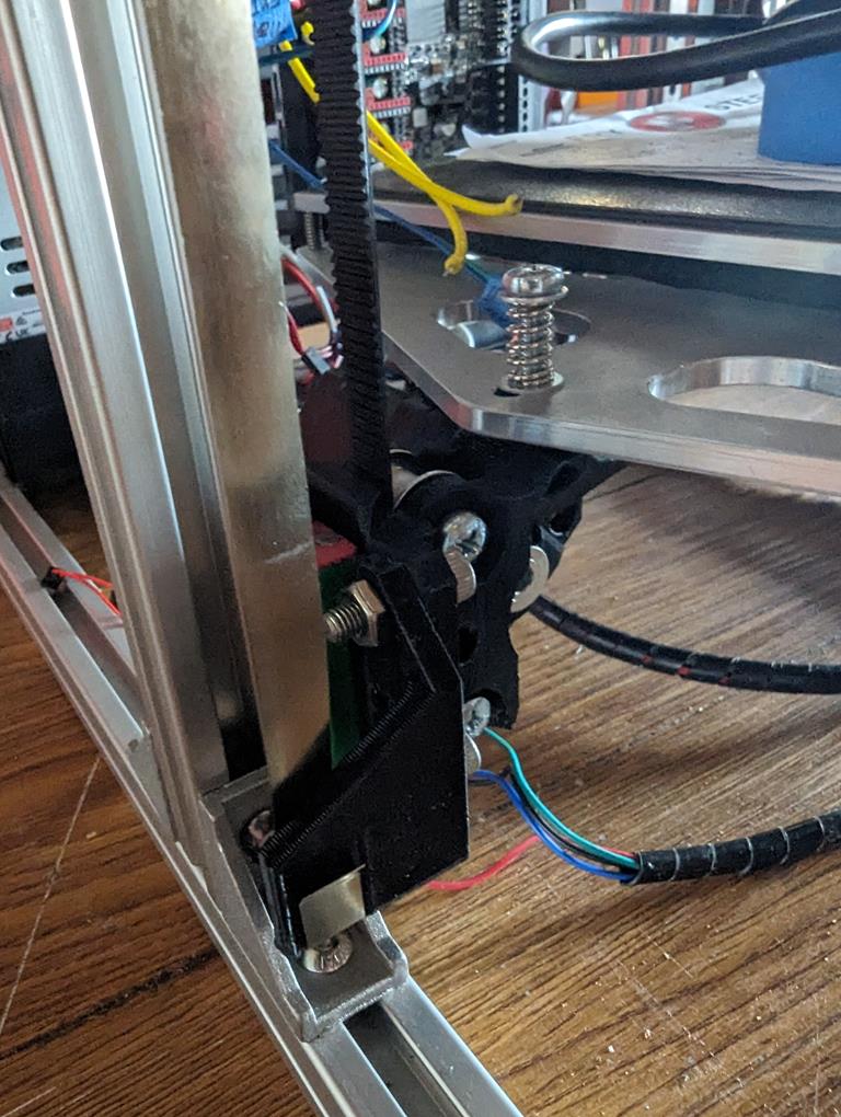

My bed assembly is 7.5lbs and I’ve used 3x 1.25lbs springs. I’ve modified the Z motor mounts for adding a spring brackets and mounts for 8020 frame. I can provide the files if wanted.
Please! That would be extremely helpful!
I’ve used the springs with a little loop on one end so they can be easily removed.
I wish I would have paid attention to the width more on mine. The ones I got are 19.05mm wide. @azab2c might want to look at that before you place your order.
@pavel569 thank you for the pics! That gives me something to go off of! Major help!!!
This is what I’m using - McMaster-Carr
@pavel569 Thank you for sharing info/photos about your springs and mount setup.
