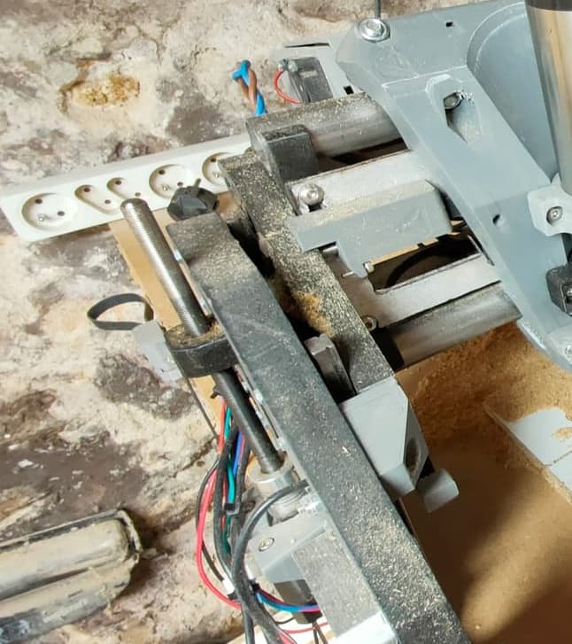

The router on my LR3 just stopped working properly
I ordered a replacement, but I’d like to troubleshoot what’s wrong with this one, and maybe save it from the dump…

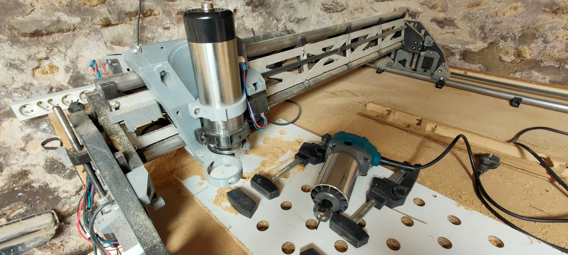

I’m using a Katsu router (makita clone), that has served as a palm router for 3-4 years, and as a spindle on the LR3 for the past couple month
It had been cutting for 30min, finished the file, and I just started a new one, when the router began to stutter and fluctuate in speed, as if it was slowly pulsating…
I turned it off and stopped the job before it ruined the workpiece
I tried starting it again, but then it just wouldn’t start at all, no spin…

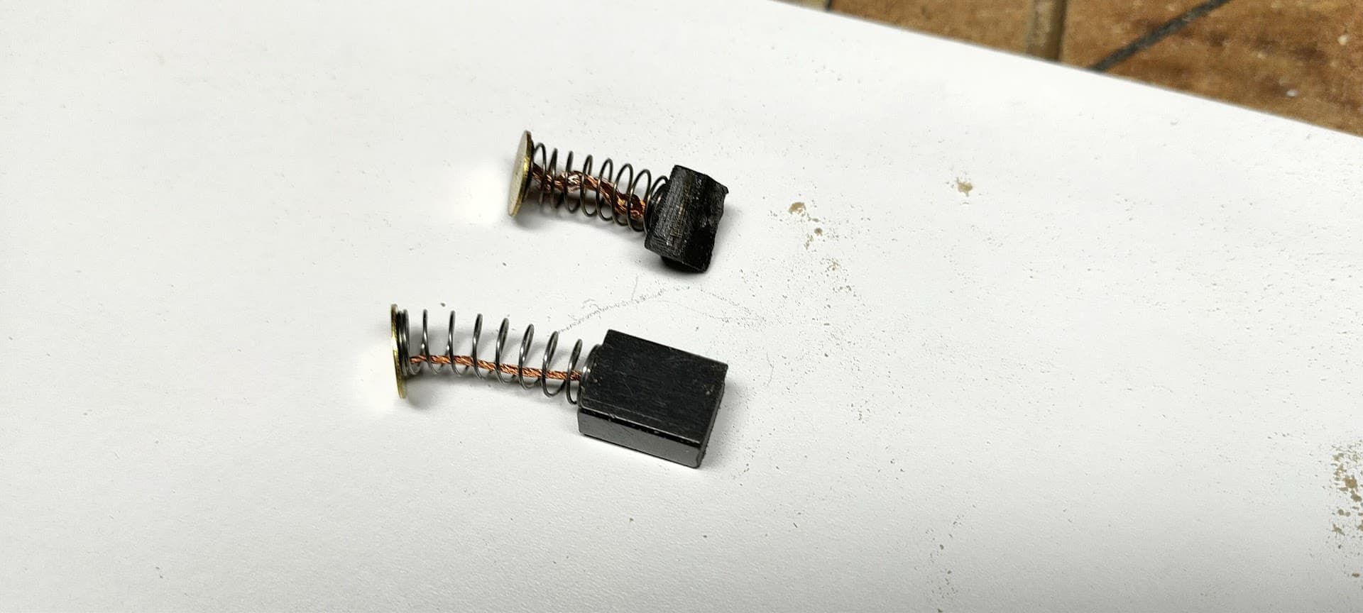

Looking at the brushes, I think I might have a potential culprit here
Top: Motor brush out of the router/ Bottom: New motor brush
So that’s pretty easy right?
Changing the brushes should do the trick… except it doesn’t :confused:

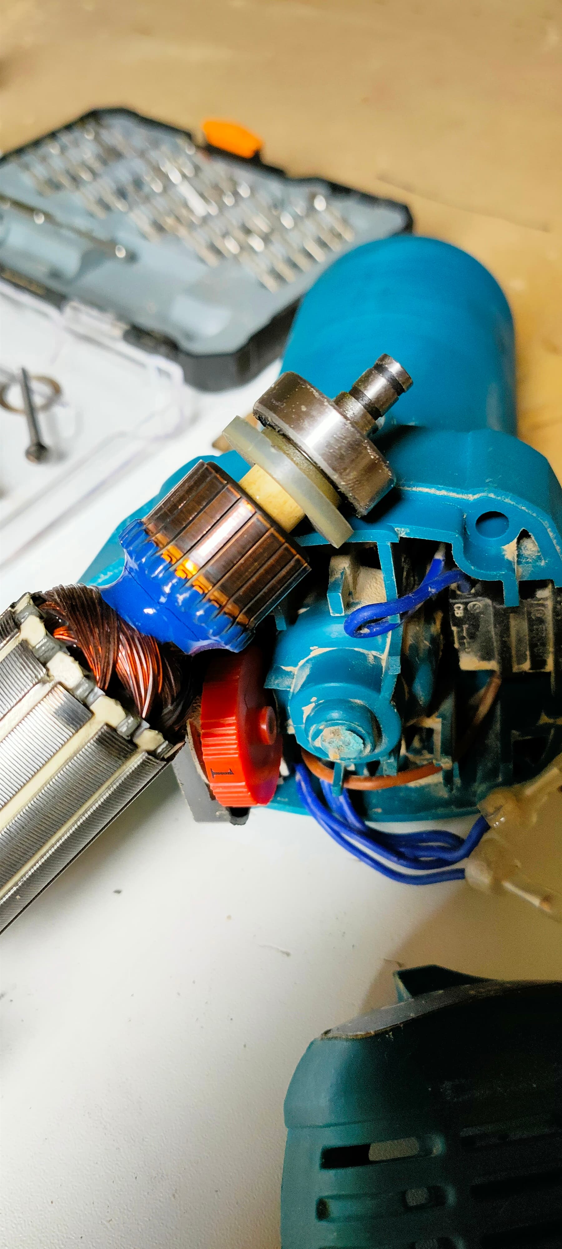

After changing both brushes, I’m still getting this speed fluctuation, plus the router now produces a lot of sparks I can see under the casing …

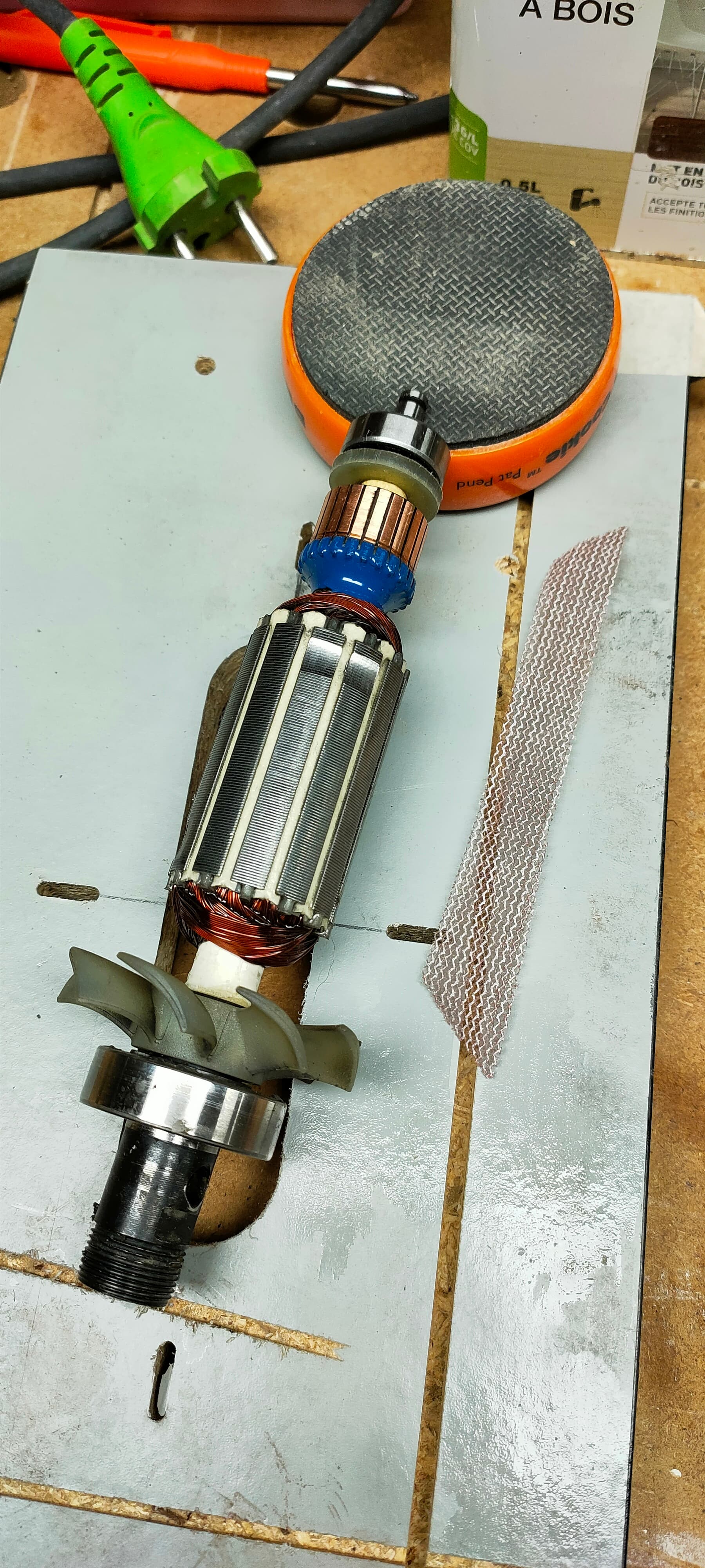

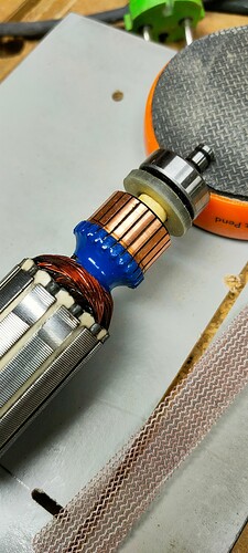

I dismantled it and the collector doesn’t seem too filthy, maybe I can still try to clean it, but I don’t know what’s the appropriate compound/method?

Don’t worry about the extra sparks, they’ll calm down once the surface of the brush has worn to better match the curve of the commutator.

I tried cleaning the collector with IPA and a light sanding with the drill as a make-up lathe, but it’s still pulsating and loosing power
Is it just a matter if “burning in” the brushes?

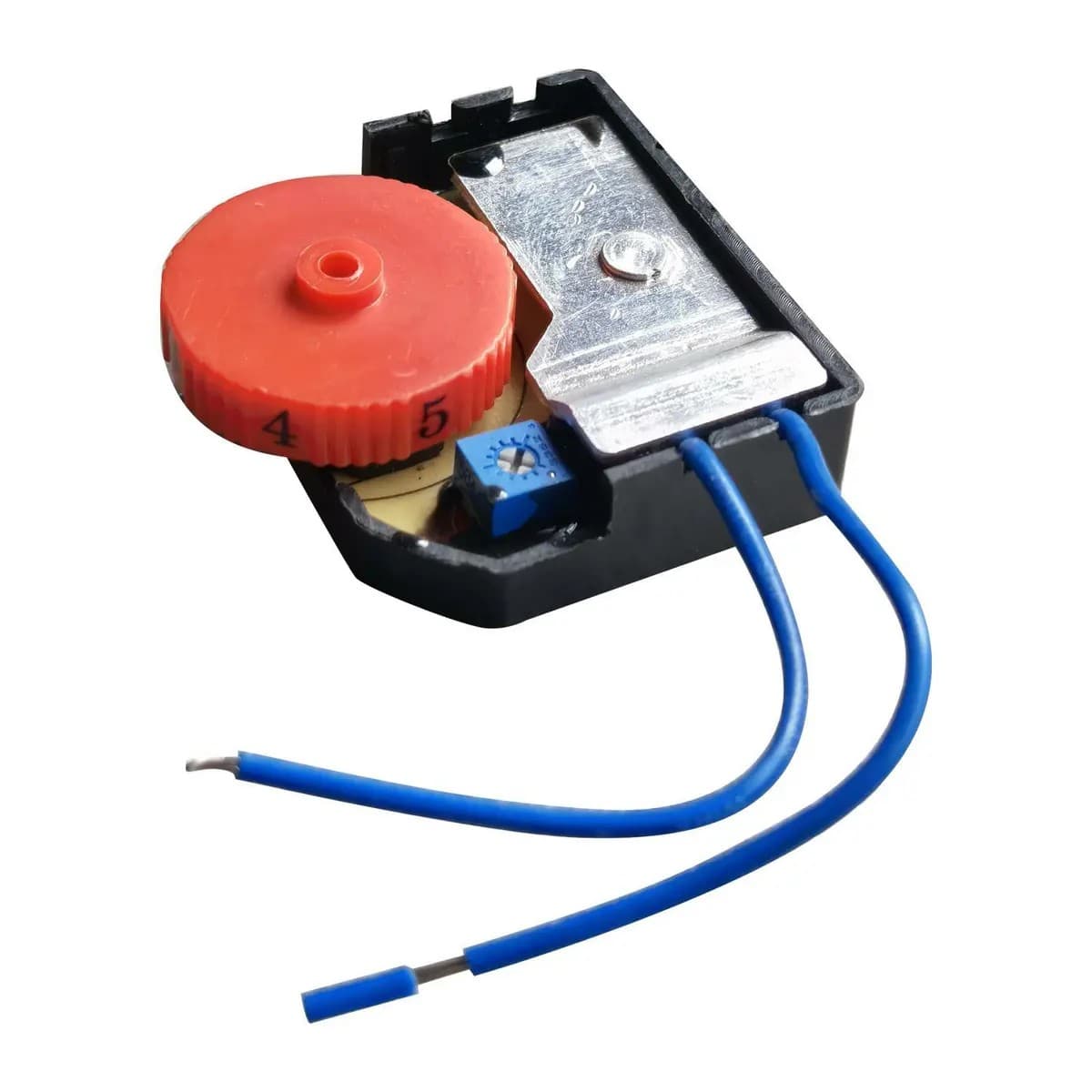

I bet the issue is carbon tracking in your speed thumb wheel.
I use acf50 for all my electronics and have had great success.
Have a look at the wiper and the contractor on the thumb wheel. And clean it up with iso.
A pencil eraser is also a great quick way to clean up contacts etc.
the bits of carbon that your brushes have shed also might be inside as well.
I just did mine a while ago. Sprayed with iso a lot brushed up and then acf50 if and wipe the residual.

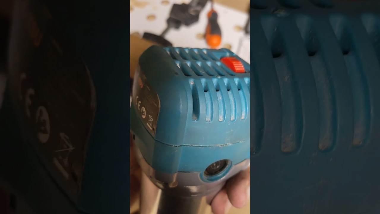

Judging by online videos It may be the speed dial indeed
But on the Katsu it seems sealed tight, don’t know if I Can reach inside this

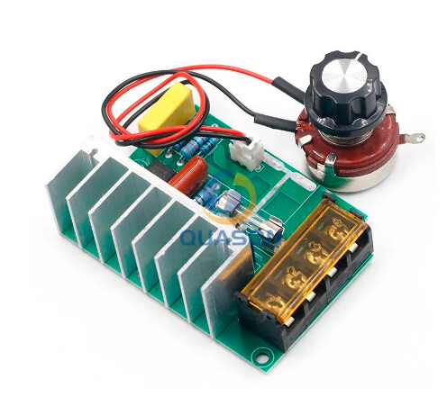

I bought a separate 0-220v regulator on Ali, but it won’t be there before the end if september

If it’s sealed then not too much you can do but if you can get some of that cleaner inside. Move the switch a whole bunch of times as it might clean the surfaces. Sometimes they can’t be brought back as the copper contacts might be made of thing material and could have lost its contact tension over time or worn a flat spot.

I think I’ll just wait for the new spindle and just keep this one as a handheld trim router
And I surely and definitely didn’t wait for it to die so that I coud buy a brushless spindle, never even thought about such a scenario :wink:
Waiting for the VFD now
What pitch is that leadscrew on the Z axis?
1mm pitch leadscrew
It’s slow but it provides lot of torque + the gantry never ever falls down when there’s no power

I bought a small external 220V variable regulator off ali… We’ll see if I can revive the router with it…
