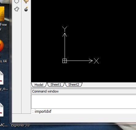

To make it a little easier for anyone wanting to open a DXF in Draftsight here’s a screen shot.
Your screen may look a little different, this is the “classical view”.
After typing the phrase “importdxf” (one word with out spaces or quotes) press enter (Return) and navigate to the DXF file.
I would have to test it out but I think it opens in the measuring system it was drawn in (metric imperial)
