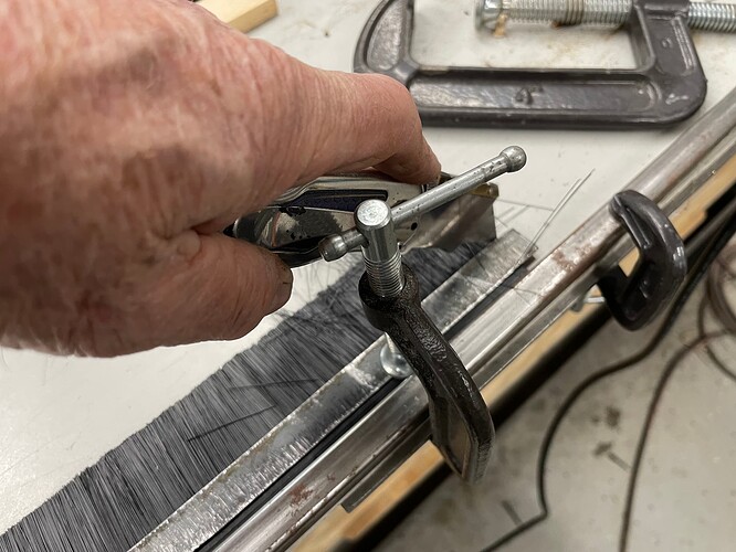

I needed to add dust collection to my Primo MPCNC. Found one I liked on Thingiverse but it was for an earlier version so I did a remix. It attaches to the Core by using two longer bolts and spacers to avoid interference. It uses a bristle brush from McMaster Carr, cheap and very effective. Their part #1469N14, only $2.02 for 3ft. The one I had was leftover from a previous project and had 2" bristles so I cut them down. It fit in the shoe nicely with no adhesive.

It does a great job of gathering the chips.
The files are on Thingiverse, #6810169
