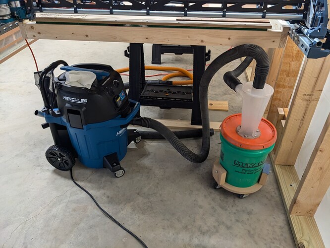

I ended up purchasing a Hercules Dust Extractor from Harbor Freight and hooking it up to a Dust Deputy. I have Doug’s floating dust shoe for my LR3 and I was cutting 1/2" MDF last night and it worked much better than I expected. I couldn’t visibly see any dust on the material, though I could feel a little bit on the work piece. I’m sure I’m losing a little suction with the Dust Deputy, but it’s much easier and cheaper to empty that than the dust extractor bags.
