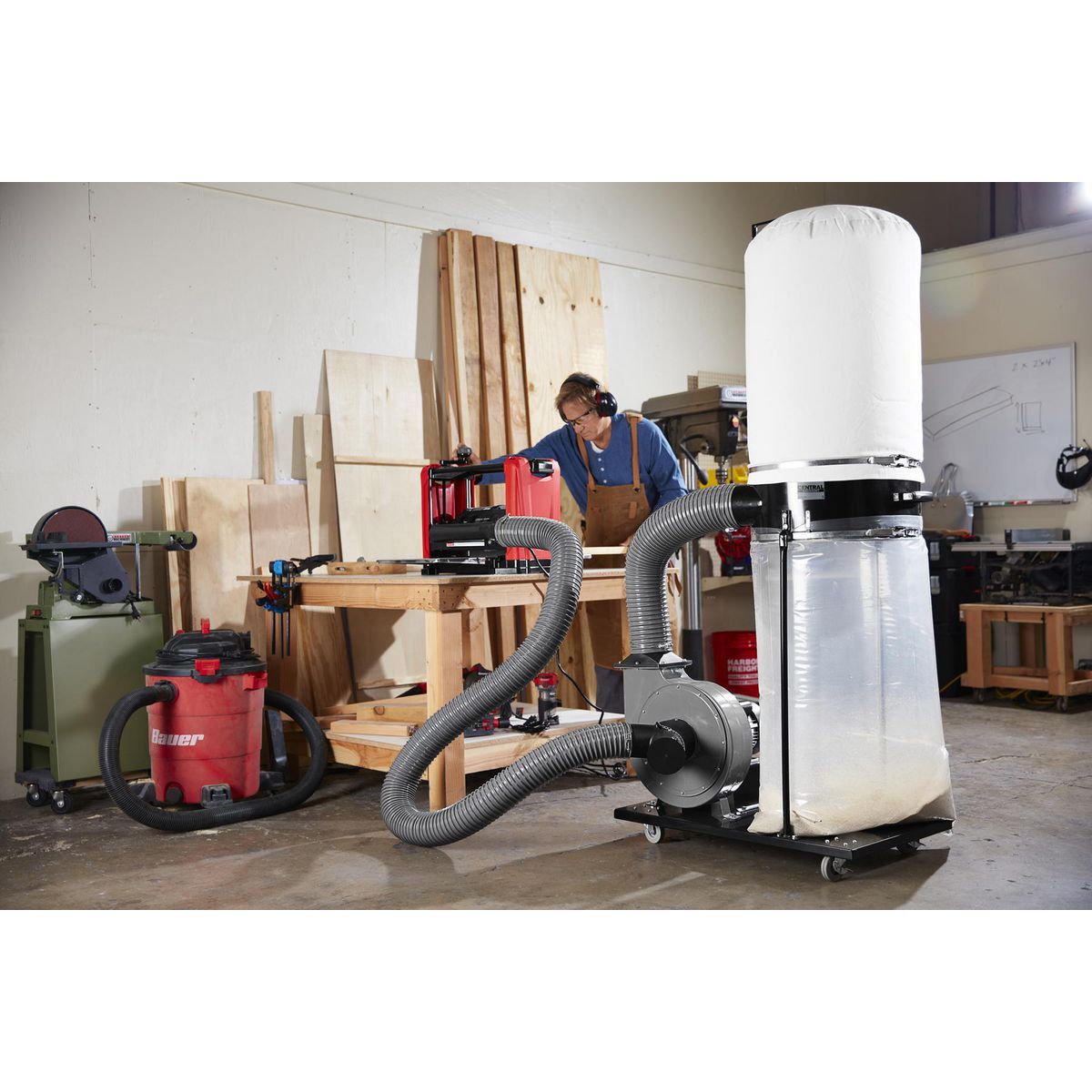

Just came across this on youtube. i know many have had posts on dust collection diy. This is confusimg to me as it is pushing and not sucking the dust/chips! They only show the use of the seperator, not the collection device!!
if you watch the video he referenced you can see it better. And it is sucking. blowing would be almost imposible

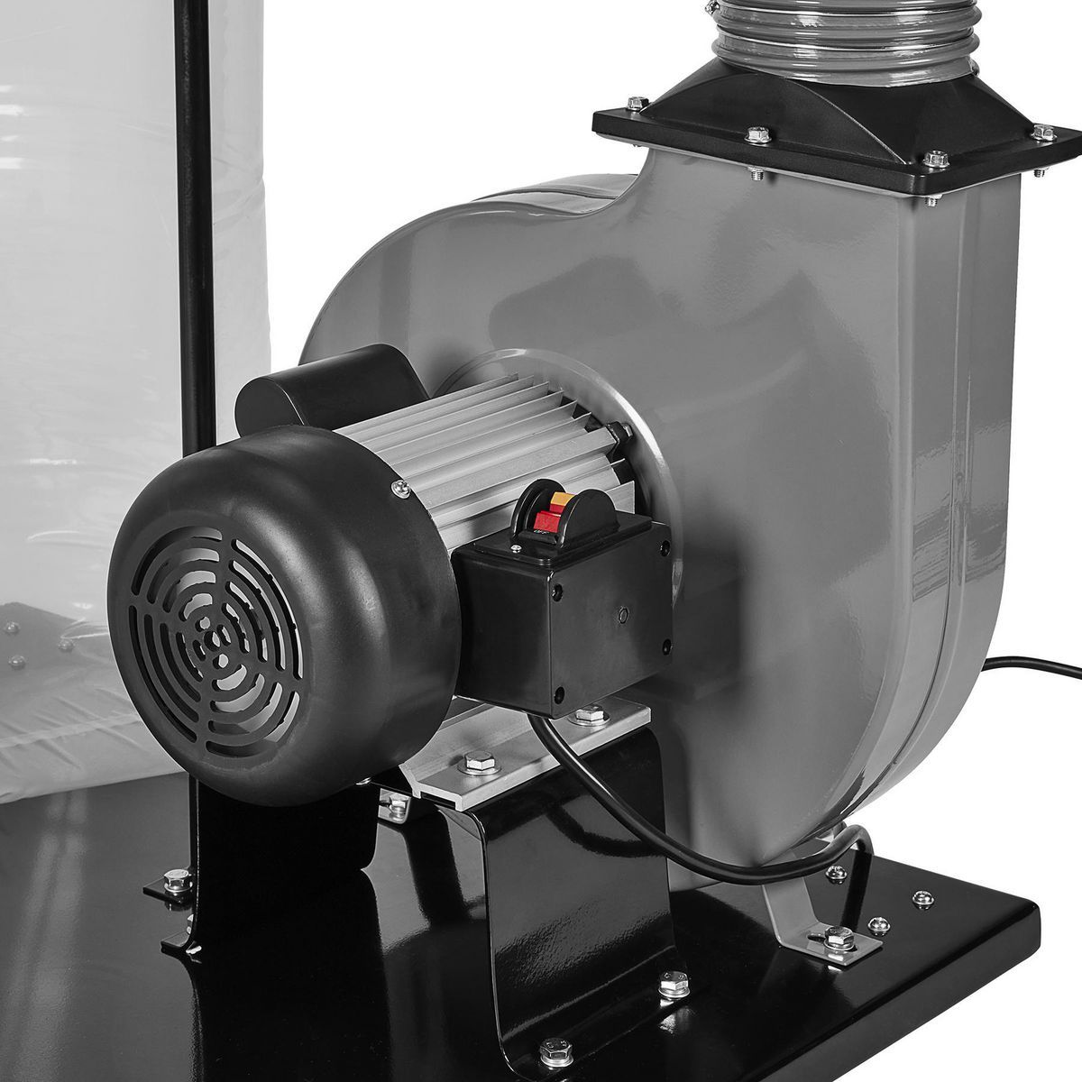

first your blow theory is because he has it on the exhaust side of his dust collector. That only works with the big dust extraction blowers not a shop vac. This is his workflow set up:
work being done —> hoses and piping → blower fan from dust collector → his separators then filter
I would first change that lay out all together. ESPECIALLY since I work with metal. There is a theory that metal pieces can hit the blower fan and cause a spark or damage to the fan. You can end up with hot metal in a pile of saw dust that can catch fire, orrrrr saw dust suspended in air can cause an explosion of sorts from the rapid burn rate. so first change to his set up would be this work flow
work being done —> hoses and piping → his separators → blower fan from dust collector → exhaust
at this point you could in theory use a shop vac to power the system but I think the static pressure of a vac system would cause more of the particles to get through the system and even possibly suck stuff from the collection buckets. So I would still say you need a dust extraction system similar to this.

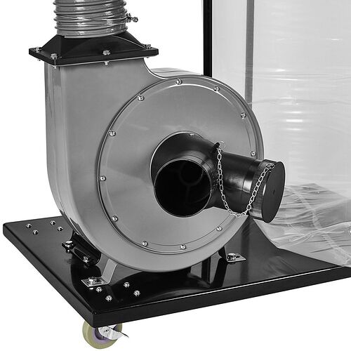

With that thing he made between the planer he is using and the blower housing (which is set up wrong to start with but thats later) he should be getting MUCH less exhausted into the bags.
Why these companies all make huge number claims and then instantly reduce the performance is beyond me. So lets fix that first.
That motor has a 6" inlet. and right at the strongest section the break out into to 4" inlets. Volume is everything in these systems.
6" volume 339.3"
4" volume 150.8… even with two 4" 301.6
stop doing this. Run 6" as far as you can. In his example he use 4" inlets and 6" tubes. And that’s why he lost volumetric efficiency vs Harvey. He lost volume.

lastly, I would make the exit from that device more tangent to the tube. If you look at this picture of the dust collector, the air is pushed out TANGENT to the blades not straight up.
